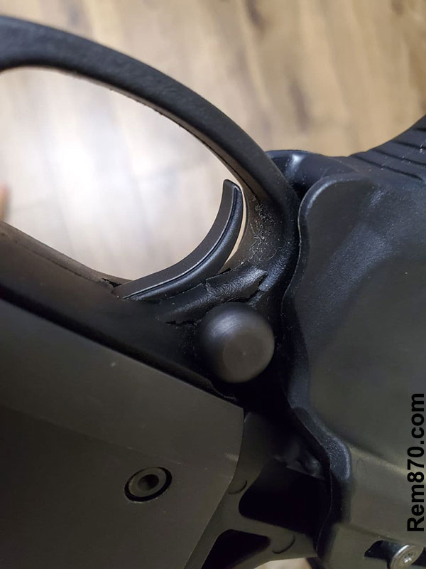

Use of Oversized Safeties and additional accessories on Remington 870 with Knoxx Stock
Manufacturer of the SpecOps stock does not recommend using any of the oversized safety buttons. This is because big safety buttons stick up and when shotgun moves rearward the button will hit the stock and damage it and even may cause injury.
Here’s what happens when you try using Blackhawk Specops stock with oversized safety:
Also, you need to make sure that sidesaddle will not interfere with the stock movement.
Spacer Between Receiver and Stock on Remington 870
Some people don’t read installation instructions carefully or just forget to remove the metal spacer which is needed for the factory stock. Remember that you need to remove it installing the Knoxx SpecOps stock or otherwise you will have a gap between stock and receiver.
