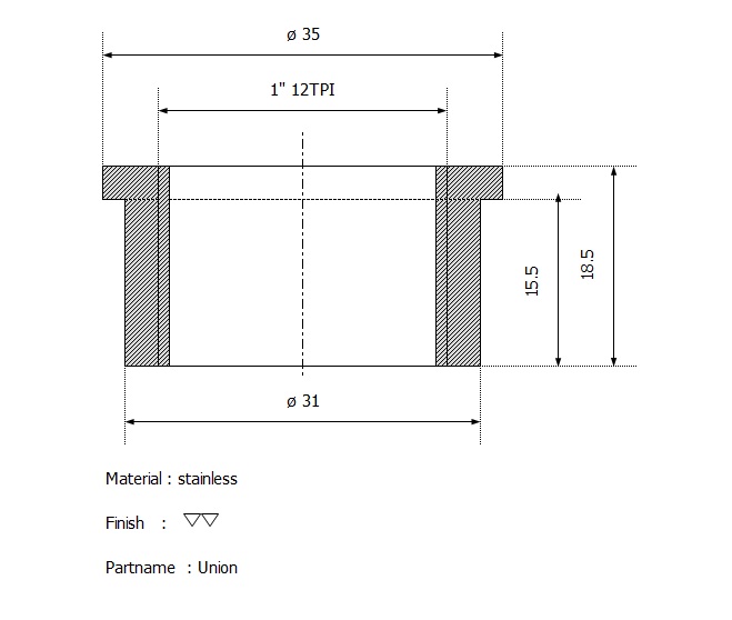

Make Your Own Remington 870 Extension, Scheme
Remington 870 hand made extension from Nat_usp from Remington 870 Forum:
