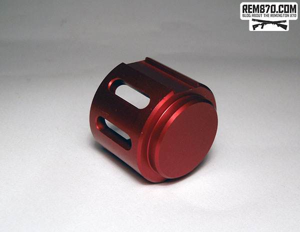

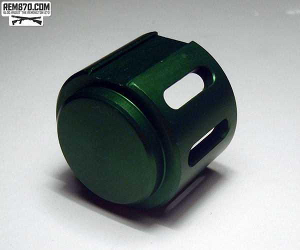

Brownells Aluminum Follower Recommended
Brownells Orange Aluminum Follower
Here are other followers from Brownells but now they are made of aluminum and have a bright green, orange and red colors.
They are very good followers! They are lightweight and bright. I like the green, orange and red colors because they are higly visible and you can easily see that shotgun is unloaded.
Brownells followers are good and you can choose whether you want heavy stainless steel follower or lightweigh bright aluminum one. Followers are available in different colors.
Get Brownells Aluminum Magazine Follower on Brownells |
