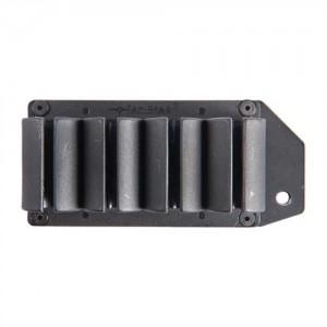

Remington 870 Express 20 Gauge TacStar Side Saddle
If you are looking for a more inexpensive sidesaddle shell carrier then try the TacStar 6-Round Sidesaddle for the Remington 870. This particular one comes in two pieces; a nylon plastic shell holder and an aluminum sidesaddle mounting plate for the receiver. The shell holder mounts onto the plate using two big Allen screws. Make sure you tighten these screws when you put them in because they are known for getting loose very easily in this sidesaddle. If you are outside in an area with dirt then it will be very hard to locate them if the screws fall down into it.
Get Remington 870 Express 20 Gauge Side Saddle on Brownells

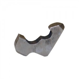

Remington 870 20 Gauge Non-MIM Extractor
Remington 870 shotguns have two types of extractors that you can use in the weapon; MIM extractors and non-MIM extractors. MIM is an acronym that stands for metal injection molding. Many of the new Remington 870 models on the market feature the MIM extractor in it. However, many gun owners do not like the MIM extractor because it is unreliable. The non-MIM extractor is a machined extractor which is known for being more reliable when extracting shells. This is the type of extractor that used to be included with Remington 870 shotguns. Now the only way you can get the non-MIM extractor in your shotgun is by replacing the MIM extractor with it. Fortunately, this is possible to do.
Get Remington 870 Non-MIM Extractor on Brownells

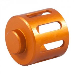

Remington 870 20 Gauge Aluminum Follower
The follower is an important part of the Remington 870’s magazine because it pushes the ammunition rounds from the magazine into the chamber. The follower is a very small piece, but it is important to the functionality of your Remington 870 shotgun. Since this piece can easily break, it is important that you have a quality magazine follower that is durable and reliable when using your weapon. Therefore, this should be a follower made out of metal and not some flimsy plastic or synthetic kind. That way you can get the most years out of it that you can while preserving the lifespan of your weapon.
Magazine Spring Used: Stock OEM REM870, 20-ga.
Rounds used in Testing: Bird Shot and #4 Shot, 2 ¾” Length, standard rounds.
First impressions:
Packaging: The Follower comes in a plastic bag with Instruction Sheet. No additional shock absorbing packaging, (not sure any is needed).
The Follower: It is a nicely machined piece of aluminum, no sharp edges on either the outside or the inside, with an anodized coating that is applied smoothly and has a great appearance.
Fitment: It fits the 20-ga REM870 Mag nicely and slides easily inside the Mag Tube I noticed no binding.
Note: I loaded and ejected 50 rounds, shot 50 rounds and the Brownell’s Follower worked as expected, no binding, no problem loading or racking rounds.
Overview: This is a simple Product designed and manufacturer well and tight tolerances allow it to work as well or better than the original follower. I used the included instructions for disassembly and installation of the follower and they worked well and got me through what I thought would be some difficult disassembly.
There is a color choice, if you need one, Black, Gold, Natural, Red…
Get Remington 870 20 Gauge Aluminum Follower on Brownells

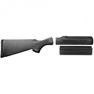

Remington 870 20 Gauge Speedfeed Stock and Forend
There are many stock choices out there when looking to upgrade your standard Remington 870 20 gauge shotgun.
Get Remington 870 20 Gauge Speedfeed Stock and Forend on Brownells
