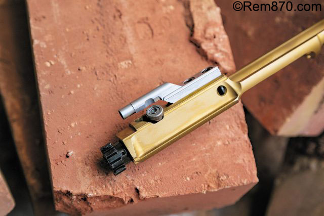

3. Brownells Lightweight Bolt Carrier Group
The Brownells M16 Lightweight Bolt Carrier Group has a lower mass meaning it needs less gas for the AR-15 system to work. Lighter BCG and less amount of gas mean lower recoil. This is a drop-in upgrade which doesn’t require gunsmithing or time.
Lightweight Bolt Carrier Group is machined from 8620 tool steel and has a heavy-duty bolt made using 9310 tool steel. That means that lightweight BCS is still sturdy and reliable.
Available with nickel-boron, titanium-nitride or nitride finishes which mostly mean color. All of them have the same functionality.
Compatible with AR-15s chambered in 5.56 NATO, .223 Rem., 300 Blackout and .204 Ruger
The Brownells M16 Lightweight Bolt Carrier Group ships completely assembled with all of the parts. The true drop-in upgrade which can make your rifle better.
Just remember that lightweight BCG alone won’t make the recoil softer because the system will still have too much gas pressing on it. Get the adjustable gas block to release the potential of the light BCG.
