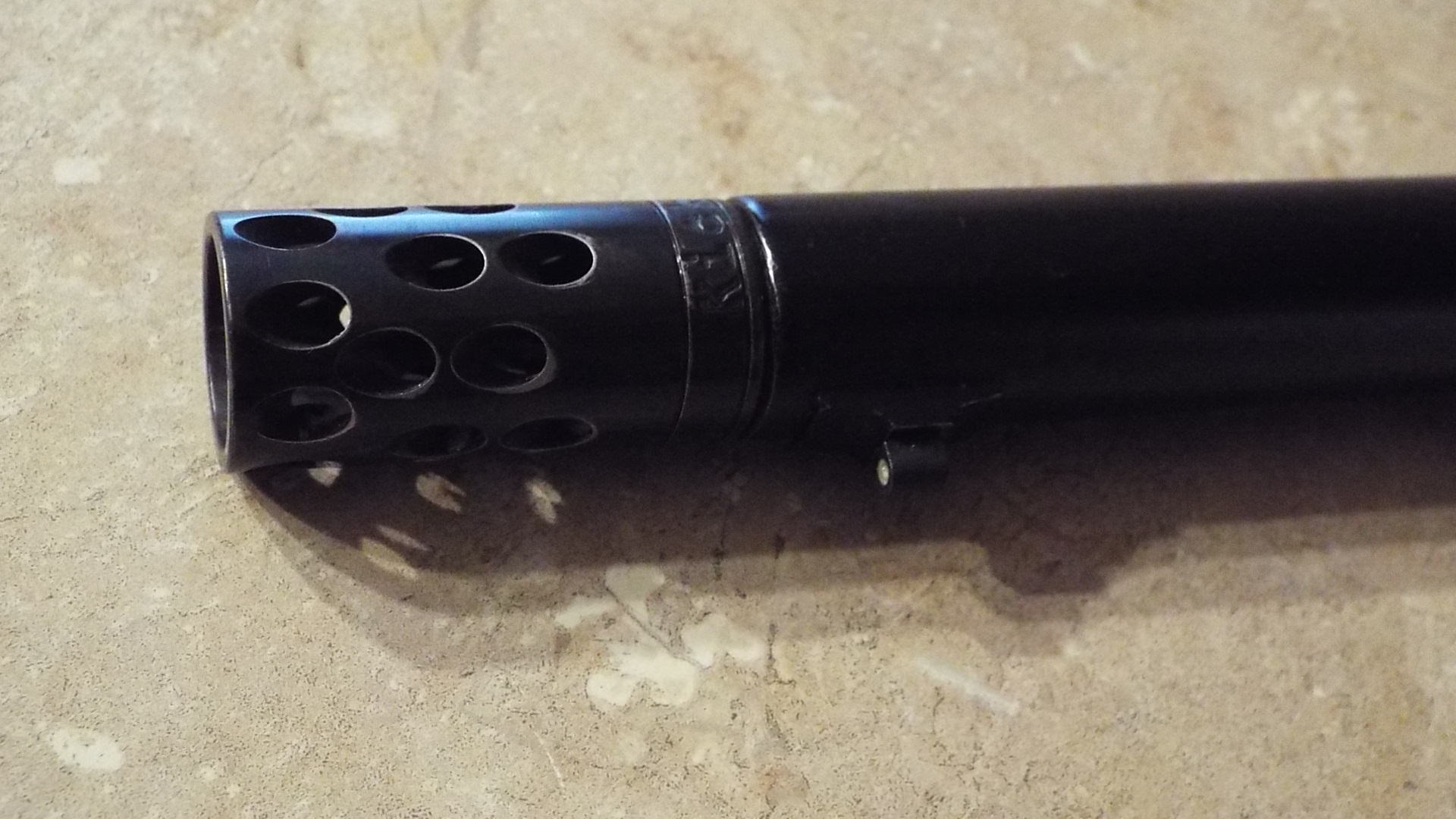

Blown-Out Shotgun Choke Tube
Always check choke tubes before shooting! Loose choke may lead to damage or injury. Here is what happened to my friend’s Beretta 1301 choke. It was loose and he simply blown it out!

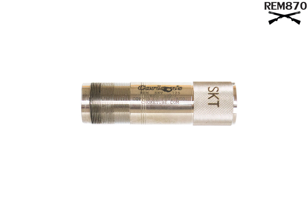

You can always see what choke you have in your shotgun because there is laser marked constriction name on the choke tube.
The choke which I use is made by Carlson’s. This company is a well-known manufacturer of barrels and chokes. Many hunters and competitive shooters have used them for years without any problems.
This skeet choke is made of 1704 stainless steel. It features a knurled surface that allows hand tightening to be easier. It also has traditional flats, so you can use a wrench to tighten it.
This skeet choke can be used with steel shot which is required in some places.
Overall, it is a very nice choke which I can recommend. This skeet choke is very nice and well made.

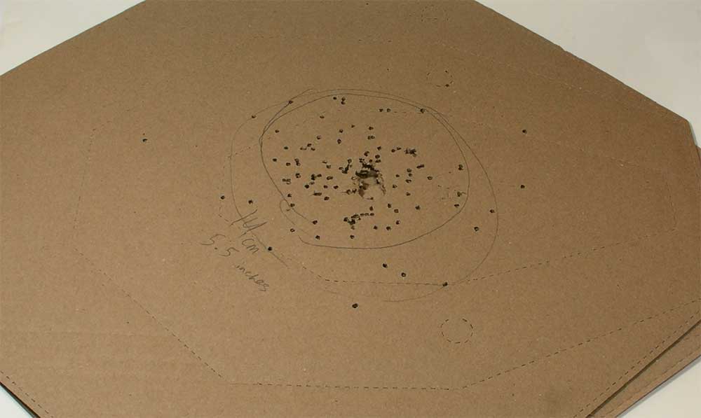

Shotgun choke patterns
Always check pattern of your shotgun with ammunition you plan to use. All shotguns are different and choke pattern depends on type of your shotgun, length of your barrel. Also, there are many types of ammunition which also influences choke pattern. So make sure that you check pattern of your choke with ammunition you plan to use. Test it on paper on different distances and remember or even make photos.

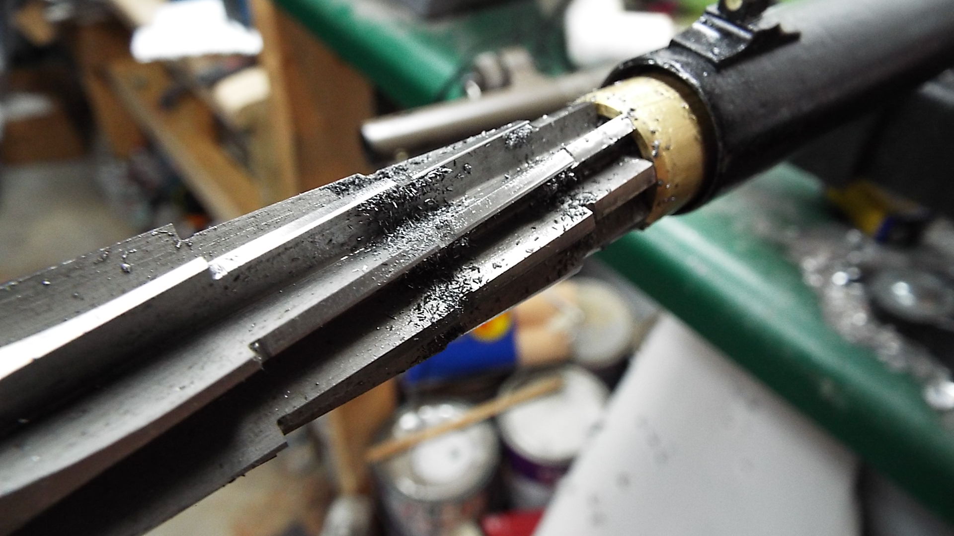

Threading a Shotgun Barrel for Choke Tubes
Owner decided to thread the original 20″ barrel of his Remington 870 for chokes.
“Odd or not, I threaded the barrel myself to accept screw in chokes.
Mainly due to the fact that when I checked the old barrel, I found that the muzzle was heavily worn and was actually a NEGATIVE choke rather than the cylinder bore the barrel was marked for.
It was the original 20″ barrel to the gun. Remington confirmed that when I was checking the serial number info on the phone with them by the date code that was on the barrel was in fact a December 89 code.
I admit that I threaded it to Mossberg/Winchester/weatherby style chokes due to being less expensive and easy to find. ”

Carlson’s Tactical Muzzle Brake choke tube
From manufacturer:
The New Carlson’s Tactical Muzzle Brake choke tube features a porting designed to reduce recoil significantly. This new choke tube is manufactured from 17-4 Heat Treated Stainless Steel in your choice of either Cylinder or Extra Full constriction. The Cylinder Choke Tube may be used with ALL shot shells including Lead, Steel, Hevi-Shot, and even slugs! The Extra Full choke tube can be used with all Hevi-Shot and lead loads (but is not to be used with slugs and cannot be used with any Steel shot larger than #2 or with any Steel shot faster than 1550FPS). The Extra Full constriction is also an excellent choice for hunters using larger shot sizes for coyotes, wild hogs and deer. The NEW Tactical Choke Tube has a head that extends approximately 2.75” beyond the end of the barrel and features a matte black finish. The addition of this new choke will not only make any ordinary shotgun look extraordinary, but also significantly reduce recoil allowing for better control of your firearm and quicker follow-up shots. Perfect for Law Enforcement or Home Defense. These chokes are proudly made in the USA and feature Carlson’s lifetime warranty.

12-Gauge 3-Gun Remington Choke Tube Set
The Brownells 12-Gauge 3-Gun Remington Choke Tube Set is designed specifically for all 12-gauge Remington pump-action and semi-auto shotguns. This particular choke tube set is suitable for 3-Gun competitions because it gives users the ability to choose which choke tube they want for a given stage. The choke tubes included in this set are a modified choke tube, an improved cylinder choke tube, and a full choke tube.
This will give you the ability to shoot everything from a steel target at a far distance to a clay pigeon moving quickly through the air. All 3 tubes that come in this choke tube set were crafted out of 1704 stainless steel. They were each designed to provide users with tighter shooting patterns that are a lot denser than what you would find with traditional choke tubes. This helps increase your accuracy when shooting at targets within a smaller radius.
The end of each choke tube has been knurled in a way that allows users to quickly remove it so they can add a new one to their weapon. The size and constriction of each choke tube have been marked with a laser on their body and end. That way, you can easily check on which choke tube you are looking at without having to guess on its size. If you’re using rifled slugs, regular slugs, or sabots, make sure you are not using a choke that has a tight constriction. An improved cylinder would be the tightest that you could use with them. Remember that the type of shells you are using in your Remington shotgun should determine which choke tube you use. Some brands of ammunition will create patterns that differ from other brands, even if you’re using the same exact choke tube.
Anyone who purchases the Brownells 12-Gauge 3-Gun Remington Choke Tube Set will receive a lifetime warranty with their order. The price of this 3-Gun Choke Tube Set is $89.99 at Brownells.com. Each choke tube that comes in the set was made in the United States. This ensures that you are getting a quality product that will last you for a very long time. Also, you don’t necessarily have to be a competition shooter in order to enjoy this choke tube set. You could be a hunter and find the convenience of being able to quickly change your choke tube to be an asset in a many situations.
Here is test results. As you can see, extended choke gives better and more predictable results:
That is especially important for competitive shooters which have penalty targets on stages. This set is highly recommended. It makes changes easier and faster and gives shooter more stable results.
Extended chokes are awesome and highly recommended!
