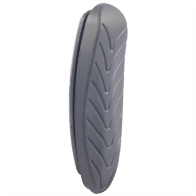

Benelli Supernova Buttpad Upgrade
Benelli Supernova comes with standard rubber buttpad which is good but there is better option. You can get gel pads with different length of pull. Also they are softer and work with recoil better.
Benelli Supernova Gel Pad 13.5 LOP
Benelli pads are expensive but they worth the price. There are versions designed specially for right hand and left hand shooters. I have chosen short 13.5 LOP pad because it is now easier to shoulder the shotgun.
One of the other upgrades I find extremely useful is Benelli gelp pad with 13.5 LOP. That makes shouldering faster and easier.
This gel pad is softer and designed specially for right hand shooters. There is version for left handed shooters available too.
This is very important upgrade because proper shouldering means a lot.
You can get gel pads of different sizes, there are longer pads available for shooters with longer hands.
Get Gel Pad with 13.5 LOP for Benelli Supernova here: http://tinyurl.com/a4gfkxc |
