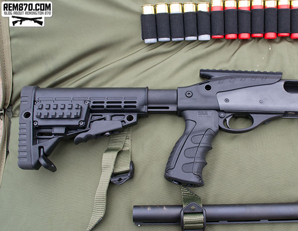

7. Pistol Grip
Modern tacticool pistol grip is only good if your shotgun is a “safe queen” and you do just several shots a year.
If you train regularly and regularly shoot 100-150 rounds during one training, you need classic stock.
Pistol grip stock is going to kill your wrist if you train regularly.
You don’t need to choose classic wood stock, you can get overmolded Hogue stock or Magpul SGA stock which is good too.
