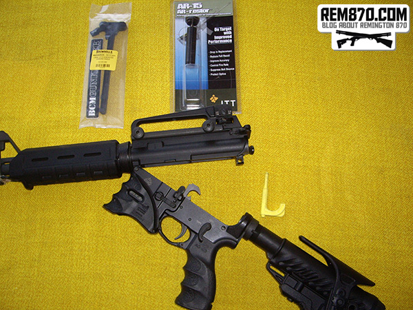

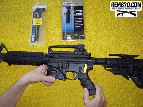

2. Push out takedown pin:
AR-15 BCM Gunfighter Charging Handle Review and Installation

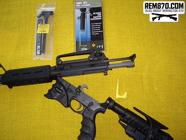

3. Open your AR-15 rifle:

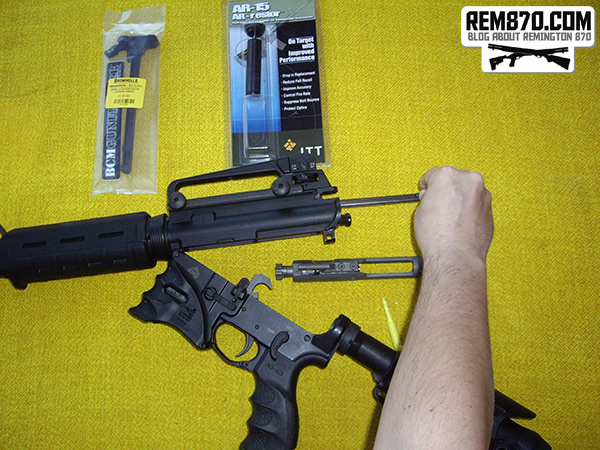

4. Pull the charging handle back:

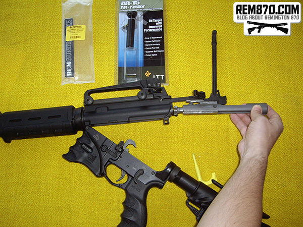

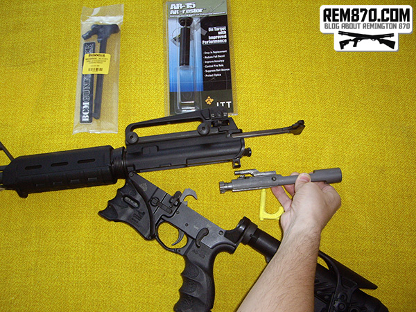

5. Remove the bolt carrier group:

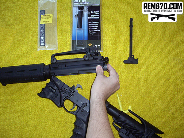

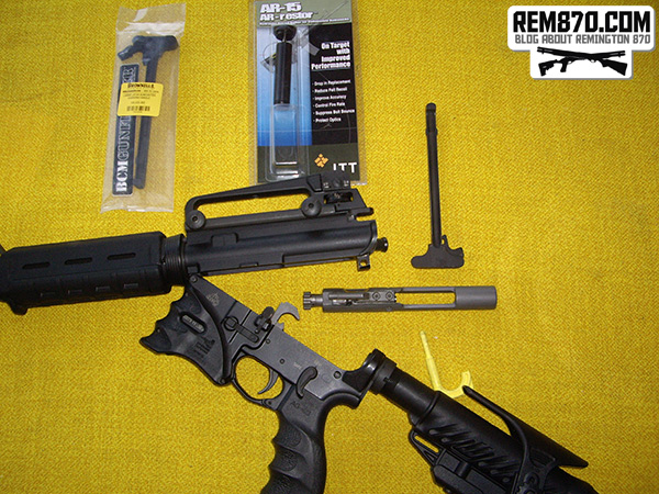

6. Remove the charging handle:

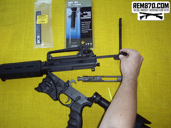

8. Install bolt carrier group:
AR-15 BCM Gunfighter Charging Handle Installation

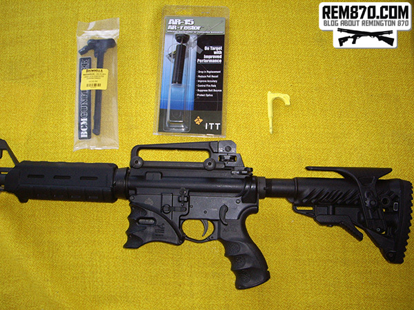

9. Close your rifle, push in takedown pin
