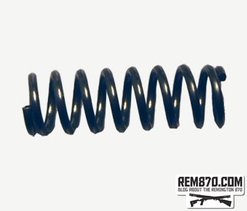

Remington 870 Standard Sear Spring
Let’s start with a standard sear spring. It has silver color, trigger pull is between 4 and 5 lbs. It is installed on all Remington 870 Express shotguns. There is nothing wrong with it, it works perfectly.
Remington part number: F17518
