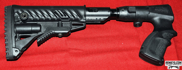

And finally the Fab stock. The AGRF 870 FK SB stock with M4 Folding Shock Absorbing Collapsible Buttstock, is a rock solid one piece ergonomic design stock that features a special non-slip texture and is made using reinforced composite material. It enhances the natural fighting stance on your shotgun and comes with a built-in shock absorber with recoil reduction. Here follow some pictures of it.
Fab Defense Stock, Remington 870
And finally all put together. No even 30min work including the dimple curing.

Shoulder stock ergonomics is greatly changed. The pistol grip of the Fab stock is simply fantastic. The M4 stock has 4 LOP positions.
Remington 870 Stocks
The Fab stock was worth every cent. It does exactly what the producer advertises. I strongly recommend it, anyone looking, a quality, versatile tactical Rem870 outfit. Keep well fellow readers.

yeah uhm I have problems installing the fab defense stock, the one I got didn’t come with an instruction manual, so could anybody pleas give details on how 2 install it, I have an 870 btw. thank you.
Hi I am also having trouble installing mine. No directions & no videos really online about it. Looks like the long screw which comes with the Remington 870 standard buttstock, seems to be too long for the Mako-870fk collapsible stock. Does anyone know if I’m supposed to replace it and if. So why didn’t the site Mako site say that and or include the screw needed? Anyone have this issue too?
I am having the EXACT same problem. Someone please help!!
I FIGURED IT OUT. I WILL TRY TO SHARE.
THE REQUIRED SCREW IS IN THE COMPARTMENT OF THE GRIP. OPEN THE BOTTOM (NOT AN EASY TASK WITHOUT A SMALL FLAT HEAD SCREWDRIVER) AND THE NEEDED SCREW AND WASHER ARE THERE.
WHAT WAS MOST MYSTIFYING IS HOW TO ATTACH.
1ST, REMOVE THE HAND GRIP FROM THE STOCK. UNSCREW THE HEX BOLT – YOU MUST HAVE THE STOCK SIDE FOLDED TO REVEAL THE HEX SCREW THAT HAS TO BE REMOVED.
2ND, THERE IS A ROUND METAL INSERT PIECE THAT HAS FOUR HOLES IN IT. THAT PIECE SCREWS OUT. I USED A SMALL SCREW DRIVER IN ONE OF THE HOLES TO BACK IT OUT. THERE NO TENSION ON THAT PART AND IT EASILY SCREWS OUT WITHOUT RESISTANCE.
3RD, THE SCREW AND WASHER FROM THE COMPARTMENT IN THE GRIP IS USED TO ATTACH THAT GRIP (MINUS THE STOCK THAT WAS JUST REMOVED) TO THE 870 RECEIVER.
4TH, REATTACH THE STOCK TO THE RECENTLY ATTACHED GRIP WITH THE SAME HEX NUT SCREW THAT WAS USED TO REMOVE IT.
WHY THEY DON’T EXPLAIN THOSE STEPS IS A MYSTERY TO ME.
