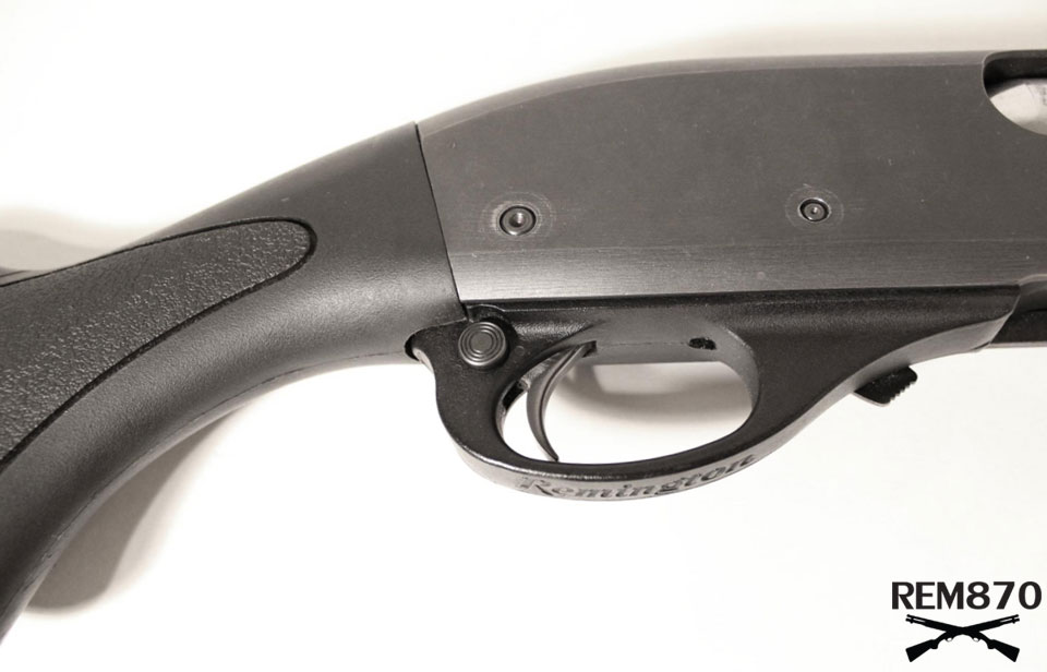

There are three controls that an 870 user manipulates with their shooting hand: the trigger, the safety switch, and the slide release. With the traditional semi-grip shotgun stocks that the 870 was designed to use, these controls are all easy to reach and manipulate. Pistol grips, whether part of a stock or stand-alone, can have a significant effect on how – and how easily – these controls are manipulated. Pistol grips rarely interfere with the gun’ s trigger for obvious reasons, but they can – and frequently do – make working the safety or slide release slower or more difficult.
The 870’ s cross-bolt safety is located right behind the trigger, and with a traditional stock that’ s no wider than the receiver and doesn’ t enclose the rear of the trigger guard, it is possible to apply pressure on the safety with the side of the finger, rather than the tip. This allows the user to disengage the safety while keeping their fingertip on or very near the trigger, so a shot can be made virtually immediately. With traditional stocks, the safety is also fairly easily reached with the thumb or middle finger for re-engagement, or for disengagement in the case of left-handed shooters using an 870 with a right-handed safety switch.
Remington 870 Safety with semi grip
Pistol grips tend to place material directly behind the safety button, which sometimes spaces the trigger finger further out, making it more difficult to reach the switch with the fingertip on the trigger. This can often be addressed by installing an extended or enlarged safety button, but if so, that effectively adds to the cost of the grip, and it may give you another thing to change out if you switch between a pistol grip and a traditional stock on your gun.

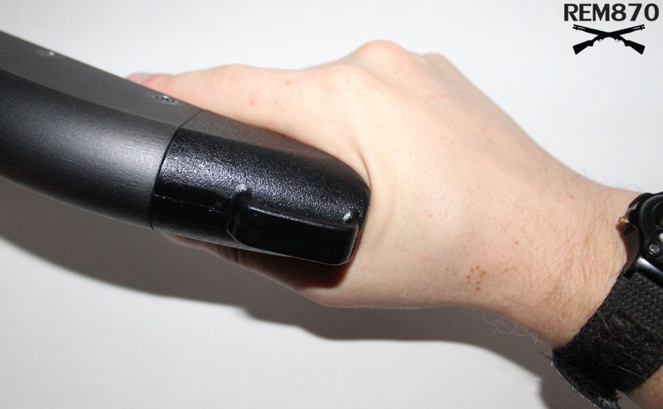

The 870’s slide release, located on the front left of the trigger guard, requires the user to shift their grip in order to reach it. Among other advantages, this prevents the user from accidentally unlocking the action at an inopportune moment, and ensures that no stock or grip will block or obscure this control or drastically change how it is manipulated. With traditional semi-grip stocks, it is easy to move the dominant hand forward, with the thumb riding up over the top of the receiver, to reach the slide release. Then, once the action is unlocked, the hand slides smoothly & naturally back to a shooting grip. This technique is applicable for both right- and left-handed shooters and allows the user to maintain a secure hold on the gun at all times. Though it can seem awkward at first, with practice, it can become very quick and reflexive. It’s also surprisingly easy to do one-handed.
Pistol grips move the shooter’s thumb down below the receiver, and many overhang the hand to some extent, which blocks the thumb from simply sliding up and over the receiver. Instead, the thumb must either stretch up and over the top of the grip, or swing around the side of it. Either way, the user releases & re-acquires their hold on the gun twice, which requires more complex motor skills (a definite downside when rushed or stressed), adds steps & time to the procedure, and requires that the gun be actively supported with the other hand.

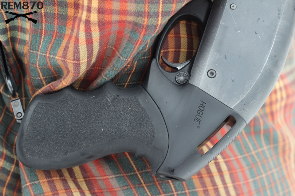

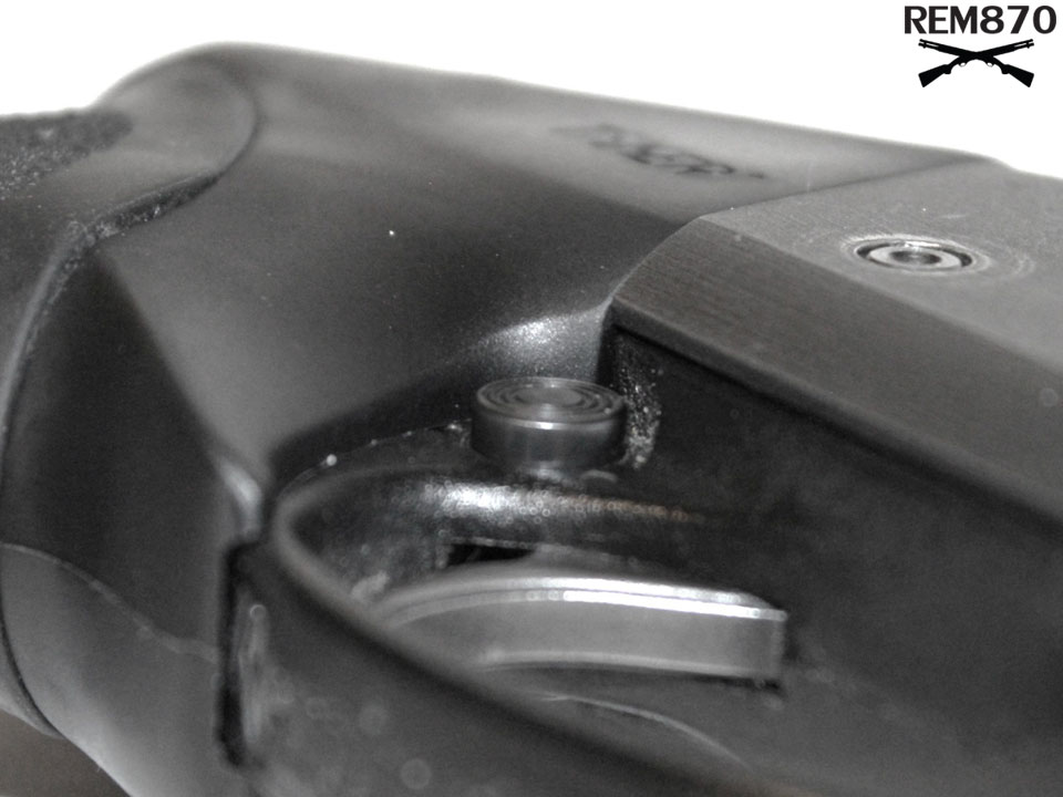

Hogue:

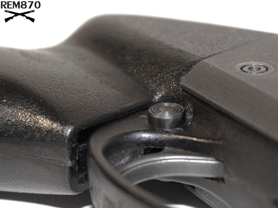

The Hogue grip extensively encases the rear of the trigger plate assembly in hard plastic, and it is quite wide behind the safety button. There is a well in the plastic for the trigger finger that helps quite a bit, but it isn’t perfect.
Hogue Tamer Remington 870 safety
I can readily work the safety using the side of my finger, but I need to pull my fingertip back off the trigger to reliably actuate it, and then get it back for a proper trigger pull. I can’t snap the safety off and fire as rapidly as I can with a traditional stock, but it’s still pretty quick with a bit of practice. Some may find that an enlarged safety button makes operating the safety easier or faster with this grip, but now that I’ve gotten the hang of it, I’m just fine with the factory button.
The size & shape of the Hogue grip makes re-engaging the safety with the thumb (or disengaging with the thumb, for left-handed users) fairly easy. A bit of a grip shift is required, but again, it’s pretty straightforward if you practice. Re-engaging the safety one-handed is easier than I expected, as the tacky rubber helps me keep ahold of the gun as I shift my grip to reach it.
As for the slide release, the Hogue pretty well exemplifies the potential issues brought up above. The overhang means I have to release my grip briefly to get around it, and I have to have a good hold of the gun with my other hand to unlock the action with any kind of grace or speed. Additionally, the tacky rubber grip material extends up to the underside of the overhang, adding some less-than-helpful friction to the procedure; and with the complex grip shape, I have to pay a bit of attention to get my hand back where it needs to be with each finger in its respective groove. That said, the Hogue’s overhang is not too severe, and the top of the grip blends well with the lines of the receiver, so my thumb doesn’t have to travel too far to get around it. With practice and a good hold on the fore-end, I can get to the slide release reasonably quickly and easily.
So long as you figure out some slightly different techniques and practice with them, the Hogue doesn’t interfere too much with the gun’s controls. It’s not perfect in this department, but it’s very definitely not the worst.

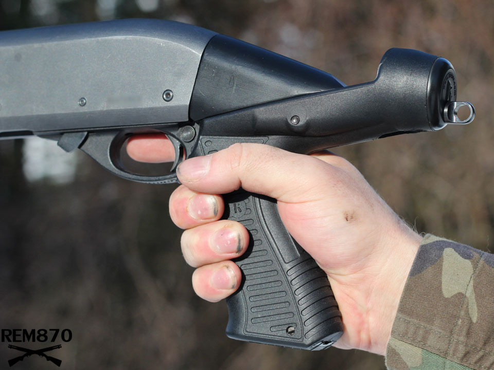

Blackhawk:
Because the gun recoils back into the Blackhawk’s grip frame, the frame needs to be wide enough to slide over the safety, as well as having enough structure to support and guide the aluminum mounting block & the attached gun. As a result, the sides of the pistol grip overhang the safety button quite a bit, leaving it entirely out of reach of the side of the trigger finger.
Blackhawk Breachersgrip Safety Remington 870
To disengage it, I have to completely take my finger off the trigger and use its tip to push the button over. And thanks to the pistol grip‘s girth, I have to shift my grip in order to get at the other side with my thumb, even with my large hands. Re-engaging the safety without holding onto the fore-end is particularly awkward.
This would be a situation where an extended safety button could really help, but the Blackhawk’s moving grip will hit most extended safeties, potentially damaging the grip and/or the safety mechanism. A few extended safeties are said to be compatible (the flat-head Wilson Combat safety has been recommended for use with Knoxx stocks), but as they have to be short enough to clear the moving grip, they’re not going to be as much of a help as a taller safety would be.
The BreachersGrip isn’t great when it comes to the slide release, either. With the recoil extension sticking quite far out to the rear, there’s really no way to slide the hand up and over the receiver. It helps a bit that the grip surface is a hard plastic that skin can slide easily on, but chambering that first round is still noticeably slower and more complex. If you’re using this grip on a fighting gun, you’ll definitely want to either chamber a round or drop the hammer before any action is expected to start.
Out of all of these grips, the Blackhawk offers the worst control ergonomics by a good margin. It’s not hopeless, especially with some practice, but it definitely gives up speed & simplicity points in exchange for its recoil-mitigating system.

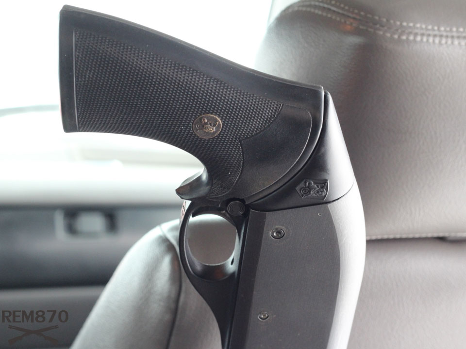

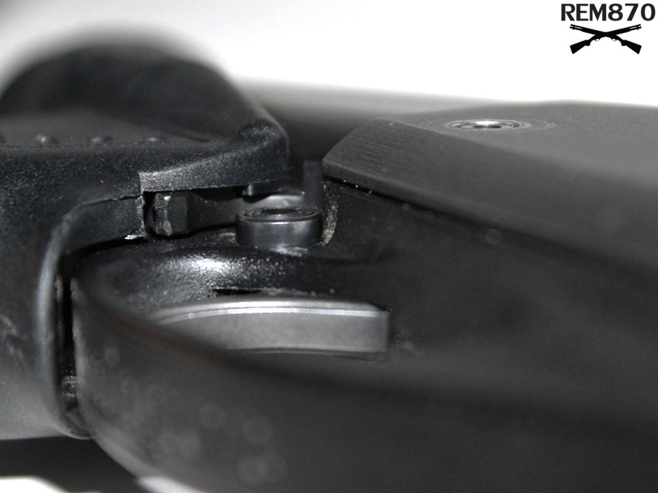

Pachmayr:
The Pachmayr grip comes right up to the safety button, but it’s not too terribly wide, and there are circular safety cut-outs in the rubber on each side that provide a bit of clearance.
Pachmayr Grip Safety Remington 870
Between that and the flexible nature of the rubber, quickly disengaging the safety is fairly easily done with the last joint of my trigger finger. I do have to slip my finger back off the trigger slightly to reliably push the safety over, but this doesn’t slow me down much. A large-head safety could help here, especially for folks with smaller hands, or when adopting a very high grip. The cut-out in the rubber grip sleeve leaves plenty of room for one, and should help keep it from being too easy to disengage accidentally. I don’t think it’s essential though.
Reaching the other side of the safety with the thumb is easy enough. Doing so repeatedly can get a bit uncomfortable if you have large thumbs like mine that rub on the bottom of the receiver at this angle, but that’s an issue that’ll likely only show up in practice sessions, if at all.
Due to the complete lack of overhang and the higher grip location, sliding the hand up over the receiver while reaching for the slide release is a breeze. It’s even pretty do-able one-handed. The only problem I had was that when I slid my hand back to reassume a shooting grip, my middle finger tended to rub on the rubber flap sticking out below the trigger guard, and this could get a little uncomfortable after enough drill time. You could try trimming this down a bit, but cutting it too short will remove the cushion between your middle finger and the rear of the trigger guard. Since a pistol-gripped shotgun isn’t realistically intended for high-volume shooting anyway, I’d just leave it be.
Overall, the Pachmayr’s control ergonomics are quite good – probably excellent with an extended safety.

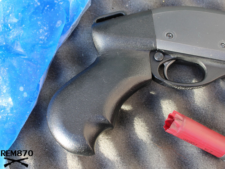

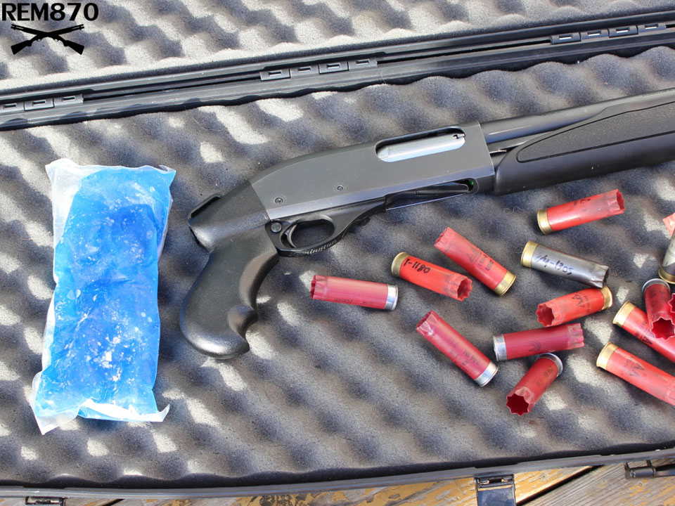

TacStar:
The TacStar pistol grip narrows very nicely as it meets the trigger guard, and the top of the grip isn’t very wide to begin with.
TacStar Pistol Grip Safety Remington 870
As a result, the factory safety is extremely accessible, and delightfully quick & easy to manipulate in either direction. It winds up perfectly placed under my finger when I have the tip on the trigger, yet is safely out of contact when I index my finger on the trigger guard or the bottom side of the receiver. My thumb is out of contact with the button when I have a firing grip, but just the slightest shift of my hand is sufficient to reach it for re-engagement. Re-engagement is quite easy even when holding the gun one-handed. This grip is far and away the best of the four when it comes to safety accessibility – an aftermarket extended safety is not only unnecessary, it would probably actually be detrimental.
The TacStar grip does have a bit of an overhang, but it’s not too terribly awkward to reach over when manipulating the slide release. It’s similar to the Hogue as far as technique, but with the smooth plastic grip surface and the more simplified grip shape, the movements are a little more straightforward. Unlocking the slide while holding the gun one-handed is still pretty sketchy, unfortunately. A strap passed through the loop on top of the grip significantly interferes with reaching the slide release if it is looped around the user, but seems to have little effect when it is hanging freely.
In short, the TacStar is surprisingly very ergonomic with regard to the gun’s controls; easily the best of the four with the factory safety button, and second-best with the slide release.

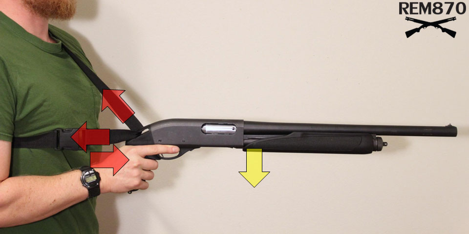

Hogue:
The Hogue pistol grip performed well and shot reasonably comfortably. The elastomer cushion built into the top of the grip did a good job of protecting the common pressure point between my thumb and index finger. The rest of the backstrap is simply a thin layer of rubber over rigid plastic however, so the lower part of my hand did receive a sharp smack from the recoil. Still, with the hand-filling grip shape and no pressure point up top, that smack was distributed over a pretty large area. With a support hand on the fore-end, both the ¾- and 1-ounce loads felt fine, while the heavier 1 ¼-ounce shells had a pretty healthy snap to them. If I shot too many of the heavy loads too quickly, the cumulative recoil started to get uncomfortable, but not unmanageable; I could handle and shoot the gun effectively even if I wasn’t exactly enjoying it.
But when I let go of the fore-end and shot the gun with a one-handed or handgun-style two-handed hold, it was a different story. When the gun is held this way, the shooter’s hand must apply a torque at the pistol grip to keep the gun upright. To apply this torque, the fingers pull backward at the top of the front strap, and the base of the hand (specifically the ulnar side of the carpus) presses forward against the bottom of the grip’s backstrap.
Pistol Grip Force Diagram
This had the effect of “pre-loading” the Hogue’s pronounced heel against my carpal bones, and when the gun was fired, that was where the kick was concentrated. ¾-ouncers still weren’t bad, but the one-ouncers had some sting, and the 1 ¼-ounce shells really got to be painful. One-handed shooting was doable, but definitely unpleasant, and I’m sure I would have been a bit faster without the pain. If you’re running the Hogue grip, you’ll definitely want to stick to a normal two-handed hold with a support hand ahead of the gun’s center of gravity as much as possible (which, to be fair, is generally the most effective way to handle a long gun anyway).
I did try firing one-handed while pressing into a shooting sling looped around my shoulder, and that was much more comfortable, since the rearward force applied by the sling at the top of the grip took the pressure off my palm at the heel, shifting the majority of it up to between the thumb & trigger finger where the Hogue’s recoil cushion is located.
Pistol Grip Shooting Sling Demo
While the Hogue wasn’t always comfortable, it was still controllable and effective with all my test loads, the rubber grip staying securely put in my hand with any shooting hold. Realistically, a pistol-gripped shotgun is a “carry a lot, shoot a little” concept. If you are shooting high volumes, it’s almost certainly for recreational purposes or practice sessions, where you can simply stick to lighter-recoiling shells that don’t wear you out nearly as fast.
Blackhawk:
Initially, I wasn’t sure what to expect from the Blackhawk’s spring-loaded recoil-mitigating system. While I knew that similar spring-loaded stocks had their fans, the spring in this pistol grip was very stiff, requiring a good portion of my body weight to collapse the mechanism. Without a shoulder stock to brace against, I wasn’t sure that just the strength and inertia of my arm could provide enough opposition to allow the spring system to actually do something useful.
Turns out, the spring system does its job quite well. It’s obvious when shooting that the rest of the gun is reciprocating relative to the grip under recoil. I did notice that the mechanism travels along a slight upward angle relative to the bore axis, which seems to encourage straight-back recoil and discourage muzzle flip. The Knoxx’s relatively high mass certainly helped to dampen recoil as well, the extra ounces yielding an average reduction in free recoil energy of about 10% compared to the other three grips. As a result, all loads – from the super-light ¾-ouncers to the heavy 1 ¼-ouncers – were quite comfortable with any two-handed or one-handed hold I tried. I really felt like I could keep at it all day if I wanted to, and that made shooting with this grip just plain fun.
The only discomfort I experienced was with rapid one-handed shooting. Since that hold required a lot of pressure between the grip’s heel and the base of my palm to keep the gun upright, and the size of the grip made it difficult to have a really secure grasp on it, the ridges at the heel of the grip began to rub me a bit raw as they shifted around under recoil with the heavier loads. This really wasn’t too bad though; I suspect most folks would get tired of holding a 7-pound shotgun one-handed long before the rubbing became a problem.
Just for giggles, I loaded up some 1 ½-ounce and 3” 1 7/8-ounce magnum shells, and fired them one-handed. These were very heavy loads; at its rated velocity, the 1 7/8-ounce load would have been generating almost 65 foot-pounds of free recoil energy in this 6.5-pound gun. That’s about double the recoil of the 1 ¼-ounce test load, and well into elephant gun territory. The massive recoil really drove the gun back hard, and probably worked the spring system to its limits, but apart from some rubbing from the ridges on the heel of the grip, I was just fine afterward. I wouldn’t recommend regular use of loads this heavy just because it takes quite a bit of time to recover and get the gun back on target, but it is a testament to how effective the Blackhawk grip is at spreading out recoil and reducing its intensity. I would never have tried this with any of the other three grips.
However, while the spring system did greatly mitigate recoil, it also allowed much more recoil movement. As a result, the gun didn’t feel as controlled as it did with other grips. I kind of had to give the thing a split-second to settle down before cycling it and bringing it back onto target. Plus, the large, slab-sided plastic grip didn’t stay put in my hand very well during all this, and I sometimes had to re-acquire my hold before taking the next shot. I’m probably making this sound worse than it actually was, though. More than anything, the Knoxx grip just had a very different feel from what I was accustomed to. It really didn’t seem to slow me down all that much once I got used to it – at least compared to how rapidly I could shoot with other pistol grips.
Pachmayr:
Despite its relatively simple design, the Pachmayr turned out to be pretty comfortable no matter how I was holding the gun. Between the grip’s forward-curving shape, the inherent give in the rubber, and the internal void under the upper backstrap, recoil always seemed to distribute itself evenly over my entire hand, and there wasn’t the “shock” one would expect from a more rigid grip surface. The recoil was all there – it wasn’t soaked up as it had been with the Blackhawk grip – but the edge was definitely taken off of it, and no one area of my hand was “singled out” enough to make things unpleasant. Plus, thanks to the firm, checkered rubber, the gun never felt like it was trying to get away from me, even with heavier loads.
The lack of any overhang above the backstrap also offered some options for how to hold the thing. I could hold high to minimize muzzle flip and shoot quickly in exchange for more of the recoil energy coming straight back at me; or I could hold lower, giving the gun more freedom to recoil and taking some of the stress off my hand, while reducing my maximum effective rate of fire. Either way, the recoil was manageable and distributed well, and the gun came back onto target easily and naturally.
TacStar:
The TacStar grip was a real let-down at the range. ¾-ounce loads were tolerable, but the 1-ounce loads were quite uncomfortable, and started becoming painful if I fired more than a few in quick succession. The 1 ¼-ounce loads were painful from the first shot, even with a good two-handed hold. The angle and heel swell that are said to “distribute recoil energy evenly” for “painless positive control” do nothing of the sort. Instead, they encouraged my hand to slide upward, jamming my thumb and trigger finger bones into the hard plastic overhang with every shot.
close-up of overhang going into digits
And if I shot one-handed, holding the gun so that there was less initial force between my thumb & trigger finger, the hard, pronounced heel swell pounded against the base of my palm – while the overhang continued hammering into me up top. I only fired two or three 1 ¼-ounce shells that way before I just had to stop.
I tried using a shooting sling, but since the top-mounted sling only served to pull the grip harder against the top of my hand, it just made the pressure point there even worse.
