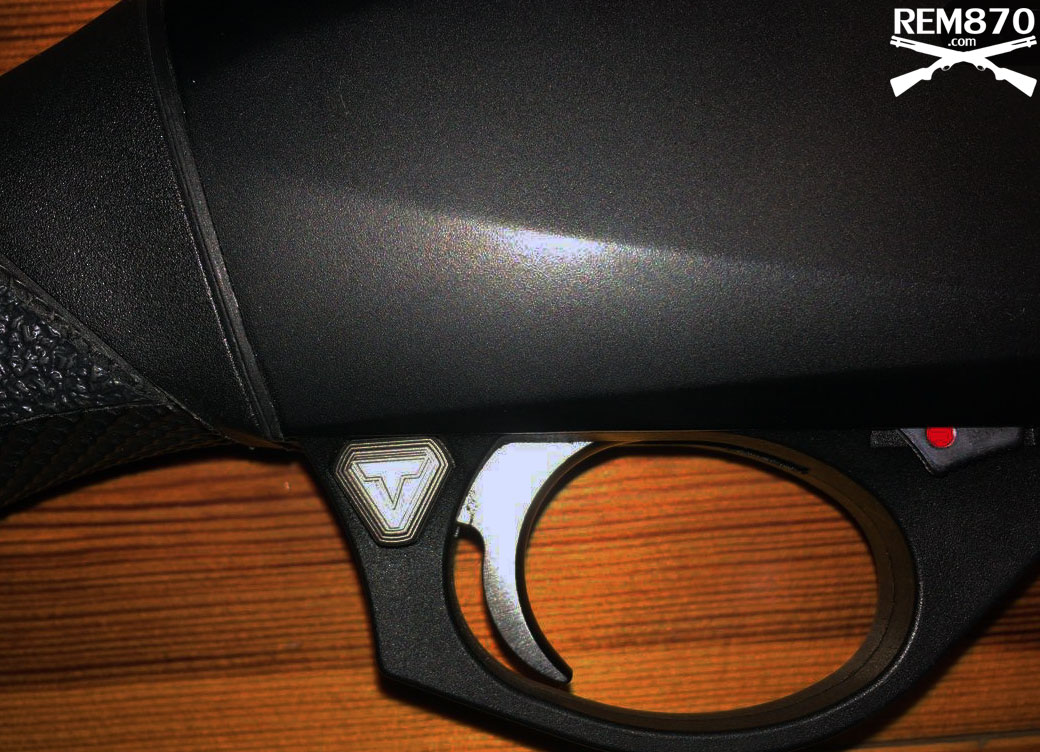

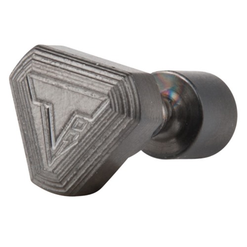

Oversized Safety Button for Benelli M2
Taran Tactical Innovations Safety Button
Roth Concept Innovations Oversized Safety Button
The standard safety button is good but it can be replaced with an oversized one. An upgraded safety enables the shooter to disengage it faster especially if they are wearing gloves or under stress during a competition.
Even experienced shooters may forget about the safety while under stress or when they need to start from an unusual position. This could be a shotgun held in a weak hand or when the shotgun is lying on a table. That is why an oversized safety is handy because it sticks out and you can switch it off simply by putting your finger on the trigger.
There are many aftermarket oversized safety buttons available for the Benelli M2 shotgun. They all work similar but have cosmetic differences.
Some competitors use a factory safety without any problems but many prefer to have the oversized one in order to find and disengage it faster.
The most commonly used safety buttons are:
Daves Metal Works Benelli Oversize Safety Button

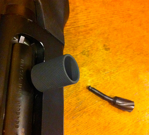

Benelli M2 Extended Bolt Handle
Benelli M2 Extended Bolt Handle by Nordic Components
The Standard Benelli M2 bolt handle is rather small. That is why the extended charging handle is another feature which is good to have. It makes manipulations easier while under stress.
There are several extended bolt handles available on the market. Most of them are from well-known manufacturers such as Taran Tactical Innovations and Nordic Components. There are also bolt handles from smaller companies as well.
Many users effectively use Nordic and Taran oversized charging handles and you can’t go wrong with them. So, choose which one you like more.

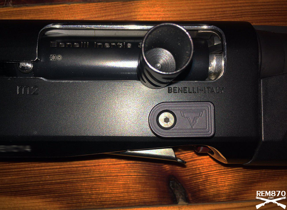

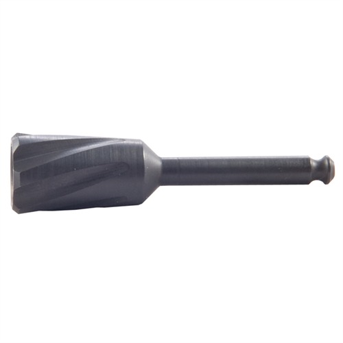

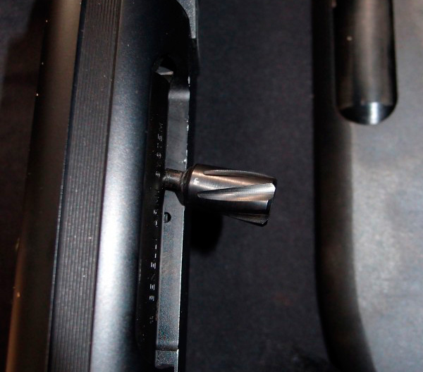

Benelli M2 Oversized Bolt Release Button
Taran Tactical Innovations Oversized Bolt Release
Nordic Components Extended Bolt Release

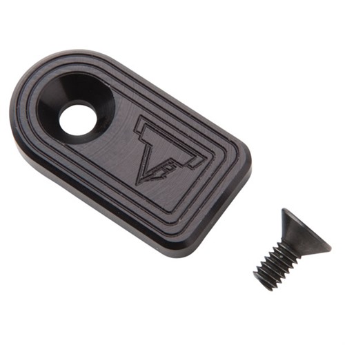

All of the competitive shooters I know upgrade the factory bolt release button which is rather small with an oversized one. An oversized Benelli M2 Bolt Release button is easier to find and press especially under stress. It is extremely handy when the shotgun is empty and you need load a round into a chamber and press the bolt release button without looking at it.
The Taran or Nordic buttons are inexpensive and used by many shooters. The Red Neck Tactical Benelli Rapid Bolt Release Tab is inexpensive but looks very interesting. The GG&G Bolt Release Button is very expensive (more than hundred dollars) but doesn’t have any big advantages.
Use Loctite when installing the rectangular bolt release button. This will prevent unwanted movement.
The most commonly used bolt release buttons are:

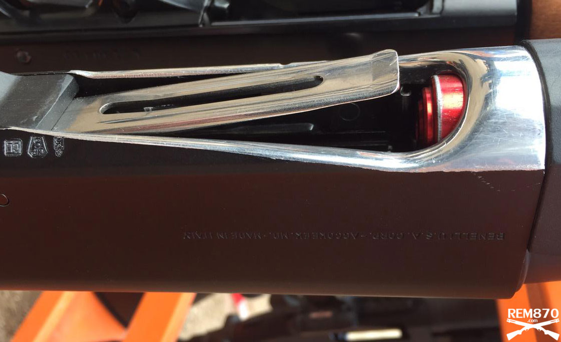

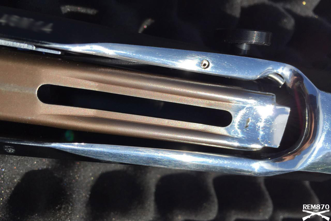

Benelli M2 Loading Port Modification
Benelli m2 loading port modification

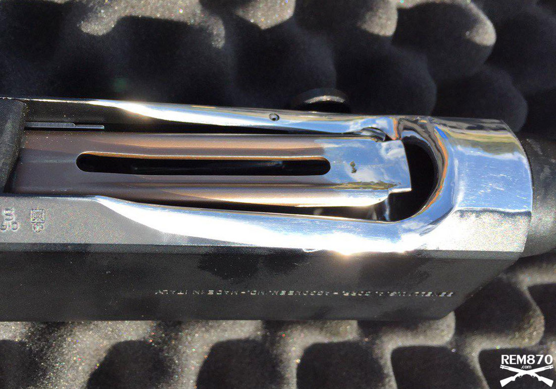

Half of the success during shotgun competition depends on the speed of reloads. Most of the competition shooters use Load-2 or Load-4 belts which enable competitors to load shotguns really fast. You need to load your shotgun quick in order to win competitions. That is why the loading port requires modification. The loading port needs to be opened and polished, and it needs to be really smooth so that loading can be easier.
An opened loading port enables the shooter to load their shotgun much easier and faster. Such modification should be done by an experienced person or professional gunsmith. Some shooters do it at home but it requires special equipment and skills. Be careful to not overdo this because it may lead to malfunctions. If you open the loading port too much, the magazine follower (especially if it is worn out) may stick out too far causing malfunctions.
The modified loading port may look scary at first but it really simplifies the loading of a shotgun. Most of the competitive shooters do this modification to their Benelli M2 shotguns.

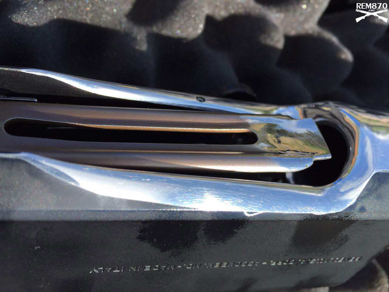

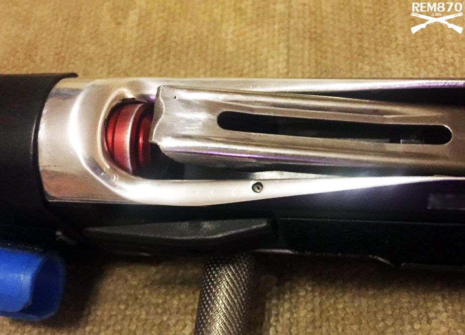

Benelli M2 Extended Carrier
As you already know, fast reloads are crucial for good performance during shotgun competition. And another part that needs to be upgraded or modified is a shell lifter (carrier). The fork shape of the factory carrier makes fast Load-2 or Load-4 reloads very inconvenient and almost impossible.
The carrier must be extended for trouble free reloads. The fork carrier can and will catch your thumb every time you try to load shells. You may try loading your Benelli M2 without modifying the carrier but you will end up installing the extended one. So, it is better to install the extended carrier from the beginning.
You can either extend the carrier with the help of a gunsmith or you can simply buy the Benelli AccuGuide Extended Carrier by Taran Tactical Innovations.
The extended carrier makes a huge difference because the loading becomes much smoother. The lifter won’t catch your thumb and you will be able to load your shotgun much faster. And remember, success during a shotgun match depends on the speed of the reloads.

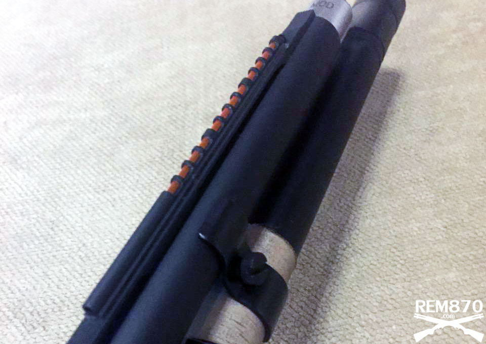

Benelli M2 Magazine Extension Clamp
(You may notice white duct tape which shotgun owners use to protect the finish of their shotgun from scratches).
Nordic Components Magazine Extension Support Clamp

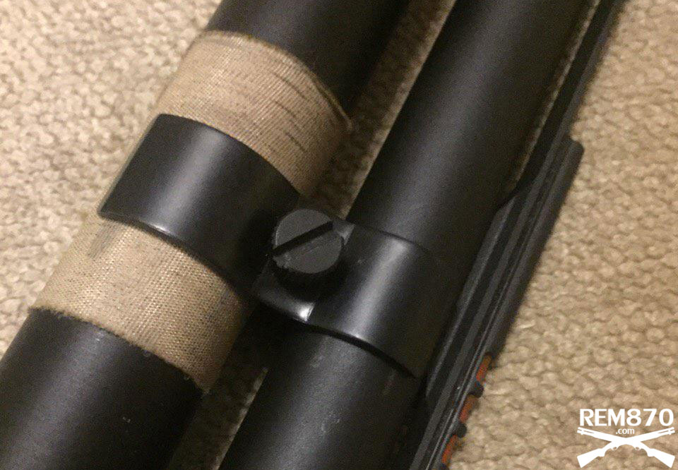

Magazine extension clamps hold the barrel and the extended magazine tube. They stabilize and support the magazine tube. Magazine clamps are not mandatory for shorter tubes but they are the must have for shotguns with very long tubes which most of the competitive shooters have.
There are two common magazine clamps that shooters use: Benelli and Nordic Components. The Nordic Components magazine clamp looks sturdier and many shooters prefer them. You can also choose the Benelli clamp which also works fine.
Actually, it doesn’t matter which magazine clamp you choose. Just be sure to have one to protect your magazine tube because shooters often hit barricades with their shotguns under stress.
Magazine tube clamps may change the point of impact with slugs, so make sure that you always have it in one exact place.

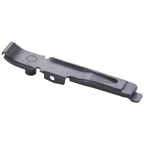

One of the must have parts that you always need to have with you is the Benelli M2 Carrier Latch. This part needs to be replaced over time especially if you shoot and dry fire often.
Other parts that are good to have are the extractor, extractor/carrier latch spring and firing pin.

Taran Tactical Innovations for Your Benelli Shotgun
This safety is used for “Three Gun Competition” and for tactical shotguns. Getting your weapon from safe to ready fire mode is critical and split seconds do count in many situations.
The safety engages and disengages with a positive click, so not only is there a more pronounced feel to the oversized safety you can also hear the safety engaging/disengaging.
Benelli Oversized Safety - Taran Tactical Innovations
Benelli Oversized Safety – Taran Tactical Innovations
Here is review of the Taran Tactical Innovations upgrades for a shotgun from one of the readers of the blog.
Because it is extended, you have more leverage and can operate the safety without repositioning your shooting finger, and can easily be operated using gloves. This part is designed for the user to install so no gunsmith is required.
Specs:
• Fits Benelli M1, M2, M3, M4, Super Black Eagle, Montefeltro, and Remington Versa Max
• CNC machined out of billet stainless steel
This is another outstanding upgrade that serious shooters in particular competition shooters should consider as part of their ongoing upgrades or rebuild efforts. The oversized safety of course is ideal for any shooting situation and it is particularly ideal for new shooters.
Knowing by feel and even being able to hear the click makes any weapon safer. There should never be a question in any shooters’ mind about whether the safety is engaged or if the weapon is ready to fire. The oversized safety always puts safety first and helps makes sure that even new shooters pay attention.
Being oversized does not mean it interferes with your shooting finger once in position. It does however let you know the safety is there so as you get ready to fire you can operate the safety with your trigger finger as you ready to fire. This safety is different from the so-called mushroom or domed ones where the finger can slip off the safety if you are in a hurry.
The Benelli Oversized Safety by Taran Tactical Innovations is designed so your finger has plenty of area to push against and requires little effort to operate even under the most extreme situations.
This safety is designed not to get in the way or to be accidentally manipulated. However, it is every shooters responsibility to know what state their weapon is in at all times. There have been discussions in the past about oversized safeties catching on objects or disengaging when dropped but this again falls back on the shooter. The weapon whether in ready fire or not cannot fire unless the trigger is depressed by the shooter.
With an oversized safety, you always know at a glance or feel the state of your weapon. Factories model are considerably smaller and while some do have red indicators, indicating where the safety is at this still requires you to look. In a shooting position, you cannot move your head or weapon to look in many cases so knowing by feel is critical.
Being made out of stainless steel means you do not have to worry about corrosion and wear and tear is reduced giving you years if not the lifetime of the weapon usage.
Recommended Product:
Benelli Oversized Safety on Brownells
Benelli Oversized Bolt Release
Description and Specifications
• Made big enough to release the bolt easily and quickly in the heat of battle or during competition
• However, it is not so big that it is a hindrance, it is designed not to catch on things if using it on a tactical shotgun in a defensive situation
• The oversized bolt release allows you to get back into action quicker
• Fits on Benelli and any other shotgun that has a similar bolt release button
• Made of aircraft grade aluminum with mil spec hard anodizing
• Drilling and tapping required
• The mounting screw is a 3.5 x .35 Metric with an OAL of 0.299″ (nominal)
Keep in mind you will need to modify your weapon when installing the Benelli Oversized Bolt Release. You will have to drill and then tap a hole to accept the mounting screw. This is not a complicated procedure and can usually be done quite easily in less than 30 minutes if you have the proper tools and some skill in this type of procedure. If you feel you cannot do this, seek the help of a qualified gunsmith so you do not cause damage to your weapon or to the part.
Shooters tend to get comfortable with their weapons and thus find it hard to upgrade thinking they can shoot and perform quite well, with how they have things set up. To advance from an adequate shooter to an advanced shooter you need to be open-minded and willing to try innovations such as the Benelli Oversized Bolt Release by Taran Tactical Innovations.
Shooters understand the need for components that work even when your mind is racing. You may be in the heat of battle or simply in competition and the need for speed is critical. This means you cannot take your eyes off the target, your hands and fingers must do all of the work while your mind and eyes stay engaged.
Factory weapons are good for the occasional shooter but once you get serious about shooting, and home defense you should always consider components that will make your shooting more consistent and improve the overall capabilities of your weapon.
Whether you have gloves on or not the oversized bolt release can be operated by feel. No more fumbling with your weapon so you can see what you are doing, now you can feel what you are doing without moving your muzzle off target. No one wants to shoot a weapon dry but if you do, you need to be able to recover quickly. Fast loading is one of the most critical aspects of shooting and many times separates good shooters from excellent shooters.
Oversized bolt release makes their weapon look tactical and does not protrude and catch on objects as some had suspected it would. The bolt release can be felt with gloves on, which makes it ideal for many shooters who routinely wear shooting gloves regardless of the weather.
The Benelli Oversized Bolt Release is ideal for home defense, tactical and hunting weapons and is particularly ideal for competition shooting.

Nordic Components Benelli M2 Charging Handle Fail
Here is photo from my friend. He owns Benelli M2 with charging handle from Nordic Components. During the last training he had a malfunction and had to clear it. He pulled charging handle and here is what happened…
My friend has sent photos to Nordic Components but not received any comments from them.
So, if you plan to use Nordic Components charging handle, be careful or search for alternatives.
