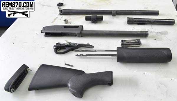

1. Disassemble your Remington 870 shotgun:
Disassembled Remington 870, Ready for Sandblasting, Degreasing and Painting

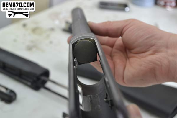

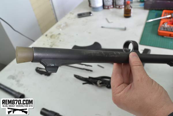

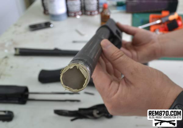

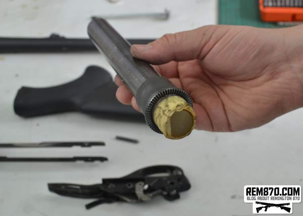

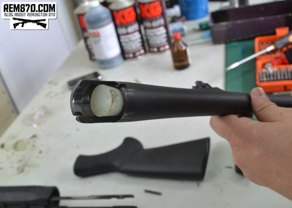

2. Protect internal surfaces of the magazine tube, magazine extension and barrel using plugs:
Protect internal surfaces with plugs

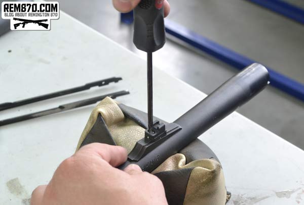

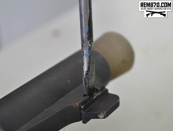

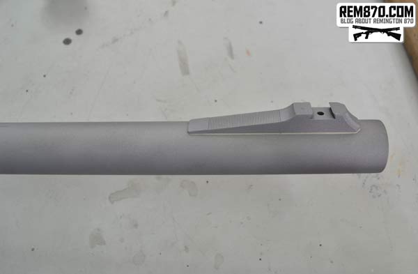

Remove sights:
Remove rear sight before sandblasting and painting
Remove front sight before sandblasting and painting

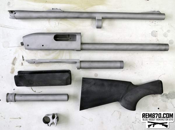

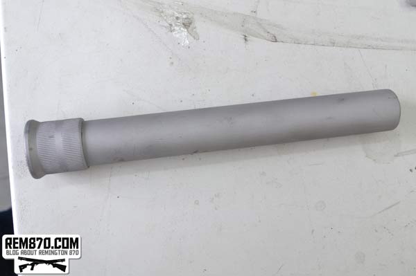

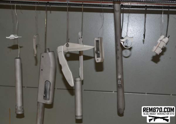

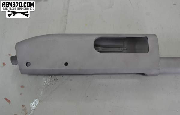

3. Remove old coating using sandblasting. Here’s how your Remington 870 parts are going to look like after sandblasting:
Remington 870 Parts After Sandblasting
Remington 870 Receiver After Sandblasting
Remington 870 Barrel After Sandblasting
Remington 870 Magazine Extension after Sandblasting

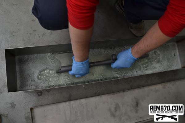

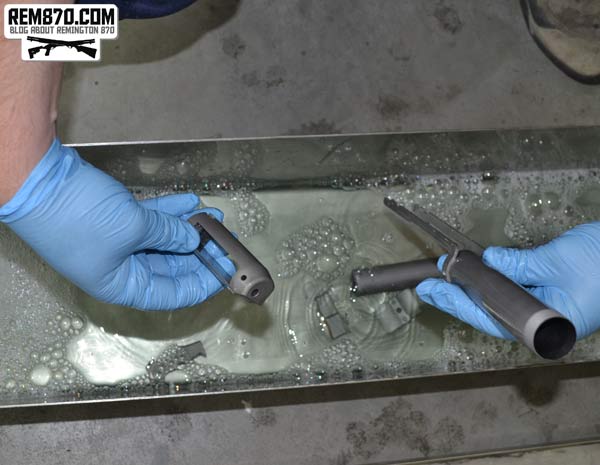

4. Degrease parts and put into the oven for 30 minutes:
Degrease Remington 870 Parts
Put Parts into the Oven for 30 Minutes
5. Let them cool.
Let them dry
6. Degrease parts one more time before painting:

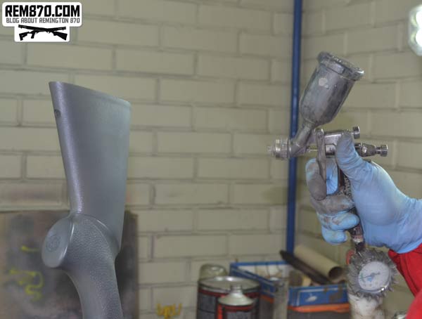

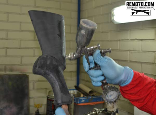

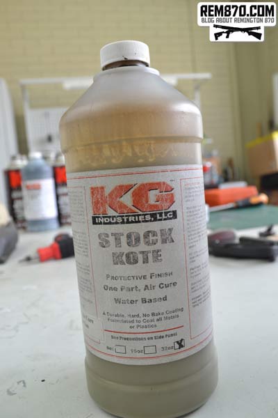

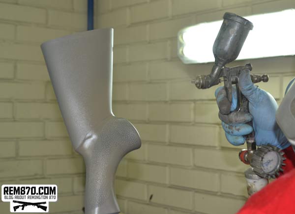

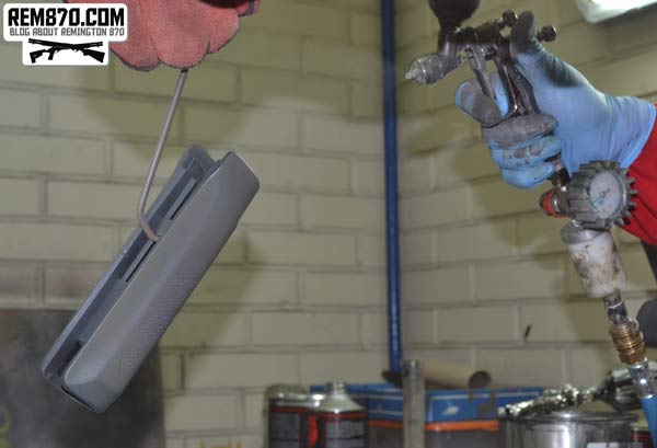

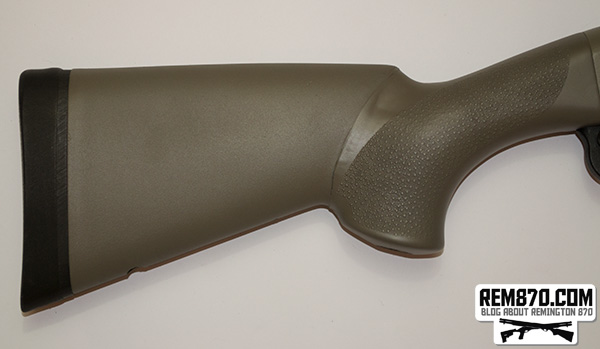

7. Paint stock and forend with KG Stock Kote:
KG Stock Kote
KG Stock Kote Flat Tan
Paint Stock with KG Stock Kote
Paint Forend with KG Stock Kote

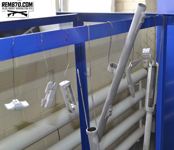

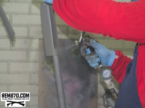

8. Paint moving parts with KG Gear Kote:
Painting forend assembly with KG Gear Kote

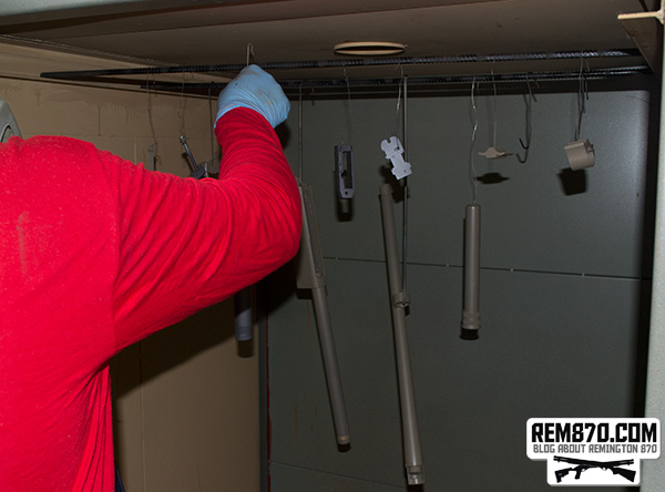

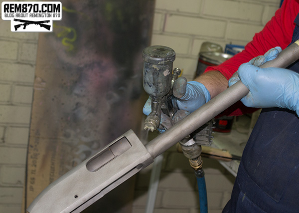

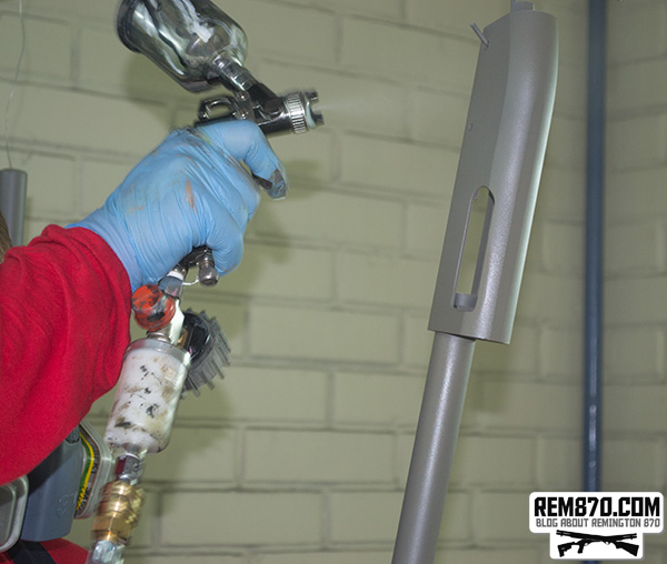

9. Paint other parts with KG Gun Kote:
KG Gun Kote
KG Gun Kote, Flat Dark Earth (Tan)
Painting Remington 870 Receiver with Gun Kote

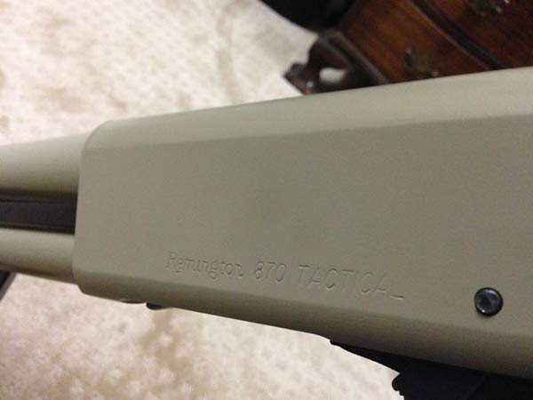

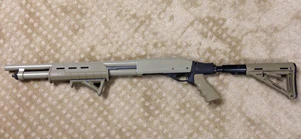

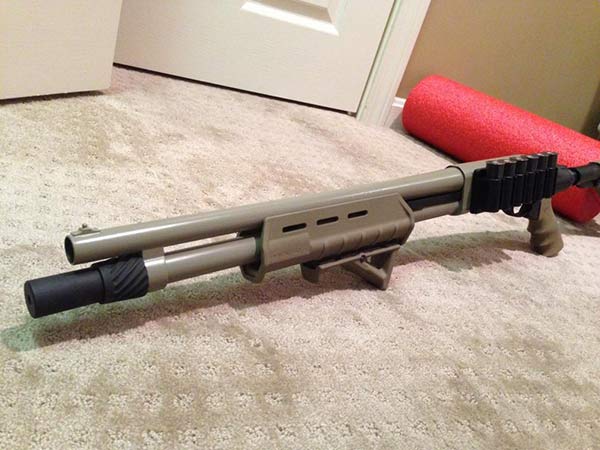

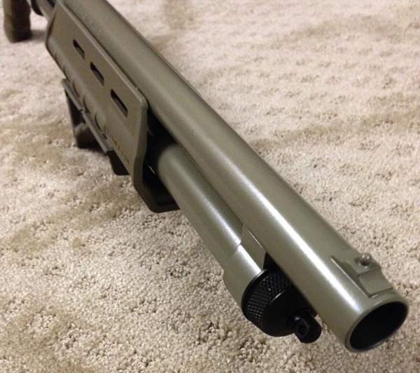

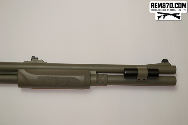

Final Result:
Remington 870 Parts Painted with Gun Kote
Gun Kote Painted Stock
Gun Kote Painted Remington 870 Receiver

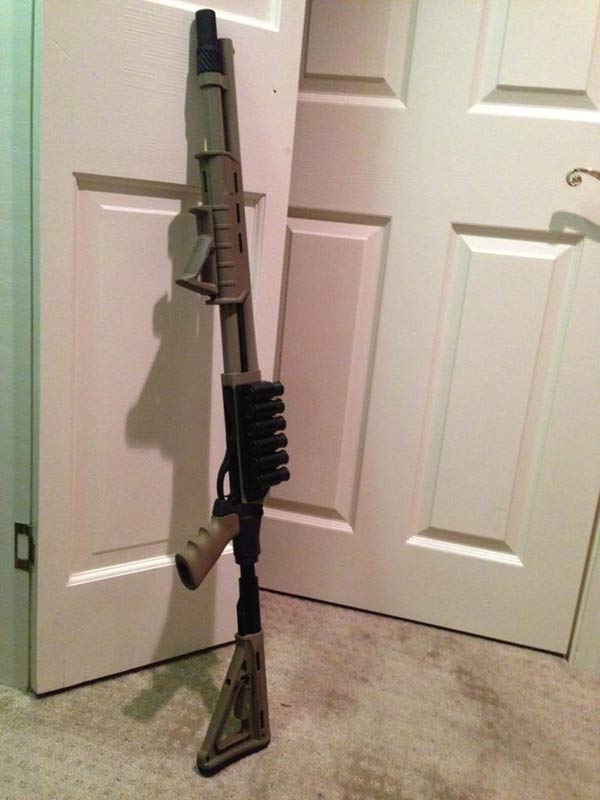

Remington 870 in Gun Kote Dark Flat Earth

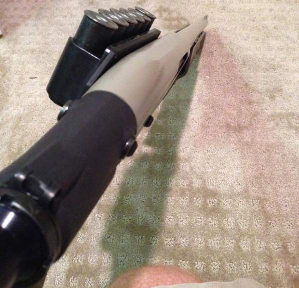

Just curious, how stock cote will live on Hogue stock? I think it can fall off after some time because of overmolded surface?
vanaheym, I will post an update after some time… Everything is ok after 2 trainings.
