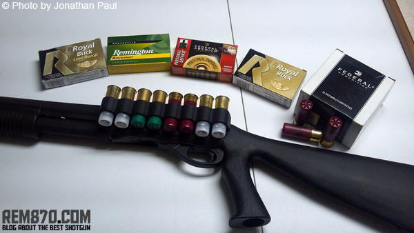

I would like to start off this review with a big thanks to Steven at BulkAmmo.com and Vitaly of Rem870.com for the opportunity to do this review. Vitaly put me in contact with Steven who provided most of the buckshot used in this review.
There are five types of buckshot that were evaluated for this review. Four of them were provided by Steven of BulkAmmo.com and one was from my personal stash. All 12 ga ammo shells tested were 2 ¾” 9-pellet 00 buckshot, the details of each are as follows:

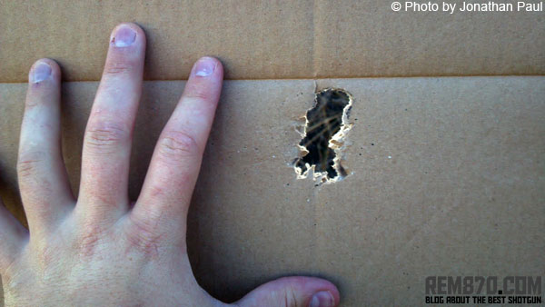

I tested the five loads at 3 different distances, 7 paces, 14 paces, and 25 paces. My target was a large piece of cardboard, covered with waxed paper when necessary to extend the usefulness of the target. The shotgun used was a Remington 870 with 20” improved cylinder barrel. The following table shows the results of firing one round of each type at each range and measuring the extreme spread:
| Load | 7 Paces | 14 Paces | 25 Paces |
Federal Ammunition – Buckshot** |
4 inches | 6.75 inches | 14.8 inches |
Rio Ammunition – Royal Buck Low Recoil |
4 inches | 9.5 inches | 10.6 inches |
Rio Ammunition – Royal Buck |
4.8 inches | 10.8 inches | 16.25 inches |
Remington – Buckshot |
3.3 inches | 9.3 inches | 14.2 inches |
Federal Premium Ammunition – Personal Defense |
1.5 inches | 3.1 inches | 5.75 inches |
As you can see the Federal Personal Defense with the FliteControl wad dominated the extreme spread test with 25-pace results that were better than any other type’s 14-pace result. Also of interest is the tighter pattern produced by the Rio Low Recoil when compared to the full-velocity Rio Royal Buck load.
