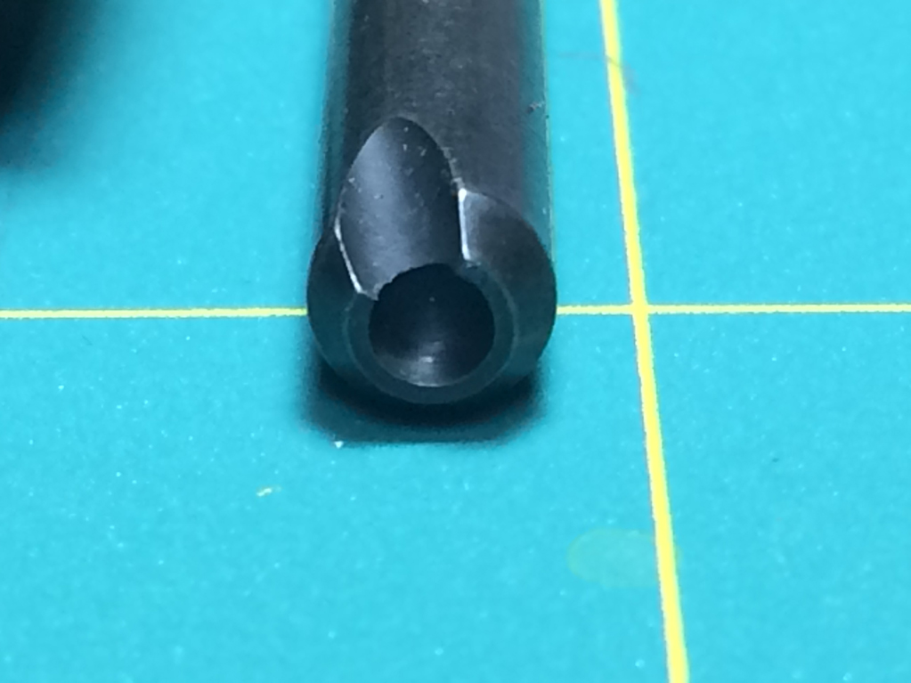

Detent staking tool

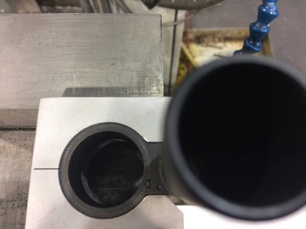

I made this barrel holding jig a few years ago to help hold and locate the barrel for drilling, tapping and installing a sight bead on the 870. The jig holds it by the support ring so you can hold the barrel in a mill vice without doing any damage to it.

The first thing is to mount a vice on the Bridgeport mill table with the jaws hanging over the side of the table so the barrel will hang vertical. Use an indicator mounted in the spindle to locate the center (zero) of the barrel support ring.

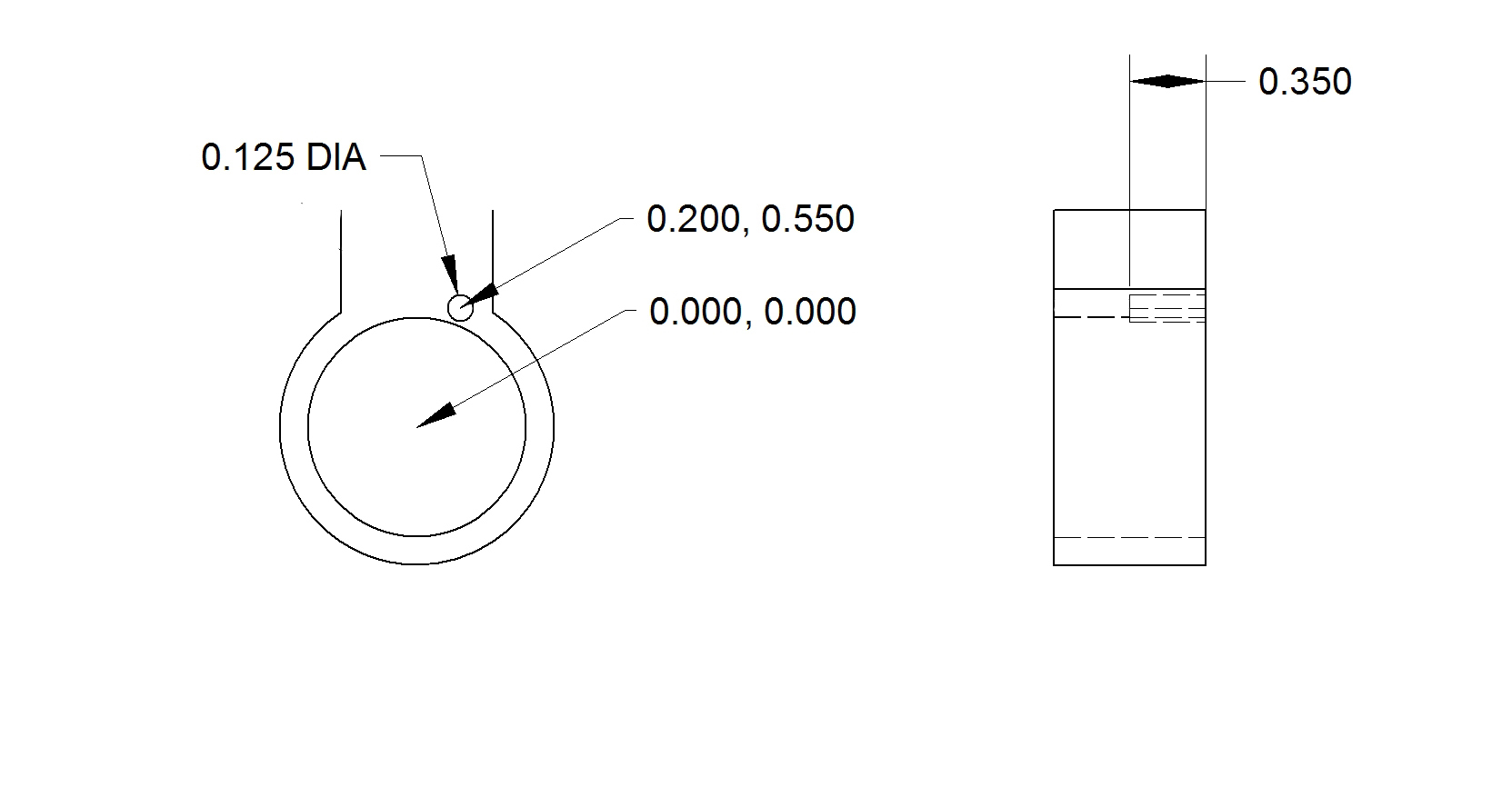

I made this drawing from an old Wingmaster barrel ring that I have.
After you find the center of the ring move the spindle to the locations on the drawing.
Use the spot drill and lightly drill a spot for the 1/8 drill.
Change out the spot drill with the 1/8 drill, drill into the ring .030-.040 deep, raise drill, and blow out the chips. Repeat this until the hole is
a little deeper than the length of the spring. A little oil helps with the drilling.I drilled mine about .350 deep

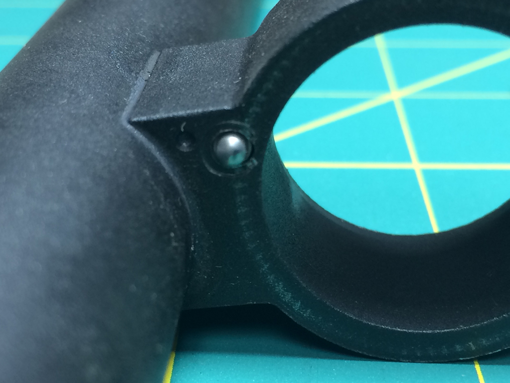

Clean out the hole, insert the spring and detent. Place the detent punch over the detent and push it down until the lips of the punch touches the ring,
Lightly tap the punch with a small ball peen hammer a couple of times or until the detent is secured in the hole.
I’ll post a picture of the finished part when I get the replacement staking tool. If it doesn’t end up with the other.
Staking tool
Staked detent:

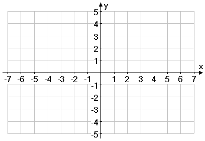

it just occurred to me that some may not understand the drawing. it uses the Cartesian coordinate system. You have two axis, X runs right and left and Y runs forward and rearward. The numbers forward and right are positive, the number rearward and left are negative. The center of the cross is zero. On the drawing X is the first number and Y is the second.
0.200,0.550 means 0.200 to the right (X), 0.550 forward (Y). in this case it is a 20 deg angle move
