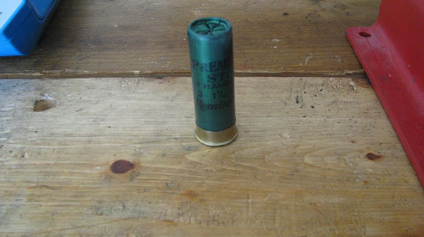

Unusual Malfunction Because of Reloaded Ammo on Semiauto Shotgun
I must share this photo:
![Unusual Malfunction on Semiauto Shotgun](https://www.rem870.com/wp-content/uploads/2015/06/semi_auto_shotgun_malfunction.jpg)
Primer fell off and blocked the fired shell. Shooter used reloaded ammunition. That is why you need to be careful when you reload your shotgun ammunition. I am not sure what was the problem but it happened several times. Maybe it was problem with primers, maybe too much powder.

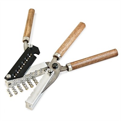

Buckshot Mould
Lee Eighteen cavity Buck shot moulds are available in 3 sizes: 000 Buckshot, 00 Buckshot and #4 Buckshot. Precision-machined moulds produce 18 linked pellets per cast, allowing one to easily cast over 2000 pellets an hour.

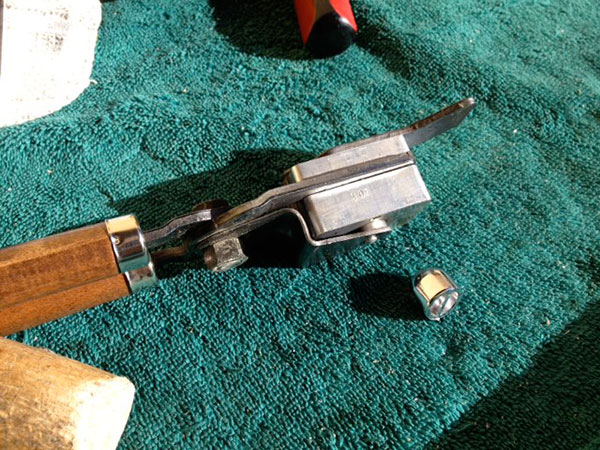

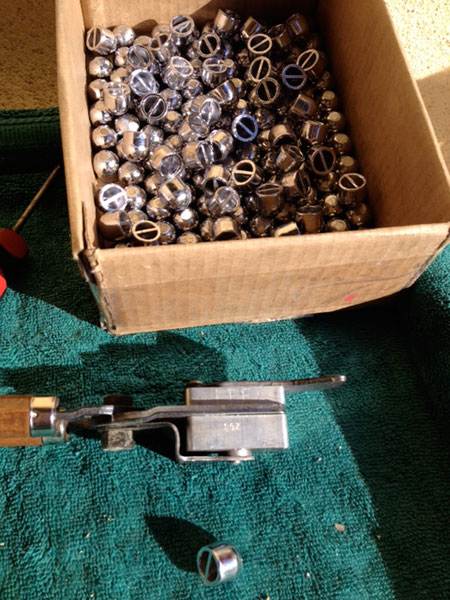

Slug Mold
Aluminum slug molds are inexpensive and you can purchase one practically anywhere for less than $50USD.
Mold for shotgun slugs; note the hollow core, which helps the slug maintain its balance by putting the weight on the end of the slug.
What you will need to make slugs using the pictured device is lead, welder’s gloves, facemask, a heat source, vessel to melt lead in and a small metal ladle that has a small slot for pouring. Make sure the vessel is large enough so you can dip a ladle in. You can purchase lead specifically for making your own ammunition or you can collect wheel weights from any junk yard or ask your local parts store.
You will notice once the lead begins to melt that junk will be floating on top, this is all of the impurities in the lead, such as dirt, and other contaminates. Ladle this to the side and scoop out. The liquid lead will be slight thicker than water in a molten state.
Close the mold tightly, place the slag cutter over the hole on top, and lock in place. You will be pouring the lead through the hole on the slag cutter, which will be lined up with the mold chamber. Dip some lead and make sure you have your gloves, facemask and safety goggles on. You have to move quickly so the lead does not cool. Pour into the hole until lead comes back out the hole, while pouring slightly jiggle the mold to remove air bubbles. Once full, slide the black bar away to cut off the slag. Open the mold and tap on the backside to knock the slug loose.

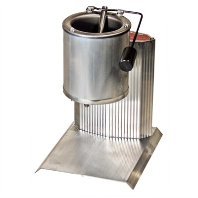

Lead Melting, Lee Production Pot IV
Large, deep pot holds approximately 10 pounds of lead. Melt time is less than 20 minutes. Pour spout up front where it belongs so you can see what you’re doing. Infinite heat control. Uses only 500 watts of power during heat-up and a lot less to maintain temperature. Large, stable base for safety. 4″ of clearance under the spout is high enough to accept all brands of bullet molds and most sinker molds. Melter is capable of reaching 900 degrees Fahrenheit.
You can get Lee Production Pot IV on Brownells |
How to Use Lee Slug Mold (Smoke, Lube, Cast Slugs)
Reloading is an interesting hobby which saves your money and makes you independent. You can even cast your own slugs.
![Lee Slug Molds, 1oz, 7/8oz](https://www.rem870.com/wp-content/uploads/2014/02/lee_slug_molds.jpg)

Hello Vitaly,
I do have some experience with the Lee 1oz slug mold in 12 gauge. I cast the slugs out of pure lead and load two different loads. The first load is the one recommended by Lee in the data sheet that comes with the mold. The load that I used was-
1 oz Lee cast slug
Hull-Remington STS 2 3/4″ Premier hull
Primer-Win. 209 primer
Powder- 38.5 gr. Accurate #5
Wad- Claybuster copy of WW12SL
The data sheet lists the velocity of this round at 1535 fps, I believe it! This round is meant for deer hunting, it is very powerful. I made a few boxes, I don’t think I will make any more. I was looking for a Cowboy Action style of slug load, something that was more like 1,000-1,100 fps. I asked a good friend of mine who is more experienced than me, he is a member on a few forums and he sent me this recipe. It is more like a light bird hunting load and is my go-to slug load now.
1 oz Lee cast slug
Hull- Remington STS 2 3/4″ Premier hull
Primer- Win. 209 primer
Powder- 15.7 gr. Clays
Wad- Claybuster #CB1100-12
Here are a few pictures of the Lee mold and slugs, and my reloading set up.
