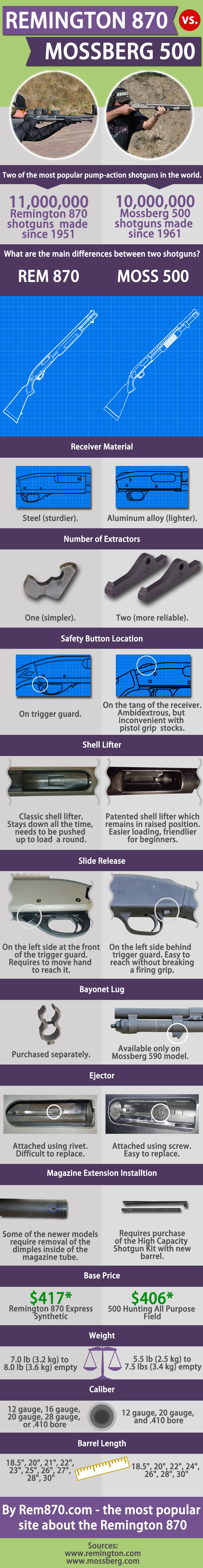

Infographic: Remington 870 vs Mossberg 500
Infographic which shows differences between Remington 870 vs Mossberg 500 shotguns.
Differences between Remington 870 and Mossberg 500
Two of the most popular shotgun models that gun enthusiasts love is the Remington 870 and the Mossberg 500. Both are top selling shotguns with similarities and differences. The similarities are they’re both pump action shotguns with dual action bars (Mossberg has just one but then Remington’s patent expired and they started manufactured Mossbeg shotguns with two bars). They are also cheaper than most other pump action shotguns, despite their simple design and versatility. Over 10 million shotguns have been made for each model type. The people who like to use them include hunters, military personnel, law enforcement officers, and home defenders. The best part about the guns is they can be configured in a lot of different ways. You can upgrade the barrels, choke tubes, extensions and more.
870’s Steel vs. 500’s Aluminum Receiver
As for the differences, there is an aluminum alloy receiver in the Mossberg 500 and a steel receiver in the Remington 870. This makes the Mossberg 500 a lighter shotgun that is easier to lug around.
Remington 870’s received is milled from a solid billet of steel making it indestructible. 870 is the only shotgun which received is still made of steel. All the other shotgun manufacturers are cutting costs by making aluminum alloy receivers. Benelli Supernova has plastic receiver with steel frame. This is another way to make inexpensive shotgun but it has some serious disadvantages.
Of course, steel receiver makes 870 a little heavier than Mossberg 500 but that’s not a problem.
Safety Button Location
Plus, the Mossberg 500’s safety is located behind the receiver, allowing the shooter to disengage it faster. It even makes it easier for left-handed people to shoot the shotgun as well. The safety in the Remington 870 is a small button located in the back of the trigger guard. This makes it a little harder to disengage it.
But Mossberg 500’s safety will be very inconvenient to use when pistol grip stock is installed.
Barrels
When you do fire each weapon, both can shoot birdshot or buckshot at a range of 40 to 50 meters, up to 100 meters with slugs. They both have interchangeable barrels. The barrel length can range from 14” to 30.” Barrels less than 18.5″ require Short Barrel Shotgun Tax Stamp from the ATF.
One Extractor vs. Two Extractors
Mossberg 500 has two extractors which is advertised to be more reliable. Remington 870 has one extractor. It is recommended to replace standard extractor with Non-MIM Extractor. and it improve the reliability of your shotgun.
Shell Lifter
Remington 870 has a classic shell lifter. Stays down all the time, needs to be pushed up to load a round.
Mossberg 500 has patented shell lifter which remains in raised position. Easier loading, friendlier for beginners.
Slide Release
Remington 870 has a slide release on the left side at the fron of the trigger guard. Requires to move hand to reach it.
Mossberg 500 has it on the left side behind trigger guard. Easy to reach without breaking a firing grip.
This is considered as advantage of the Mossberg 500 platform but it doesn’t really add any significant advantage to a shooter.
Bayonet Lug
Need to be purchased separately for the Remington 870. Mossberg 590 (more expensive version of the 500) has it.
Ejector
Remington 870 has ejector attached using rivets. It is difficult to replace but it can withstand thousands and thousands of rounds. So this is not something you are going to do often.
Mossberg 500 has ejector attached with screws. So it is easier to replace but it is not common procedure as well.
Magazine Extension Installation
870 Police version has old style spring retainer and you can easily install a magazine extension. Many of the modern 870s require removal of two dimples in the end of the magazine tube to install the magazine extension. This procedure isn’t difficult and can be done at home but it requires some tools, time and efforts.
Mossberg 500 requires purchase of the High Capacity Shotgun Kit with new barrel.
Advantages and Disadvantages
Both shotguns have their advantages and disadvantages. Both the Mossberg 500 and the Remington 870 are really popular among shooters. These shotguns are weapon of choice by hunters, military personnel, and law enforcement officers. A big reason has to do with the reliability and durability of the weapon. In a life or death situation, it would be important to have a reliable weapon like the pump action Remington 870 or Mossberg 500.
The Mossberg 500 is little cheaper than the Remington 870 because of its aluminum receiver and plastic parts. You can expect to pay about $200 for the Mossberg 500 and around $300 for the Remington 870. It isn’t that much of a price difference but to some people that $100 difference will mean a lot. The shotgun you choose should simply depend on your preferences.
It doesn’t matter if you want to just shoot targets for fun and hunt in dirty environments or you want a weapon for home defense or life-threatening situations, both shotguns will do the job!
