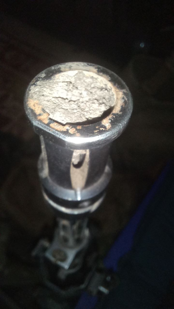

Around the fourth day at the position, I noticed that the compensator was clogged with dirt. I even had an idea to fire a shot and see what would happen. 😅
And I just remembered another problem (maybe it has been fixed by now): if it starts rusting, that’s it. No matter how much you clean it, the only option is to preserve it with oil.
The typical situation of entering or exiting positions in the photo (compensator clogged with dirt).😊

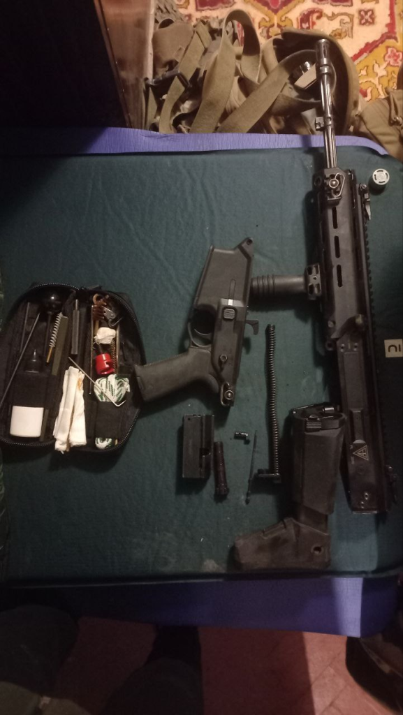

And of course, after returning from the field, a mandatory “meditation” session (cleaning). 🙂
