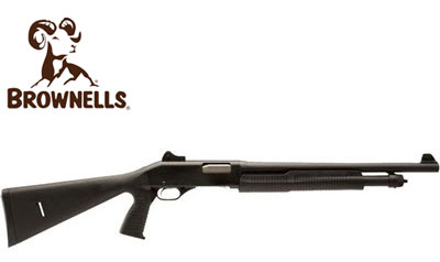

Savage Stevens 320 Security/Field
When I first took Savage Stevens 320 into my hands, the first impression was a cheap, budget gun.
The barrel isn’t chrome lined, so cleaning and maintenance are more time-consuming. The coating is good but it also looks very simple.
I had a Security version with an 18 1/2-inch barrel and pistol grip for my tests. The grip is thin and the stock is compact. I recommend trying it before buying. It may not suit shooters with longer hands. The field version has long 28-inch barrels. Field/Security combo comes with interchangeable 18 1/2- and 28-inch barrels. The more expensive Security version comes with a barrel shroud and a Picatinny rail on top of the receiver.
Ready for Red Dot Sight:
Barrel Shroud:
The action is stiff but maybe the shotgun needs some break-in time. The safety is soft and easy to disengage.
Bright orange magazine follower makes it easy to identify the empty magazine. Loading is very simple.
Made in China to make this shotgun as affordable as possible. Price starts from $229.99
