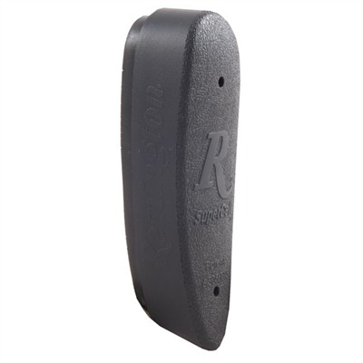

Remington 870 Supercell Recoil Pad
This is one of the best aftermarket recoil pads available for the Remington 870 shotgun. It really reduces felt recoil which makes shooting much more comfortable. It is made by Remington company and installed on many shotguns and rifles.
It is advertised to reduce recoil by 54%. I can’t say that it is really that good but I really like to shoot shotgun equipped with this recoil pad.

The SuperCell Pad:
Factory pad on the left, SuperCell on the right
Finally, I found the Remington SuperCell recoil pad. Manufactured by Remington, for Remington shotguns, it featured excellent reviews and, best of all, a price tag of just $20 on Amazon.com (meaning free shipping). I decided to give it a try, and placed an order for a SuperCell pad for synthetic-stocked shotguns (part # F301519).
Slight misfitting of pad at top (above) and bottom (below) of stock
Taking it out of the packaging, I could tell immediately that this pad was a step above the others I had looked at in sporting goods stores. There were no gel inserts, fancy layer arrangements, springs, pistons, or any other mumbo-jumbo. The SuperCell pad was a no-nonsense foam cushion with two holes for mounting screws and a rigid base shaped to fit into the butt of the stock. The surface featured a low-friction finish tastefully embellished with the Remington “R” on the butt and “Remington” on each side (these markings seem to vary between different SuperCell pads). Two new mounting screws were included in the package, which had wider heads than the screws for the factory pad, presumably to prevent tear-through with the different material (the wider heads also helped to retain the screws in the pad when it was removed). Out of curiosity, I threw both pads on my scale. Including the screws (since each pad used a different set), the SuperCell weighed 2.6 ounces, slightly lighter than the 3.4 ounces of the original rubber pad, but not by enough to appreciably alter the gun’s handling or performance. The old and new pads are essentially the same thickness, so length of pull didn’t change either.
Installation was very straightforward. Ensure the gun is clear (obviously), remove the old recoil pad with a Phillips screwdriver (a #1 or #2 size should be fine, no need for something fancy), insert the new screws into the SuperCell pad, install the SuperCell pad, and it’s done. The instructions suggest using water or oil to make it easier to insert the screwdriver into the small screw holes, but I didn’t find this to be necessary with my tools. Finding the head of the screw – recessed as it was into the soft foam of the pad – sometimes took a bit of fishing around with the screwdriver, but this wasn’t a major deal. Once on, the pad wasn’t a perfect fit with the stock. It was just a hair narrower than the stock in the middle, and sat a little high on the end of the stock, extending slightly past the comb on top and sitting just above the heel on the bottom. These misalignments were extremely small however, on the order of a few hundredths of an inch at the most, and had no effect whatsoever on the pad’s function (or even its aesthetics, unless one looked very closely).
Shouldering the gun after installation, the new pad felt great. The smooth surface slid across clothing without grabbing or sticking, but still stayed firmly in the pocket of my shoulder when I assumed a shooting stance. The pad obviously had more give than the hard rubber one it replaced, but it was still firm enough to keep the butt of the gun solidly in place against my shoulder. Even before firing the gun, I was already impressed by how the feel had improved.
Then I went shooting. I was floored by the difference the new pad made. With everything from light target shells to heavy 3” turkey loads and slugs, the gun just…behaved. There was no physics-defying disappearance of recoil, obviously. The energy and velocities involved were the same, and those heavy turkey loads rolled my shoulder back just as much as they had before; but the SuperCell pad transmitted the force as a firm push rather than a sharp jolt, and that made a world of difference.
A video of me happily shooting 3” magnum slugs with the SuperCell pad while visiting my parents and younger brother can be found here:
