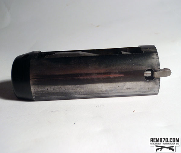

1. Disassemble your Remington 870/1100 shotgun and take out breech Bolt:
![Remington 870 Breech Bolt Remington 870 Breech Bolt](https://www.rem870.com/wp-content/uploads/2012/11/remington_870_breech_bolt.jpg)
