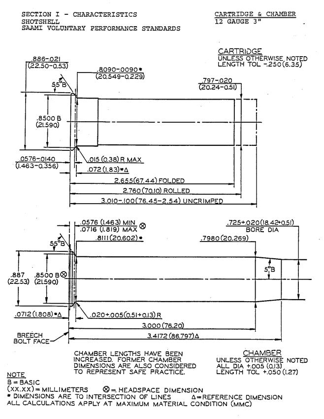

Re: Failure to extract - forcing cone fouling
I don't think the forcing cone is what caused your extraction problem. Assuming your gun has a chamber manufactured to spec, a 76mm shell shouldn't unfold beyond it into the forcing cone (unless your gun actually has a 70mm chamber, but I think you would have noticed that).
Cartridge & Chamber Drawings - 12ga 76mm (3") - SAAMI
12ga 76mm SAAMI drawing.JPG (87.26 KiB) Viewed 6861 times
You seemed to imply that this is the first time you experienced this problem. If this is an isolated incident, my guess is that shell just happened to be a bad one that either ran at too high a pressure or had some manufacturing defect that made it over-expand. I had the same thing happen awhile back with a heavily-loaded Fiocchi hull. It wedged itself firmly in the chamber after firing, and I tore the rim trying to extract it, just like you show in your picture. I needed to use a cleaning rod to knock it out.

Yes, you are right Synchronizor. I checked the actual start of the cone and it starts aprox 10.5cm into the bore (~4.1in), so the shell would not be able to touch that area even after unrolling. And looking at the shell casing now in more detail, it's actually visible that the texts imprinted on the shell have partially come of indicating it has been extremely tight in the chamber from the sides after firing (comparing it to the unfired cases texts).
