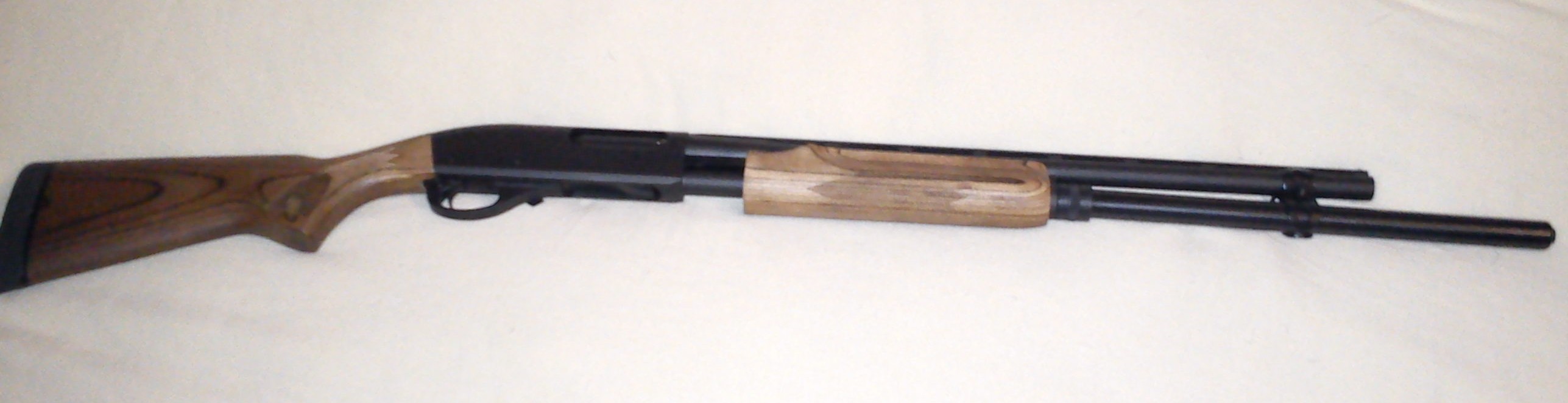

OK, I recieved the magazine extension today and was lucky enough to be able to install it after dinner. Gypsy had one of her 'chick flicks' to watch, so that freed up my evening considerably.
I have been doing research on how to install the extension over the last week or so and was confident I could do it without much problem. I have an extesive background in mechanical and aerospace engineering, so I know my way around a fairly wide variety of tools. Confidence was very high to be able to complete the task without much difficulty, and for the most part, things went very smooth.
I chose to utilize the drilling out of the dimples instead of the genuine Remington magazine tube fixing tool because I simply do not have one. YET. I do have a drill press, though, and had the dimples drilled out in no time at all. It took me longer to set the work rest up than it do to do the drilling. After that, I pulled out my trusty Dremel and ground off the sharp edges around the holes, then polished everything smooth. I used the original spring follower to ensure there were no burrs remaining. I ran a blue towel down the inside of the magazine to remove any debris and began to reassemble.
Here is where the bump in the road came to play. Using one hand, I carefully slid the bolt/carrier/forend tube assembly back over the magazine, guiding it back into the receiver to correctly align with the shell latches. Using my other two hands (??????) I pressed the shell latches away and slid the tube assembly in. The problem is that I don't have three hands and the fingers I have on my two hands are too large to work in the confined space of a 20 gauge receiver. After several failed attempts, I did manage to get it back together by placing the forend agaist my work bench and using only my middle fingers to squeeze the shell latches apart. I'm sure with practice it will become much easier. I replaced the barrel and continued with the installation of the extension tube with the supplied spring unaltered.
I did a quick check of the action to ensure everything was moving as required, then proceeded to load the weapon. As I do not have any dummy loads, I used live ammo. With the safety on, finger off the trigger and the weapon pointed in a direction to only blow a hole in the side of my shop and consequently my old truck outside, I loaded 10 rounds into the magazine. As the spring compressed, the tension increased, but not so much I had to force the last couple of rounds in. I was still easy enough for my wife to be able to load. 10 + 1 using 2 3/4 shells.
See the file below for the finished product.
remington 870 Express youth 20 gauge with Choate 5 round extension
Tha magazine hangs out past the muzzle 5 inches. Looks kinda morphydite, I know, and I am not certain I wish to keep it this way. A three round extension would be better, but there is something about an 11 round shotgun I find appealing. Gypsy has viewed it with less than favorable comments, most notably the fact that it will no longer fit in her 44 inch Bulldog gun case. But she does like the thought of having 11 shots, so her feelings are mixed also.
Perhaps this is an opportunity for a future custom build more to my wants/needs. Another 870 20 gauge in an adult size which can handle all the standard 12 gauge furniture. Get it with a 26 inch barrel so it looks cleaner with the extension, then adapt either a folding stock or a pistol grip to keep the overall length down.
BUT...thats another day.
Let me know what you think.
Re: What is the difference?
Zebra62 wrote:I chose to utilize the drilling out of the dimples instead of the genuine Remington magazine tube fixing tool because I simply do not have one. YET. I do have a drill press, though, and had the dimples drilled out in no time at all. It took me longer to set the work rest up than it do to do the drilling. After that, I pulled out my trusty Dremel and ground off the sharp edges around the holes, then polished everything smooth. I used the original spring follower to ensure there were no burrs remaining. I ran a blue towel down the inside of the magazine to remove any debris and began to reassemble.
That's a good way to do it, and I believe it's the method taught to Remington-instructed armorers. There are tools sold that take care of the detents by pressing them out, but it's very easy to damage the magazine at the point where it's brazed to the reciever if you use them wrong (which, not encouragingly, is how the product advertisement videos show them being used...).
If you didn't already, you should use some bluing acid or other finishing product to touch up the bare metal where you did the drilling and grinding.
Zebra62 wrote:Here is where the bump in the road came to play. Using one hand, I carefully slid the bolt/carrier/forend tube assembly back over the magazine, guiding it back into the receiver to correctly align with the shell latches. Using my other two hands (??????) I pressed the shell latches away and slid the tube assembly in. The problem is that I don't have three hands and the fingers I have on my two hands are too large to work in the confined space of a 20 gauge receiver. After several failed attempts, I did manage to get it back together by placing the forend agaist my work bench and using only my middle fingers to squeeze the shell latches apart. I'm sure with practice it will become much easier. I replaced the barrel and continued with the installation of the extension tube with the supplied spring unaltered.
When you insert the fore-end tube, bolt, and slide assemblies back into the receiver, they will only contact one shell latch at a time. Press in one, slip the fore-end back a fraction of an inch, then press in the other, and slide everything the rest of the way in.
Zebra62 wrote:Tha magazine hangs out past the muzzle 5 inches. Looks kinda morphydite, I know, and I am not certain I wish to keep it this way. A three round extension would be better, but there is something about an 11 round shotgun I find appealing. Gypsy has viewed it with less than favorable comments, most notably the fact that it will no longer fit in her 44 inch Bulldog gun case. But she does like the thought of having 11 shots, so her feelings are mixed also.
You should have her try quickly pulling it out of the closet/gun safe and moving around the bedroom with it. There's a reason HD and CQC shotgun builds tend to favor compactness over magazine capacity. A sidesaddle or even a $5 shell loop cuff on the stock would still let her keep the same amount of ammo handy.
Zebra62 wrote:Perhaps this is an opportunity for a future custom build more to my wants/needs. Another 870 20 gauge in an adult size which can handle all the standard 12 gauge furniture. Get it with a 26 inch barrel so it looks cleaner with the extension, then adapt either a folding stock or a pistol grip to keep the overall length down.
A shotgun with a pistol-grip only is difficult to aim consistently. I have one for just playing around, but there are few practical roles where I'd want to have it instead of my traditional police stocks.

Thanks for the tips.
We have an outting planned for the morning with the bluing acid on the list. I saw it one of the videos I previewed earlier this week. I need to pick up a real cleaning kit for it also. I have been using blue shop towels and a wooden dowel to swab out the barrel on our trips to the range. Not the suggested method, but it works.
Figured that out after my fourth or fifth attempt, then slapped myself in the forehead. DOH!!! Felt like Homer Simpson. Went together like it was supposed to after that.
Gypsy has actually been doing this already on her own. Not with the extension, yet, as it is newly installed. But she will. She likes the extra rounds and has already negated a side saddle. Seeing how well she does with the extra length will be the deciding factor of either leaving it on until I can get a shorter extrension or going back to the original load capacity. That and how many pings it gets when we are at the range tomorrow.
True that. My Mossberg Cruiser that I carry when I am out in the field is mostly for deterant purposes. Oil field hands are a strange bunch and can get pretty uptight when thier rigs aren't running and I am the guy who goes out to fix them. I haven't had to shoot anyone with it, but I have pulled it to keep from getting my butt kicked. I have a range bag full of bird shot and a bandolier full of 00. Its a bit awkward to try slugs. Need a full stock for those.
