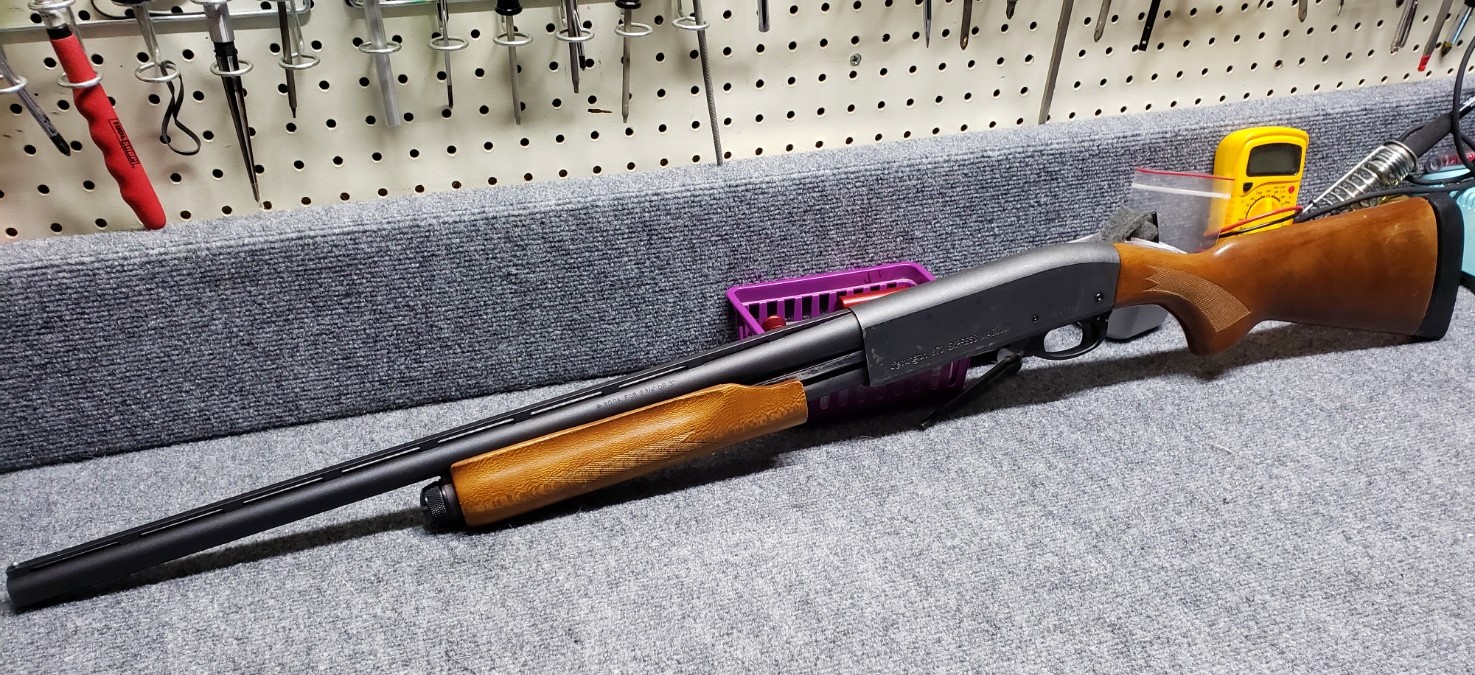

Hi All,
I started the conversion of my 870 into a home defense shotgun this weekend,
I swapped out the furniture this weekend for the Hogue setup. Really happy with the results.
I use Hogue for my handgun & Airgun grips also.
I'm having an issue with the Forend nut not tightening all the way.
It's close but can't seem to get it to fully torque down. This leaves a tiny
amount of play. The shotgun racks just fine, but want to get rid of the slop.
I'm headed to the hardware store later today to see if I can find a washer to take
up the slack. I'm wondering about an O-ring as a solution.
Curious to hear if anyone else has run into this issue?
I'll update once I find a solution.

- 870 Wood.jpg (458.56 KiB) Viewed 38989 times
