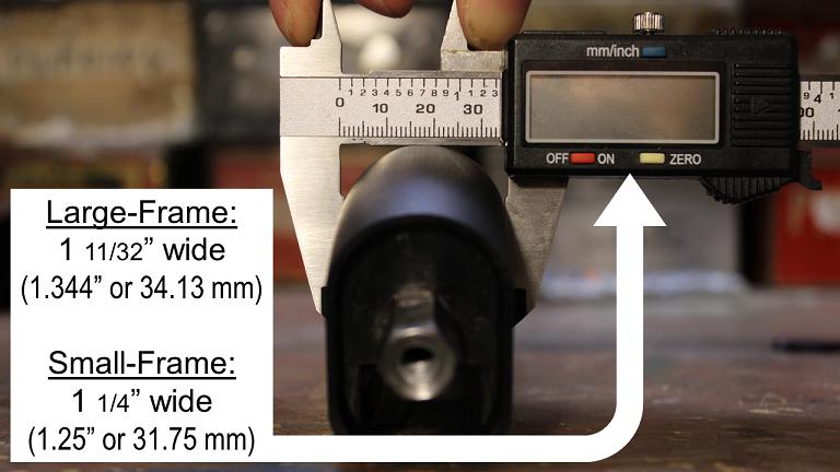

Make sure you know if your 870 is an older large-frame 20ga or a newer small-frame model. That'll make a difference for the trigger plate assembly.

Re: Are trigger plate assemblies interchangeable?
You can tell from the serial number, but Remington's changed up the serial number system for the 870 enough that that's not as simple as it used to be. The most straightforward method is to measure the receiver:
If you don't have a good way to measure though, I can get into the serial number thing.

I've determined that I've got the thicker reciever; but now I've got another question:

Years ago I bought a used 870 20 ga designated LW, chambered for the 3" shells, in mint condition. Manufactured in 1984, it has the smaller receiver, 1 1/4" wide. Research has me thinking that my gun and all the other scaled-down 20 gauge models were designed by engineers who exploited the smaller receivers used in a "family" of long guns including 28 gauge shotguns, and some of their center-fire canons like the 742, 7400 and 7600. It's easy to see why the engineers would have ; they were thus able to introduce a gun that was well-suited for youth and ladies of small stature without as much re-tooling as would have been necessary had they not already been manufacturing guns with small frames, so to speak. Prior to the advent of the LWs, 20 gauge guns were basically the full-sized 870s but with a smaller barrel and magazine tube. (if anyone reading this post knows more detail, like whether the bolt and shell elevator were scaled down also, I'd like to know.) Plus who wouldn't like a 20 that can shoot a 12 gauge load--even if it kicks like a mule. I remember when the LW went into production--Remington's tag line was something to this effect: "We started with a 20 gauge shell and built a gun around it."

If it has an X or N at the end of the serial number it is a 12ga framed 20.
It just means you can use a 12ga stock on this gun. Trigger groups should interchange with a 12ga. Nothing else really.
