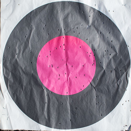

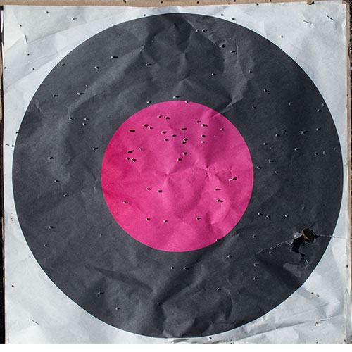

Tested rifled choke with birdshot today. Distance was about 15 meters (about 16,5 yards) to test spread.
- Rifled choke
- rifled_choke_birdshot_15meters_1shot.jpg (56.85 KiB) Viewed 8405 times
- Cylinder choke
- cylinder_choke_birdshot_15meters_1shot.jpg (49.06 KiB) Viewed 8405 times
