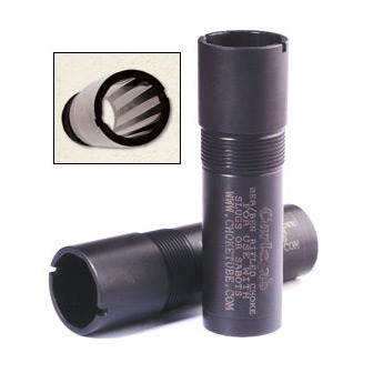

I’ve bought a rifled choke a lot of time ago. Finally, I have tested it on the range today. Rifled choke is believed to stabilize a projectile in flight giving it a spin and better accuracy.
Rifled Choke for Shotguns

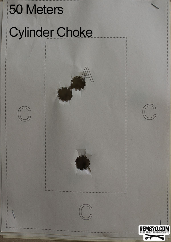

First try with regular Cylinder choke:
Shooting Slugs on 50 Meters with Cylinder Choke

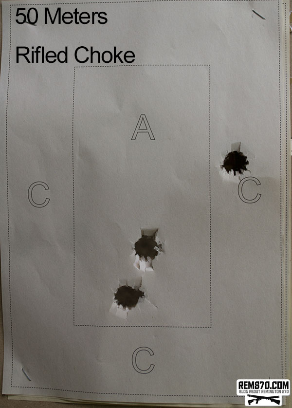

First try with rifled choke:
Shooting Slugs on 50 Meters with Rifled Choke

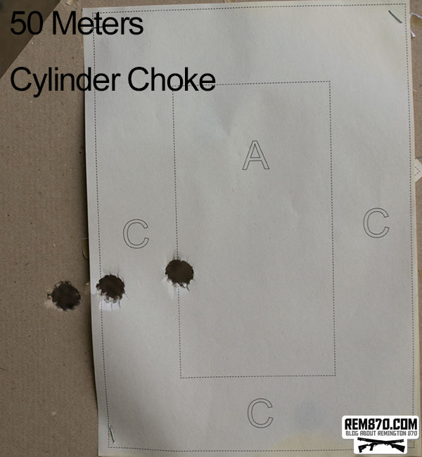

Second try with regular Cylinder choke:
