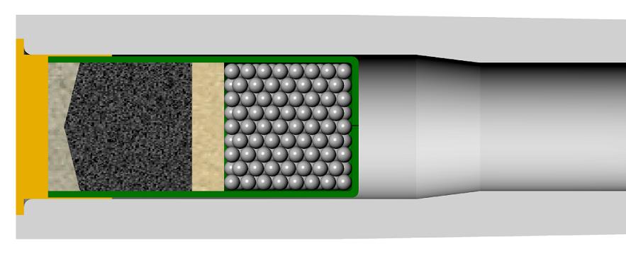

Remember that advertised shell length - 2.5", 2.75", 3", 3.5" - refers to the unfolded length of the shotshell after it's been fired. Before firing, a shotshell will almost always be shorter due to the crimped front end. Shotgun chambers are sized to fit the shell in its unfolded state to provide the the payload with a straight path into the barrel, so there'll be extra room in front of an unfired shell that's the same length as the chamber.
shotshell and chamber.JPG (35.41 KiB) Viewed 8178 times
When crimped, 3.5" shotshells are usually around 3" long, so they'll fit in a 3" chamber, but if you fire the shell, the crimped portion of the hull will be forced to unfold into the forcing cone (the tapered section ahead of the chamber that transitions between the wider chamber and the narrower barrel bore), partially obstructing the path of the payload and potentially causing dangerous spikes in chamber pressure. This isn't helped by the fact that 3.5" 12ga shotshells have a higher maximum pressure limit than other 12ga shotshells; standard 870 barrels with 3" or 2.75" chambers aren't designed for those pressures even without the added effect of obstructions in the forcing cone.
