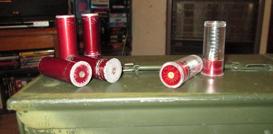

Anodizing helps with wear resistance, but given how my "hard-anodized" snap caps stand up, I don't see that thin oxide coating providing enough added strength to prevent long-term damage to a heavily-used magazine follower that is slammed into the steel stop at the rear of the magazine tube over and over.
Snap Caps.JPG (67.82 KiB) Viewed 5947 times
As for price, $25 may not be a ton of money, but it's a lot to pay for a magazine follower. Even high-priced aftermarket followers don't get much more than $20, and there are plenty of decent options in the low teens. Heck, the factory plastic followers are perfectly serviceable, take up less space in the magazine tube than anything with a tail, and I can get six of them for less than $25.

Good points. I have those same snap caps and they show a lot of wear already after only a month or so of occasional use.
