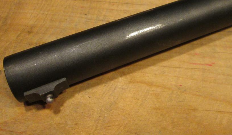

Re: Cleaning 870 Express Tactical
dtjacob wrote:I will try to CAREFULLY remove the clamp......
It's not that difficult; just take the screw all the way out, and the clamp should slide off pretty easily. If you need to, just use your fingers to pull it open a little further.
This will prevent scratches between the muzzle & the clamp's installed location, but you're eventually going to see the finish under the clamp start rubbing off as it flexes during installation & removal, and also as things shift around under recoil.
Barrel Wear_bracket_01.JPG (53.17 KiB) Viewed 6211 times
This isn't much of a cosmetic issue, since the clamp covers it up when installed, but it can be a corrosion risk if you get caught in the rain or something, and water gets under the clamp. To help protect that spot, wipe on a thin coat of oil before installing the clamp, and don't give water a chance to sit under there if your gun gets really wet.
