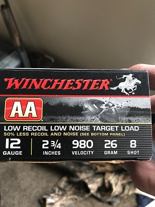

My Walmart is stocking these now, I tried a box today and if recoil is bothersome these are the cure; not for semiauto's, pump or break action only.
- unnamed.jpg (54.16 KiB) Viewed 15676 times

If I had a WalMart ..... just was in my Sportsman's Warehouse today and didn't see these. Will keep looking too.

Yeah, I've tried those. Very low recoil, anyone physically capable of holding the gun should be able to shoot them just fine. Another good option for low-recoil practice and fun - especially if you handload - is 3/4-ounce loads. They're more standard-velocity for target loads (1150 - 1300 FPS range), but with the lighter shot charge, they have about the same recoil level as the Winchester 26-gram (roughly 15/16-ounce) load. The Winchester 26-gram, 980 FPS and my 3/4-ounce, 1200 FPS loads feel pretty much indistinguishable in my 870; if you compare the squares of the two momentum figures, they're within 0.3% of each other.efriedrich wrote: Sun Jan 21, 2018 2:22 am My Walmart is stocking these now, I tried a box today and if recoil is bothersome these are the cure; not for semiauto's, pump or break action only.
I like these faster 3/4-ounce loads because they duplicate the ballistics of your normal target loads, so you can practice with them for less recoil fatigue, but still deal with the same range, drop, & lead considerations. The patterns aren't as thick, obviously, but you can just choke down a little and they work fine, especially if you're looking to improve your skills. If you can break a clay with 3/4 of an ounce of shot and a Modified choke, you can definitely score a hit using 1 1/8-ounces and an IC or Skeet choke. Also, they're super cheap to reload, since they use very little shot and just a pinch of fast-burning target powder.
