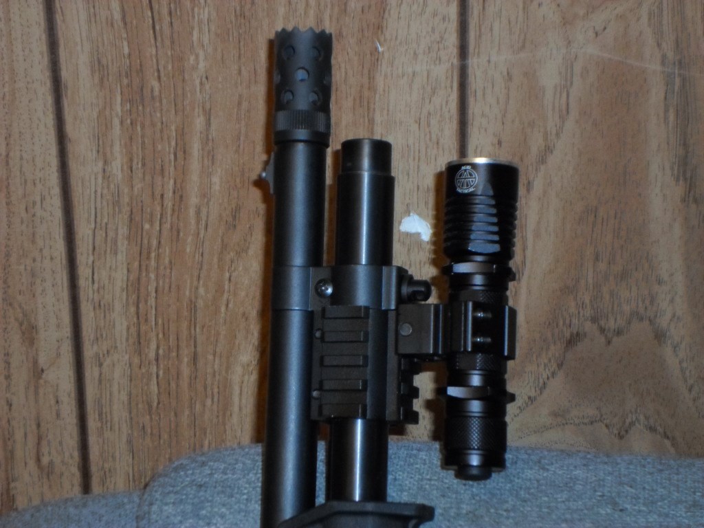

I currently have a Remington 2+ shot mag tube extension kit, I am not liking it at all. I am looking for one the ratchets on if possible does not need a clamp and is still like 1" in diameter,due to I have a Tacstar mag tube 3 way rail mount for my flashlight. Every time I shoot the clamp screw comes loose the head is so badly worn out from trying to tighten it that I cannot get any other Phillips head screw driver to fit on it to tighten it proper. I just want to get one that works better but is still the same size in diameter as the Remington tube. If any one has any suggestions. I so far have only tried ATI there's are to wide for the mount.
Thank you for all your replies
Here is a pic of the mount I am taking about. I like the mount but not the mag tube. Writing Remington to see if there is anything they can do about it.
SAM_0792 (Copy).JPG (180.24 KiB) Viewed 6618 times

I just ordered a Nordic Components MXT +3 mag tube extension kit. I'll let you know how it performs under recoil with their barrel clamp. The new MXT line does have a groove on the mag tube that the barrel clamp sits in. The Nordic clamp is also double wide compared to that Remington. I ordered my clamp with the single rail option. We'll see how a side mounted light works...otherwise, I may look for some sort of tri or bottom rail mag tube clamp. Not sure if your tri-rail mag tube light mount would work on the Nordic tube though. The overall diameter of the Nordic tubes is 1.06". The Nordic tube would also be a little lighter...made of aluminum. Personally, I wouldn't run an extension tube without a barrel clamp. Just added assurance that the mag tube coupler threads are protected if it's banged around. Especially true with an aluminum tube...I would never consider not running a barrel clamp. Other opinions may and will vary.

I have a Tac Star +2 one piece extension on my HD 870 and its made of steel. I use a tri rail mount for my light like yours and it fits and works perfectly. It also has the wratcheting base which has never loosened even after several boxes of shells at a time. Never had a problem with shells feeding either. Wilson Combat makes a nice steel +2 one piece extension that is very well made, wratcheting base, plus a wave washer for those barrels without the ball detent. Pretty cheap too, $45 plus shipping directly from Wilson Combat and that includes spring and hi-vis follower.
