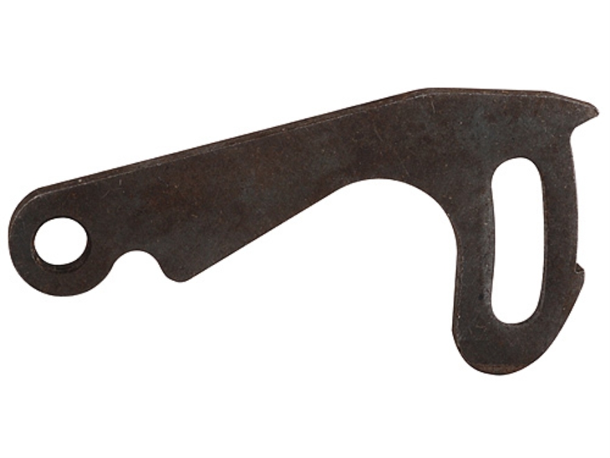

Quick qustion. I do a lot of Slug competition shooting (popular in my country), and I am always ending up second to another Rem870 (old 21" Slug Wingmaster Model). I spoke to the Guy & he told me that he has also upgraded the Firing Pin Hammer to the TC Trap version. Its a part readily availbe in the US.
It is lightened, and thus much faster !!
Before I proceed & order one, can anybody tell me if its an exchangable part for the 870 Express model. I have also send this question to Remington and am awaiting their response. Just thought somebody might have already tried it.

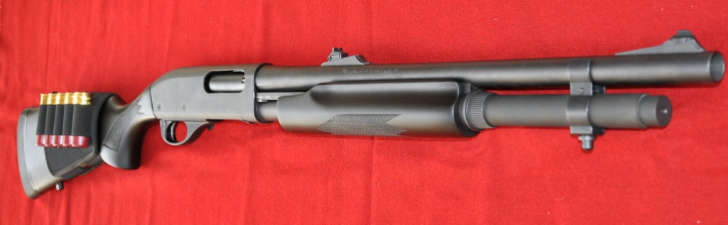

- My Gun
- DSC9178.jpg (123.44 KiB) Viewed 5698 times
- The Original Version
- Original.jpg (18.55 KiB) Viewed 5698 times
- The TC Trap Version
- tc.jpg (113.92 KiB) Viewed 5698 times

The pin hole, striking face, and sear & hammer plunger notches all appear to be identical. Remington's parts list also lists only one type of sear for the 870. A call to Remington to confirm would be smart, but it should be interchangeable. Speaking of Remington, they have that hammer listed for just $12 from their customer service department (not sure how the differences in shipping work out, though).teo2000 wrote:Before I proceed & order one, can anybody tell me if its an exchangable part for the 870 Express model.
To be honest though, I don't think a skeletonized hammer by itself is really going to make much difference, if any at all. I could sit down and calculate exactly what the inertial reduction would be between the two, but I doubt it'll be real significant, and a pump shotgun isn't exactly a precision instrument to begin with. If you secretly switched the competition hammer in your rival's shotgun with a standard one, I would be very surprised if the match results changed in any perceptible manner.
As I understand it, a lightened hammer is one of those competition upgrades that's about splitting hairs at the top of the spectrum, and it's usually just one of a large number of minor refinements made to serious (and seriously expensive) competition guns. I don't think it'll hurt anything, but if you're trying to really fine-tune things, you may want to first look at a lighter sear spring, smoothing your trigger pull, and maybe pinning your barrel to the receiver for more consistent shots.

Re: Remington Hammer 870 12 Gauge TC Trap Upgrade
Got an official reply from the Remington help desk via e-mail:
Question:
Will a Remington 870 12 Gauge TC Trap Hammer (Remington #: F91736) work in a Remington 870 Express Deer Gun, instead of the original. This is the lightened Trap version and I wish to use it in my competition gun.
Answer:
The hammer will fit with no problem. The only concern may be is if the weight is enough to reliable fire magnum loads if using the Trap hammer in your deer gun. Using the hammer from the deer gun in the Trap model should cause no issue.
I thought the lighter hammer might cause problems with harder primers if it wasn't hitting the pin elastically enough, but it's odd that they specifically called out magnum shells, which use the same primers as non-magnum shells (as far as I know, at least).teo2000 wrote:The hammer will fit with no problem. The only concern may be is if the weight is enough to reliable fire magnum loads if using the Trap hammer in your deer gun.
