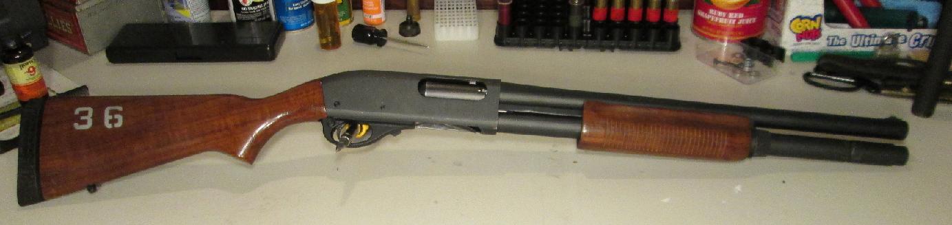

I just so happened to have my shotgun in this configuration:
18.5"/+2
18.5"/+2

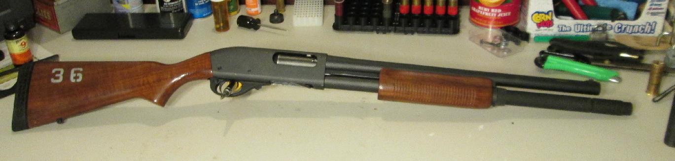

So, here's the same thing with the +2 magazine extension tube swapped out for my +3 tube (these are Remington extensions):
18.5"/+3
18.5"/+3

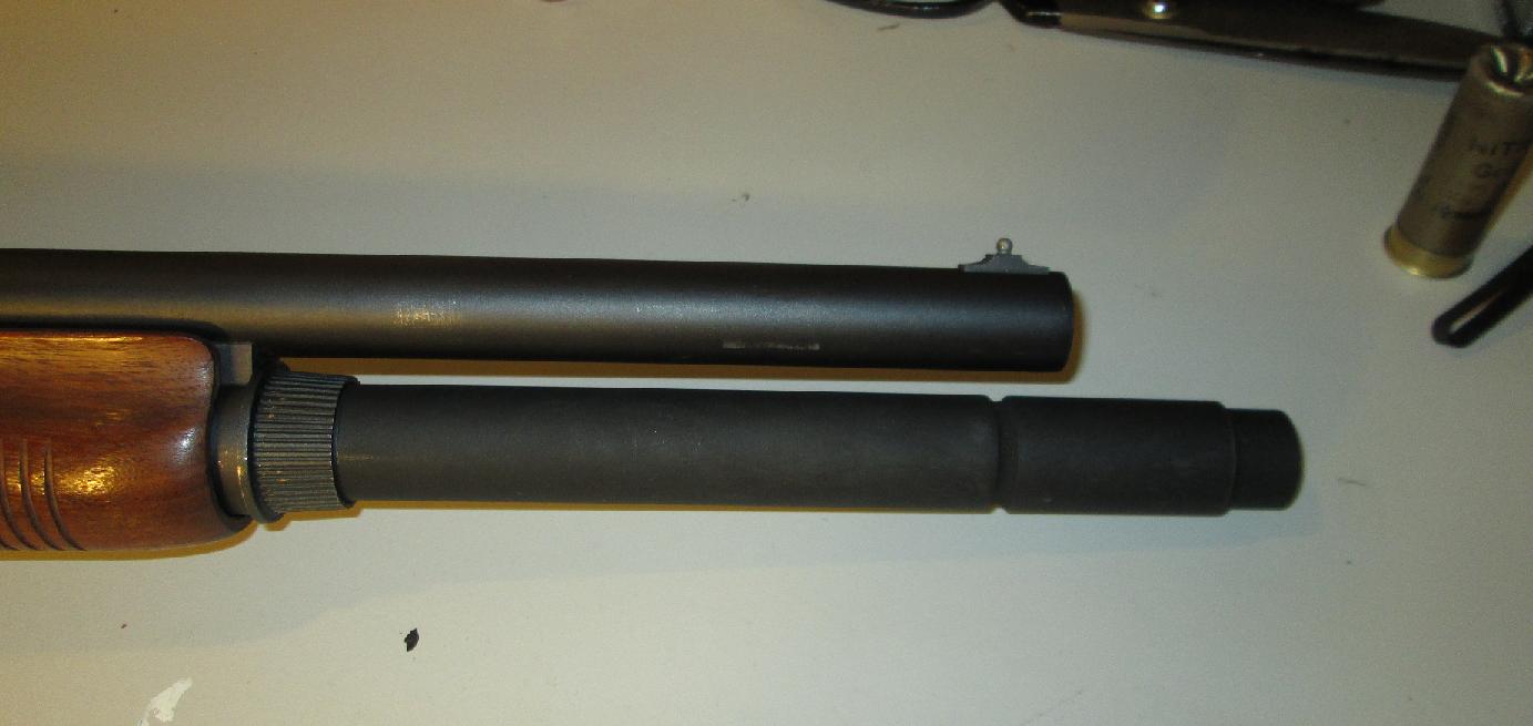

18.5"/+3 Close-Up
18.5"/+3 Close-Up
Again, I apologize for my camera's horrid depth of field.
I don't think the only issue with an extension tube being significantly longer than the barrel is asthetics. You won't be shooting up the extension until you get really extreme, but the setup won't be easy on the tube's finish. Another issue is durability. When your mag tube length is the same as (or close to) the barrel length, if you accidentally whack a door frame or piece of furniture with the gun, the much stronger barrel will take most of the hit. If your mag tube is sticking out another 2-3" or more, the same impact could bend or dent the tube, and completely disable your magazine's ability to feed shells. Obviously, unlike in these pictures, a mag tube on any kind of combat/defense build should be clamped, but the mag tube will still have this vulnerability (especially one of the less robust aluminum extensions a lot of people seem to prefer).
I believe there are several good reasons you usually only see mag tubes longer than barrels on competition guns.

Thanks for the pics and excellent thought on the extension sticking out. I'll stick with the +2.
