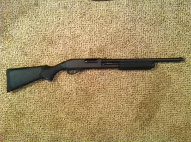

Here's a quick picture of my 870 with an S/N startign with RS as well as the LE stamp on the left hand side of the barrel.
Thanks!
KJ
Thanks!
KJ

I couldn't locate a P or Police on it. I expected that I might see Express, but so far only the SN and the barrel stamps of CYL and LE.
