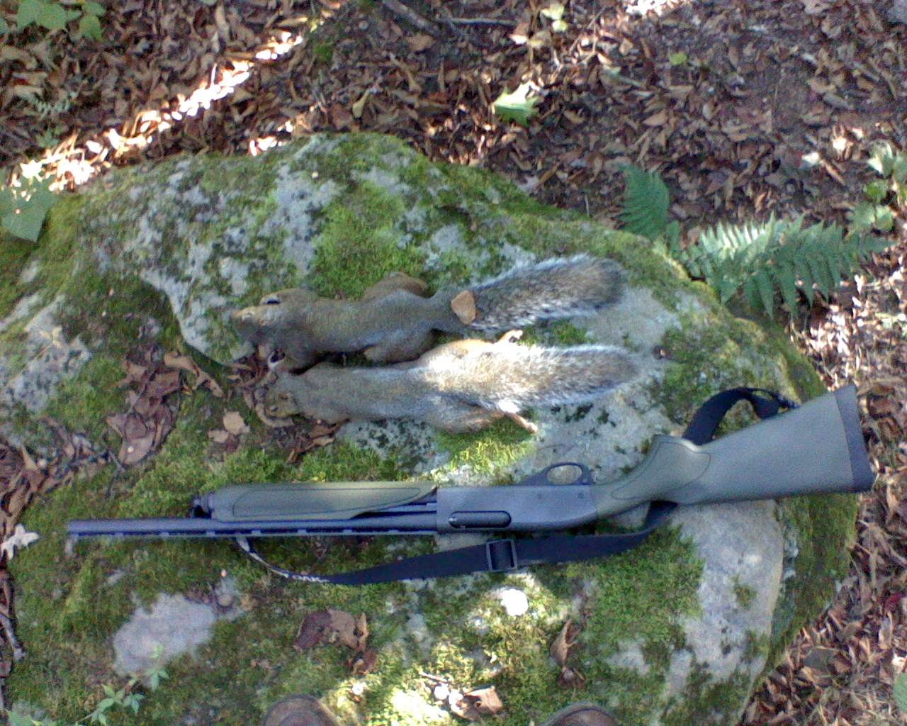

Just wanted to update if anyone happened to cross this post again. This season I used my 18 inch barrel with a mod choke, 7/8 and 1 oz loads of number 6. Smacked every squirrel I shot at and hit them good from 5 feet to about 40 yards. I had lost a little confidence in this set up because of the lost squirrel the first time I took the shorter barrel out. But it was pretty much a fluke. I did use my 12 gauge a few hunts and had success but I was using 1 1/4 oz of 5 shot because I have a surplus of WIN 540 that needs to be used and that was the load weight I could find for it. Not bad but mangled a few quarters on some squirrels up close and the weight of any 12 gauge can't compare with the rem 870 20 gauge with synthetic stocks and an 18 inch barrel. This gun just simply rocks as a squirrel getter...as long as you get within 35 or 40 yards.
- 1003150856a.jpg (223.41 KiB) Viewed 11124 times
Re: 18 inch barrel performance for hunting
Thanks for the update. That sure looks like a handy little package, glad you've got it working for you.
