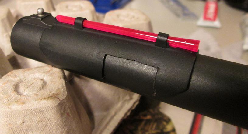

Is there a HiViz replacement for a front bead with no rib? I have this barrel http://www.brownells.com/shotgun-parts/ ... =767000957
Re: HiViz replacement for front bead?
HiViz and others make replacement fiber-optic front beads, but you'll have to pull/drill out your existing bead and tap the hole to accept them.
If you want something easier, you can buy high-vis sights that simply snap onto the barrel in front of the existing bead:
hiviz front sight red.JPG (42.11 KiB) Viewed 5537 times

Synchronizor wrote:HiViz and others make replacement fiber-optic front beads, but you'll have to pull/drill out your existing bead and tap the hole to accept them.
The factory bead isn't threaded in?
Some are threaded, some are press-in. If you have an Express barrel, it's most likely pressed in.
Malpaso
Posts: 27
Joined: Wed Apr 16, 2014 11:37 pm
Location: New England
Post by Malpaso »
Just checked with Remington CS, and the bead on the F242243 barrel is threaded. Looks like I'll be ordering the Spark II for it. Thanks for the reference.
