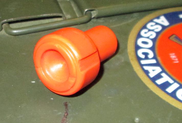

Re: Best aftermarket follower - S&J?
I haven't had a chance to personally test one yet, but I would tend to lean toward S&J's Type 3 follower. The Remington factory extensions were designed to use a cup-style follower, and while you probably won't lose any capacity with a solid-bodied follower, pushing one of those all the way up to the follower stop will tend to compress the spring past its solid length, which isn't a good idea with the narrow-diameter Remington extension springs.
S&J Follower_C.JPG (47.03 KiB) Viewed 14071 times
I have an S&J Type 1 that I've modified to essentially be a Type 2 (I prefer the orange color), and I really like it, but ever since I did the math & measuring on the Remington extensions & spring, I've gone back to using a factory cup-style follower when I'm running one of my Remington extensions. I'm planning on ordering an S&J Type 3 at some point, but I've got a lot going on right now and limited spending money. I've also been holding off partially in the hope that they'll start offering it in the orange color like they do the Mossberg version. The factory followers are perfectly good parts anyway, I have no problem trusting them to work and work reliably, I just like how the S&J followers make it easy to tell by touch when the magazine's empty.
