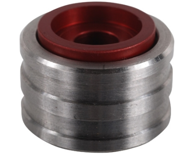

I am just wondering want is a good follower for the Choate +3 Mag tube kit. I am getting one here soon and have read not to many good things about the one that comes with it. I have a GG&G stainless follower (see pic) will this one work with the Choate +3 mag tube kit better than the one with it. If anyone has any suggestion on other followers that you have used in this mag tube kit, thanks for the information and replies.

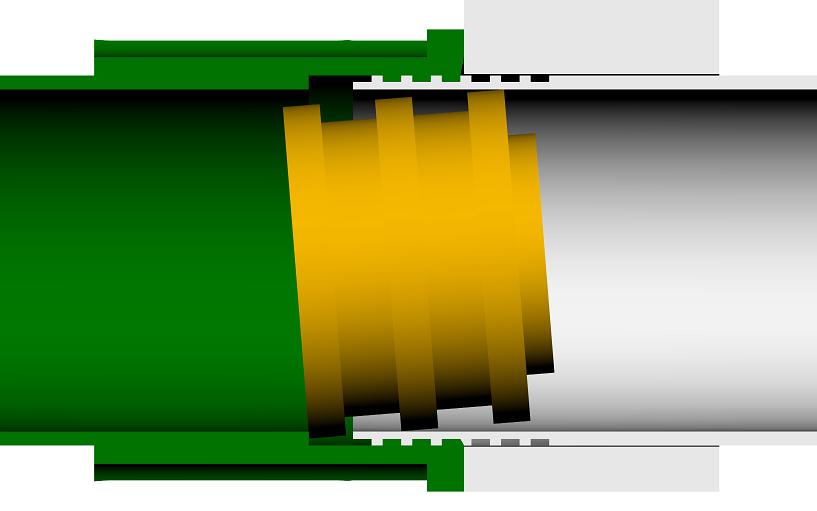

Is the Choate extension a single-piece? Followers with a triple-bearing-band shape are not the most reliable choice for magazine configurations that have gaps in the tube. Whenever one of the end bands is unsupported, the follower is able to cant inside the tube to a much greater degree, making it more likely to hang up.
BB Follower.JPG (24.76 KiB) Viewed 4366 times
The Vang Comp stainless steel follower uses a similar bearing surface design, and when I induced canting during testing with Wilson Combat & Vang Comp extensions (both of which are single-piece designs), it hung up so frequently and severely during simulated loading that I couldn't even examine its snag propensity during feeding because it was impossible to get it past the transition.

I use Vang Comp follower with Choate mag tube. I had to polish sharp edges to have smooth feeding, after this - everything was ok.
