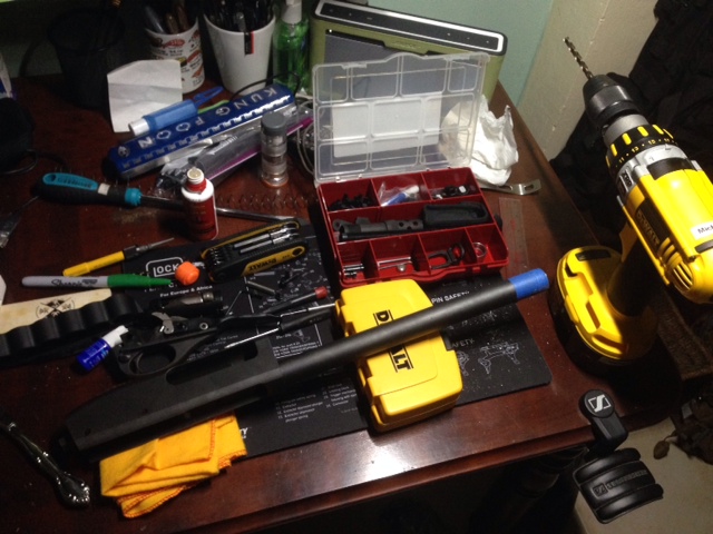

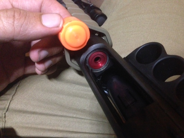

Hey folks, finally got some time to work on it so I thought I'd just leave an update of everything. So I managed to hear back from Nordic and what they told me was that the spring should be placed in the magazine and from the end of the magazine extension (end cap off), should be no longer than 16" and if you would like less tension to gradually cut it down from there. Forgot to ask them what the shortest recommended length was however. So with that information I finally got to work on it, I proceeded to drill out the dimples and install the tube from there with no issues, dropped in a GG&G follower, installed the spring and snipped off the excess, capped off the extension and threw on a Magpul forward sling mount. Additionally, by cutting the spring I also realised the excess is just as long as the original factory spring that came with my 870 so I now have a spare spring for a 4 shot magazine. Everything seems to be in working order, I ran some snap caps through it after the install and it was feeding just fine. Friday I managed to fire the gun for the first time and aside from one occasion with a slight hangup with the spring somewhere in the magazine tube (slight tap to the side of the gun fixed that) it performed great, however, I will keep an eye on that. The only other issue I experienced was the action locking up, however I doubt that had anything to with the extension but more with the machining marks in the chamber that I read on, so I have another thing to add to the to-do list. Anyways, even though my experience with everything is limited, so far I'd have to say I'd recommend this, the design looks great, weight is minimal and construction feels solid. No regrets on this purchase at all aside from the fact that I probably should have gone with the +3 extension tube, but thats no fault of the product of course so I'll be looking into getting the tube only next time I'm buying.
Drilling out the dimples.

New GG&G follower.
New GG&G follower.

Missa_Chin wrote:Friday I managed to fire the gun for the first time and aside from one occasion with a slight hangup with the spring somewhere in the magazine tube (slight tap to the side of the gun fixed that) it performed great, however, I will keep an eye on that.
That hang-up is more likely due to the follower, not the spring. Triple-bearing-band followers like the GG&G or Vang Comp can be less reliable than other types when it comes to dealing with the joint between magazine tubes & extensions. I would suggest putting your factory follower back in and seeing if you can replicate the jam.
