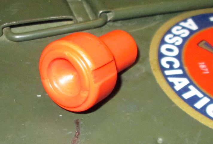

By the way, have you had any issues with that post in the center of the follower? My S&J follower originally had a center post like that, and it kept cracking open the crimps on my HD shells and making them dump buffering all inside my gun.

It wasn't really a matter of round count. I experienced the opened crimps with my HD shells after they spent some time in the gun and were unloaded/reloaded several times. I was using Estate 2.75" buckshot (00B & #4B) at the time, other brands may be more resilient. Still, it annoyed me enough to remove the post and dish the follower so it was still easy to detect by touch, but wouldn't mess with crimps or overshot cards. Again, thumbs up for quality polymer followers that can be easily modified.
