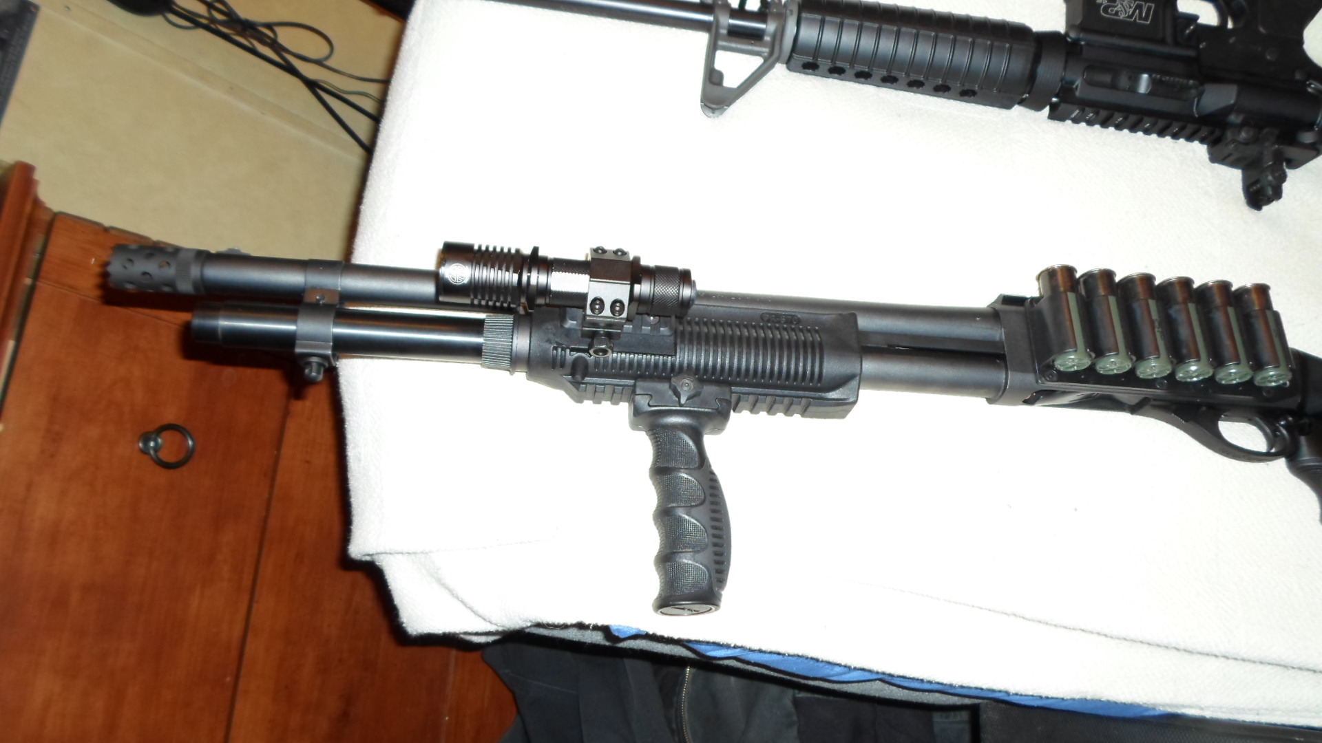

I have a CAA Commander arms forend grip mounted to the bottom rail of my 870. The forend is a Mako fab defense PR-870 3 rail with the 2 sides removable, I did take them off and thought it looked ugly without them. My ? to all is will using a detachable forend grip on a pump shotgun going to cause slide rail damage or any damage to the pumping action of the SG. The one I have on it is kinda long and I want to put on something else like a Magpul VFG vertical forend grip. Not sure if it will fit onto my bottom rail mount saw a video on youtube and the install failed on my grip.
Here is a pic of the forend grip, will this do any damage to my gun with use, I have never shot a shotgun with one before always used the forend to load this tactical shotgun is new to me but yet the same.

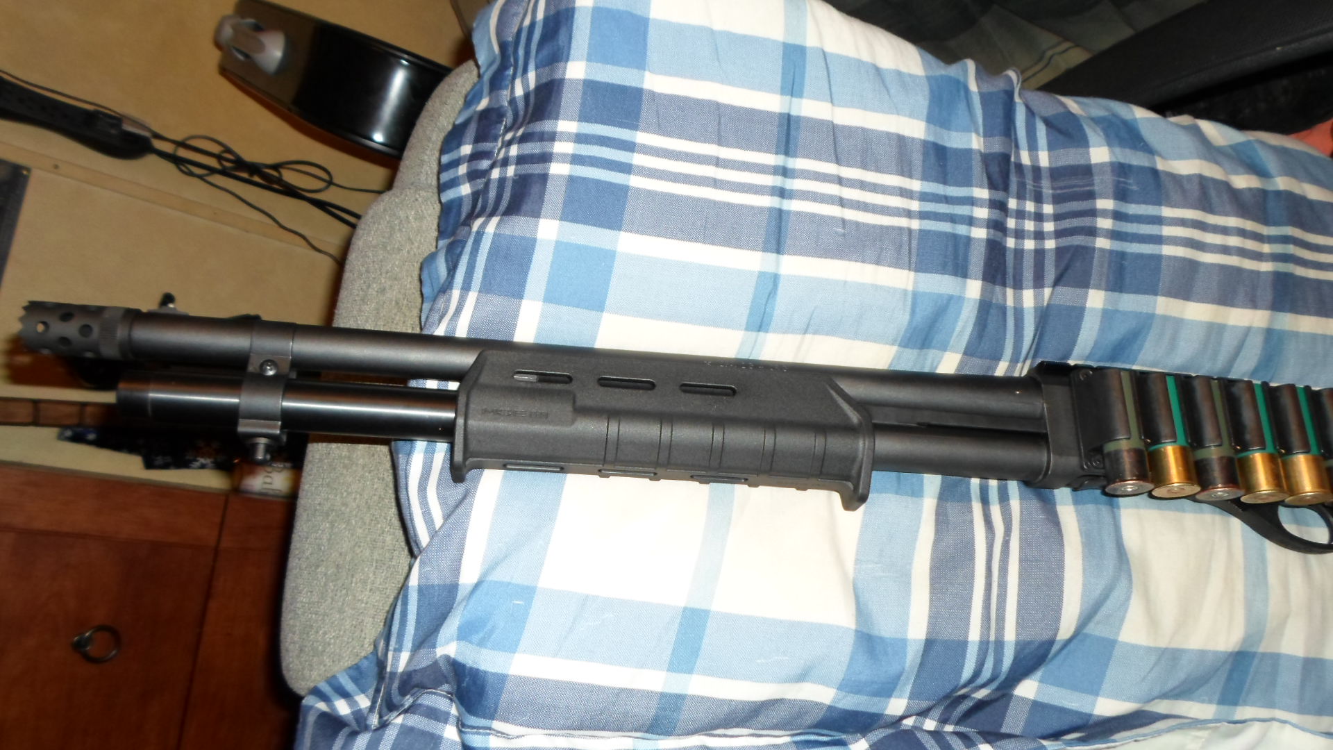

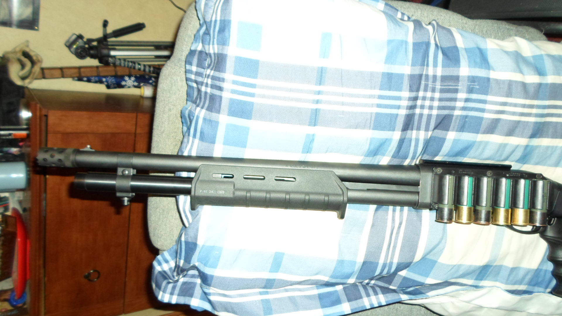

Thanks all for your advice, in which I took, I have only shot this shotgun like only with 6 shells through it, no more. I have put on a different forend a Magpul MOE forend. Will give some pics of it.
I can notice since I have been practicing with dummy shells and racking that shotgun with the grip on it for like 4 months I can tell after installing the Magpul that the arms look a little bent, not horrible or anything but you can see a slight bow to them.

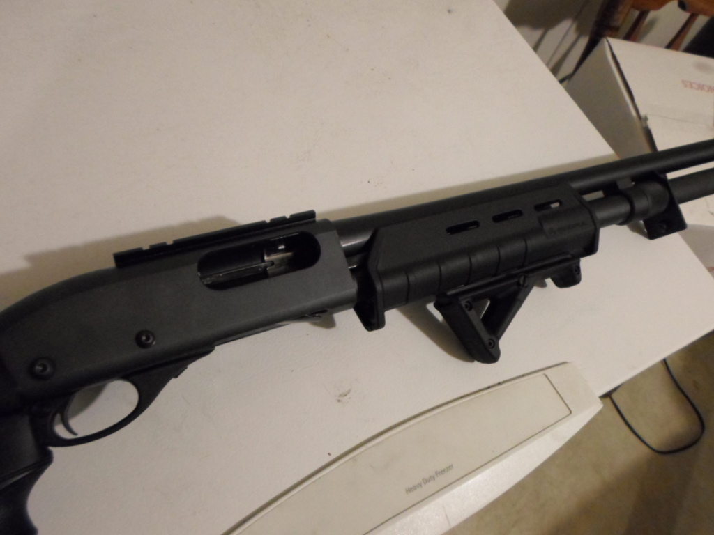

I am only putting on a flashlight on it now and going with a standard hand pumping to load the shotgun. I have thought about those Angled forend grips that Magpul makes but not to sure about them either on a shot gun since they look to be mainly targeted to the AR platform, if anyone has any info on using a AFG on a pump shotgun let me know please would love to read you input on this.
Here are some pics
Here are some pics

12GAFun, i had the same setup as you had withe the Fab fore-end and vfg. Well, i soon learned that that combo is not really practical and i went overboard and was myself going for the Tacti-coool look. I even convinced myself it handled better that way. Long story short, it was a mistake and waste of money, and yes it does put more stress on your action bars and can bend them. I now prefer a more standard kind of fore-end, big time; it's more comfortable and no muss-no fuss bs-lol.
Here's a pic of my way "Over Board Setup", and hopefully a cautionary tale to anyone who sees this. Don't go this route. I've learned that Less is better on a shotgun. Just my opinion though.

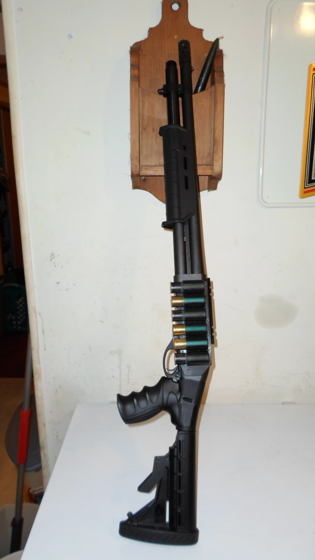

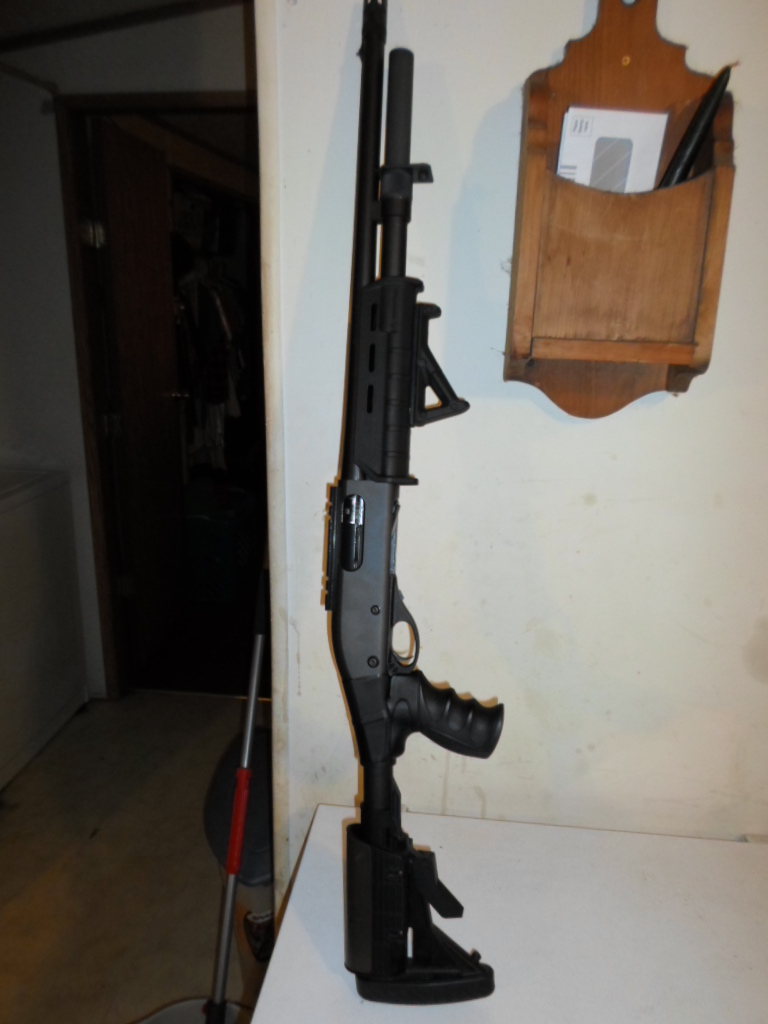

Yes sir I agree, I went with this instead and it works great.
- 024.JPG (241.58 KiB) Viewed 9286 times
- 016.JPG (250.09 KiB) Viewed 9286 times
Re: Attachable Forend grips
That looks really good and is a pretty nice functional setup. I've got all magpul furniture on my 870 and am considering adding an AFG2. I've already bought a couple dif Magpul rails, i just haven't got my AFG2 yet; i'm kinda looking at an Inforce Tac Light too. I want a tac light. and the Inforce is very light weight and good quality light. I like the way it mounts too. I'm still debating whether to mount it on a 2" rail on my MOE Forend, or buy a CMD-BMT Clamp/Mount. How does your gun handle and shoot with that ATI Stock installed? Just curious...
