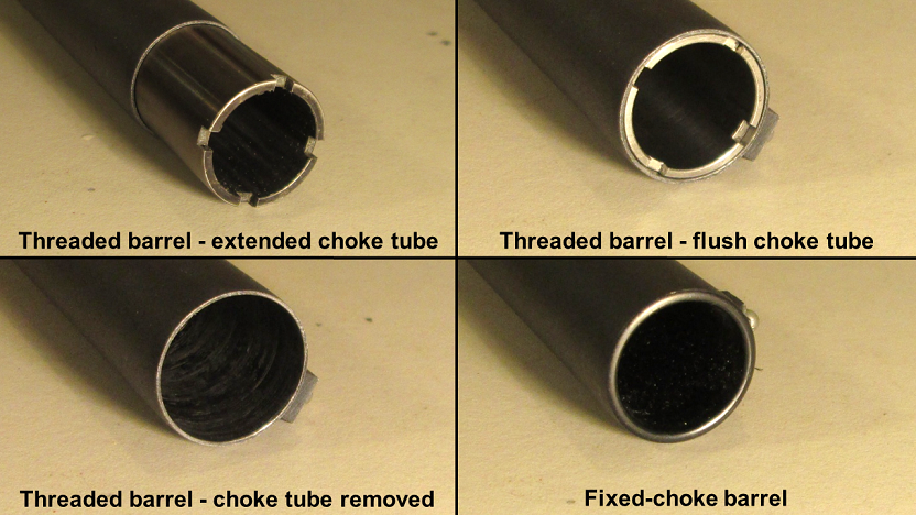

Zoogleboogle wrote:Also - I've only kind of looked… does my 28" come with the ability to add chokes?
All 28" 12ga 870 barrels listed in Remington's current parts documentation are threaded for interchangeable Rem Choke tubes. If you want to be sure of what you have, look at the muzzle of your barrel and compare it to this image:
Slide choke muzzle comparisons_C1.PNG (911.24 KiB) Viewed 4076 times

Thanks for such an informative reply! I have an internal choke it seems, got it out with the choke tool. Now im curious, what kind if choke comes standard with the 870?

Looks like a modified choke. My express came with the same. The 870's use the rem choke system I believe. They are pretty common. I've seen them at sporting goods stores.
