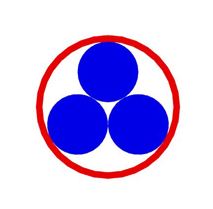

DaveC wrote:As far as tactical buckshot for the 20-gauge goes, I'm aware of No. 3 buckshot. Are there other buckshot sizes for the all-yellow shell?
#3B (.25" nominal diameter) is the popular buckshot size for the 20ga, but you'll also find #4B (.24") and #2B (.27") loads from mainstream ammo manufacturers. The issue with going larger than #2B is a geometric one.
3-circle nested.JPG (14.94 KiB) Viewed 3944 times
The minimum diameter of a circle that will enclose 3 identical smaller, non-overlapping circles (arranged in a close-fitting triangle as shown above) can be found by multiplying the diameter of the smaller circles by a factor of about 2.1547. To enclose 4 in a square, the factor is approximately 2.4142, and for 5 circles, it's about 2.7013 (in exact form, these quantities would be expressed as functions involving either square roots of integers or trig functions, both of which are messy to represent using plain text). For two circles, the factor is obviously 2, and for six in a hexagon, the factor is 3 because you can fit a seventh pellet in the middle (but things start getting more complicated there because you can't stagger the central pellet in subsequent tiers like you can the pellets in the outer ring).
Anyway, ignoring the possible complication of a cup-style wad, a tier of three #2B pellets requires a minimum bore diameter of .582", comfortably less than the .615" bore diameter of a 20ga. But the same arrangement with #1B (.3") would need a bore of at least .646", so a #1B load for a 20ga would have to stack the pellets two to a tier, which wastes a lot of space and encourages pellet deformation. 0B (.32") and larger sizes are even worse; you can't even fit two of those pellets side-by-side inside a .615" cylinder, so they would need to be stacked in a goofy zig-zag arrangement. Packing efficiency aside, it doesn't take a genius to guess what will happen to those pellets when they're suddenly and violently accelerated to supersonic velocities. Remember what happens to single-file stacks of buckshot in a .410 shell?
I have heard mention of #1B and larger 20ga buckshot loads from small specialty or custom ammo makers, but even if they use some special wads or buffering to avoid severe pellet deformation (which they may well not), there's no getting around the fundamental pellet count/pellet size limitations of the 20ga bore diameter. Even #2B isn't very space-efficient in a 20ga; Federal's 20ga #2 load is a 3" magnum shell with only 18 pellets, while their 2.75" #3B and #4B loads contain 20 and 24 pellets, respectively. That's a considerable drop in pellet count to gain just two hundredths of an inch in diameter.
