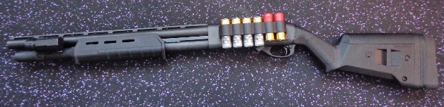

Finally got my Magpul Furniture and Mesa Side saddle. So here is a pic of my 870 as of now. Next up will be a new barrel and a different sight system. Unsure of what kind of sight yet but I will cross that road when I get there. :D

LOL That is actually the stock express barrel that came with mine. Just chopped to 18.25" and reinstalled the bead. Yeah I think she looks pretty nice. Just sucks that I got rid of my choke option. :( Oh well... she shoots true and is a blast... excuse the pun.

Otherwise if yours is vent ribbed you can cut it down yourself. It is a very easy modification and was the first one I learned to do to a shotgun. The key is to make sure that you measure your barrel from your bolt face to get the true measurement and always cut it square. I use a 10" Dewalt compound miter saw with a metal cutting blade to insure that I get a true square cut. Then I quadruple check it afterwards and file as necessary. Use a small round file to get rid of any flash inside of the barrel that may have occurred during the cut and then choose how you want to finish the end of the barrel (blue, paint, or just leave raw and pay mind to the metal) When cutting a vent ribbed barrel you also need to pay attention to the posts in the rib. If you want 18" and you don't have a post at that mark then you need to move up a little bit. NEVER go below 18" unless you have the proper "go ahead".
