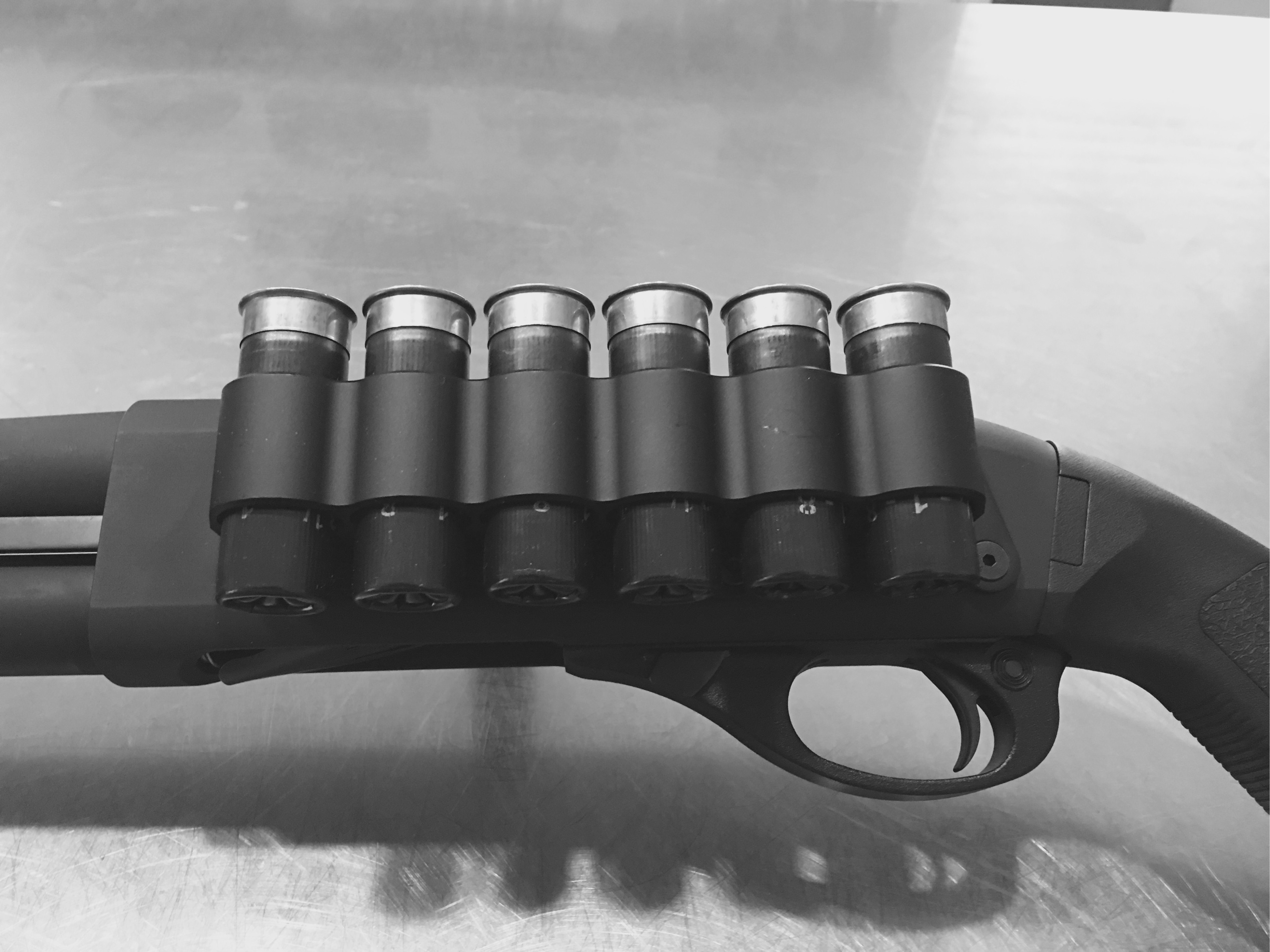

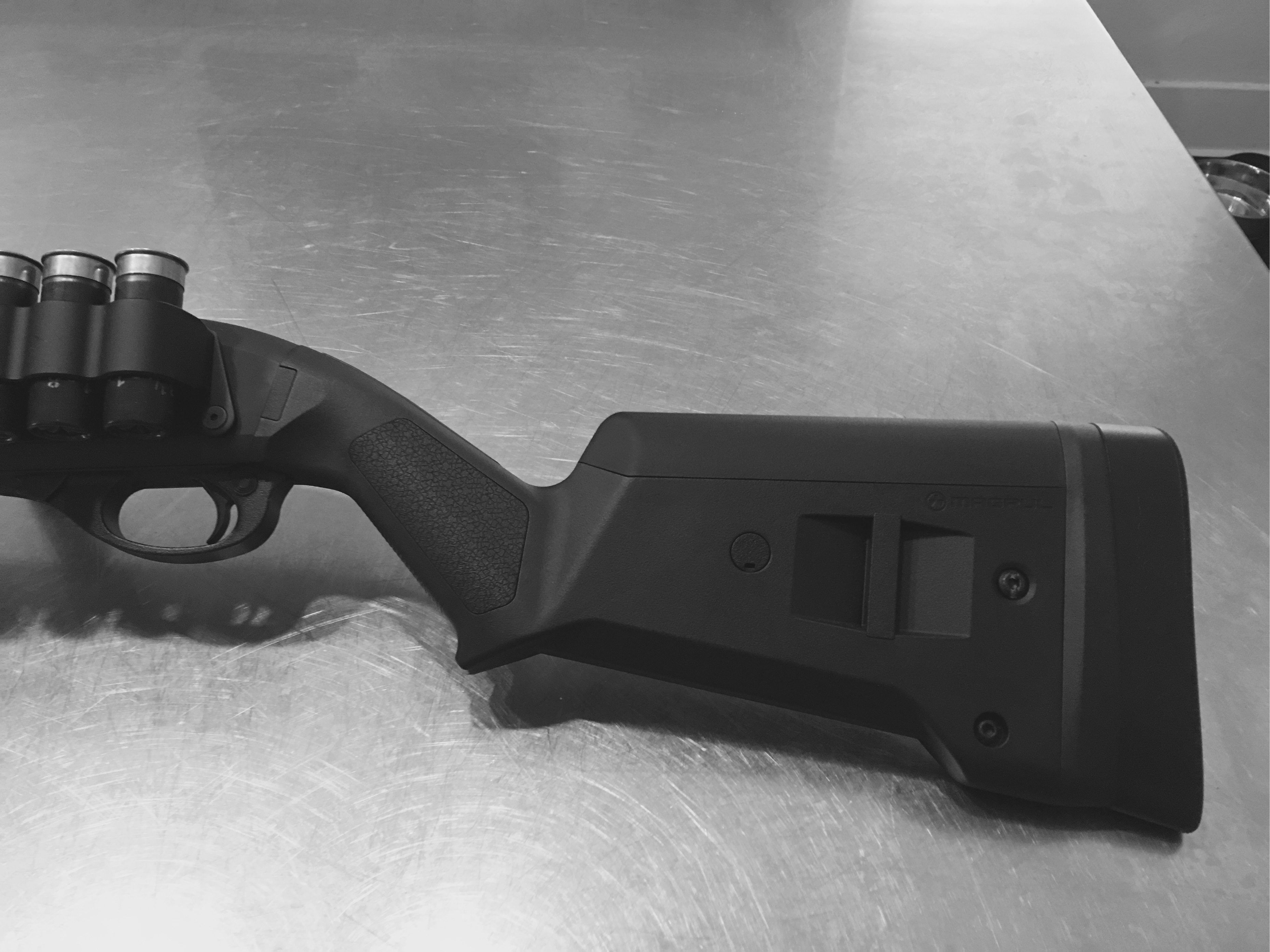

Rem 870 Police Magnum
Rem 18 inch bead sight barrel, improved
Rem 2 shot extension
Magpul SGA stock
Rem supercell butt pad
Surefire DSF Forend/Light
Mesa Tac 6 shot side saddle
Magpul SGA stock
- image.jpeg (1.61 MiB) Viewed 24274 times

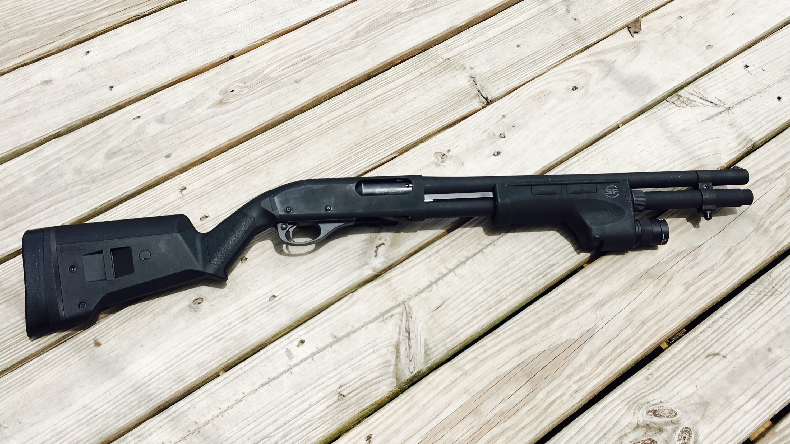

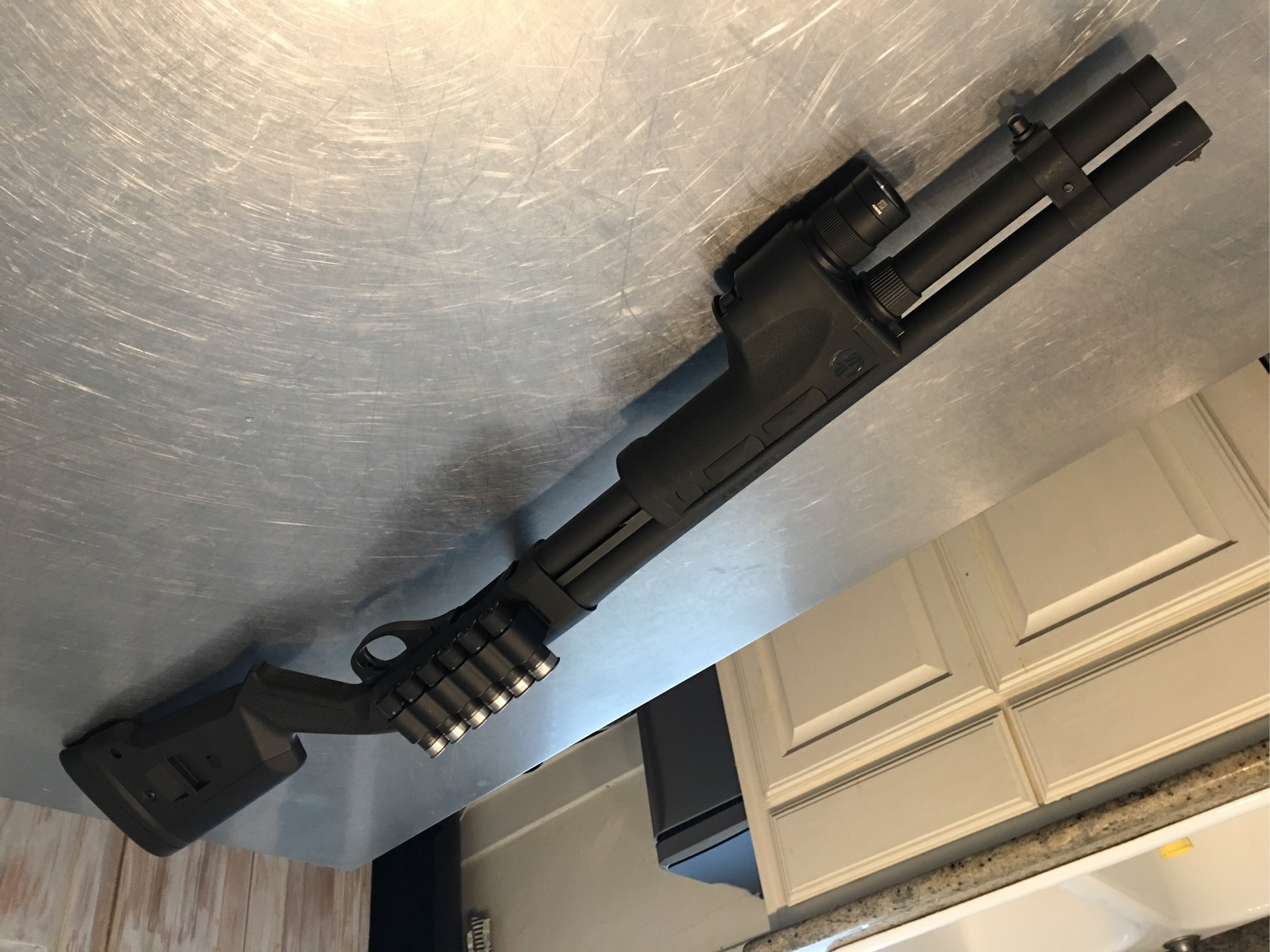

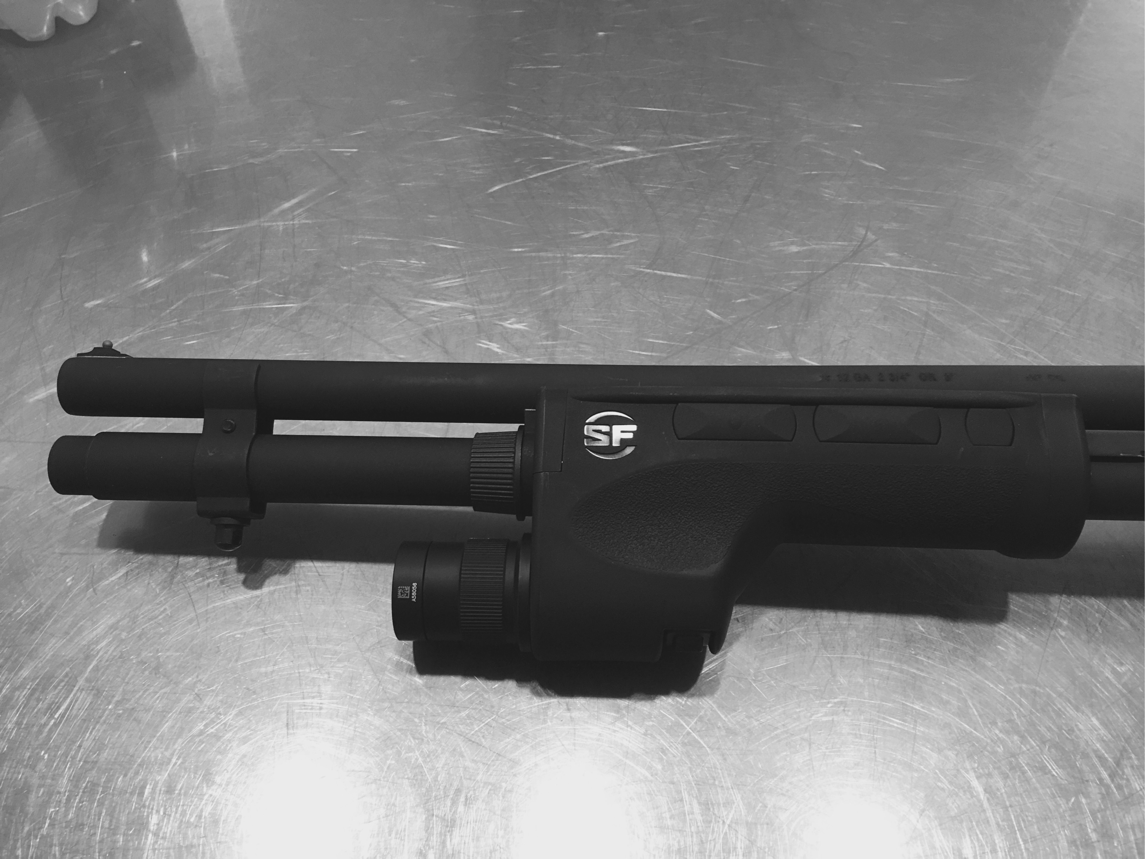

Red Beans 504
- New Shotgunner
- Posts: 5
- Joined: Thu Mar 31, 2016 5:49 pm
Details
- image.jpeg (1.24 MiB) Viewed 24274 times
- image.jpeg (1.11 MiB) Viewed 24274 times
- image.jpeg (1010.41 KiB) Viewed 24274 times

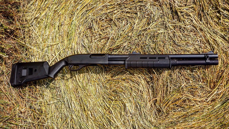

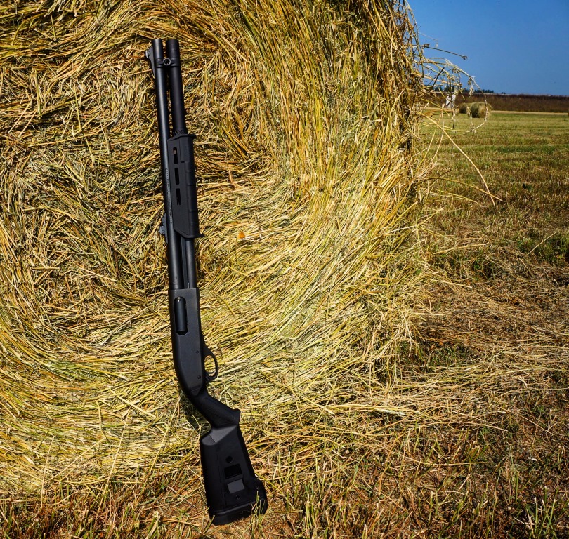

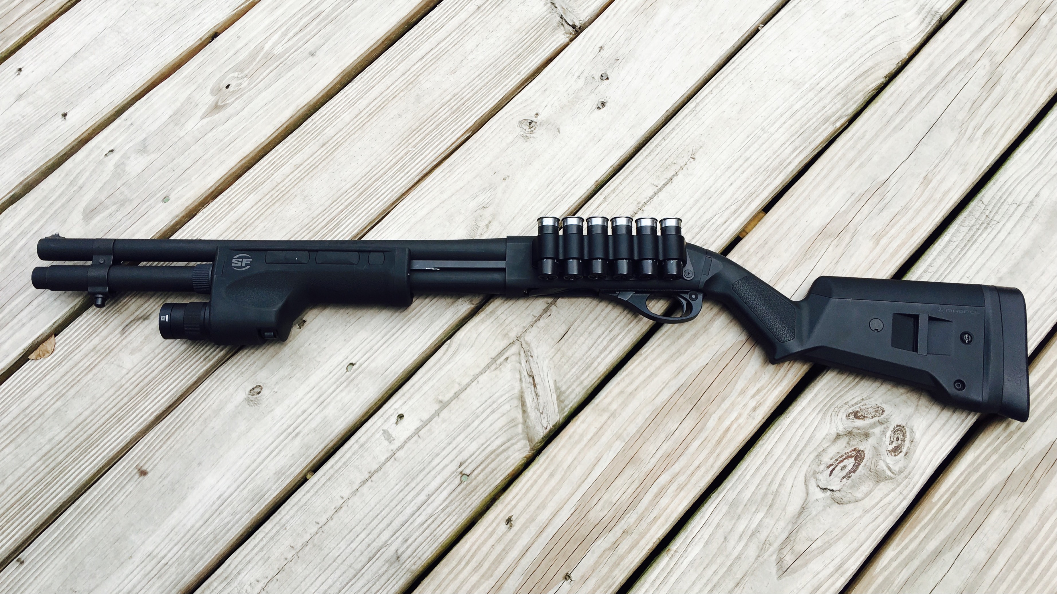

Here is my Rem 870 Deer gun (1994) in Magpul furniture (buttstock, forend and swivel). Magazine extension by Nordic components. Also installed non-MIM extractor and Nordic comp follower
- IMG_595200.jpg (439.05 KiB) Viewed 24187 times
- 15836756.jpg (262.31 KiB) Viewed 24187 times
My humble submission:
Remington 870 Wingmaster (1980's Police trade-in given to me as a gift years ago). Wasn't in the best shape - I removed the beat up wood furniture, added the +2 extension and sent it off to Wilson Combat for their Remington Steal package. It turned out better than I expected... they added the ghost ring sights, factory synthetic furniture, new magazine spring and high vis follower, oversized safety, and refinished the entire gun with their armor-tuff finish.
Couldn't be happier with the result!
