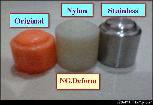

I finely got around to making a couple of followers like yours.

Looks like it could be a good follower, though I'd rather have it be made out of polymer rather than metal.

Synchronizor wrote: Looks like it could be a good follower, though I'd rather have it be made out of polymer rather than metal.
super lene ( Nylon 6, Nylon 6/6 )
Re: Best aftermarket follower - S&J?

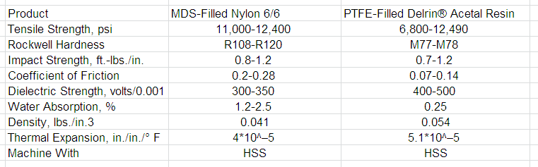

Nylon would be a pretty good material, though I'd personally prefer an acetal homopolymer instead. Acetal has very similar mechanical properties to Nylon 6/6, but it has a lower friction coefficient and isn't sensitive to water or humidity.
Click for source
Click for source
MDS Nylon 66 vs PTFE Delrin.PNG (17.7 KiB) Viewed 9422 times

Nylon was deform after used 2 month.
