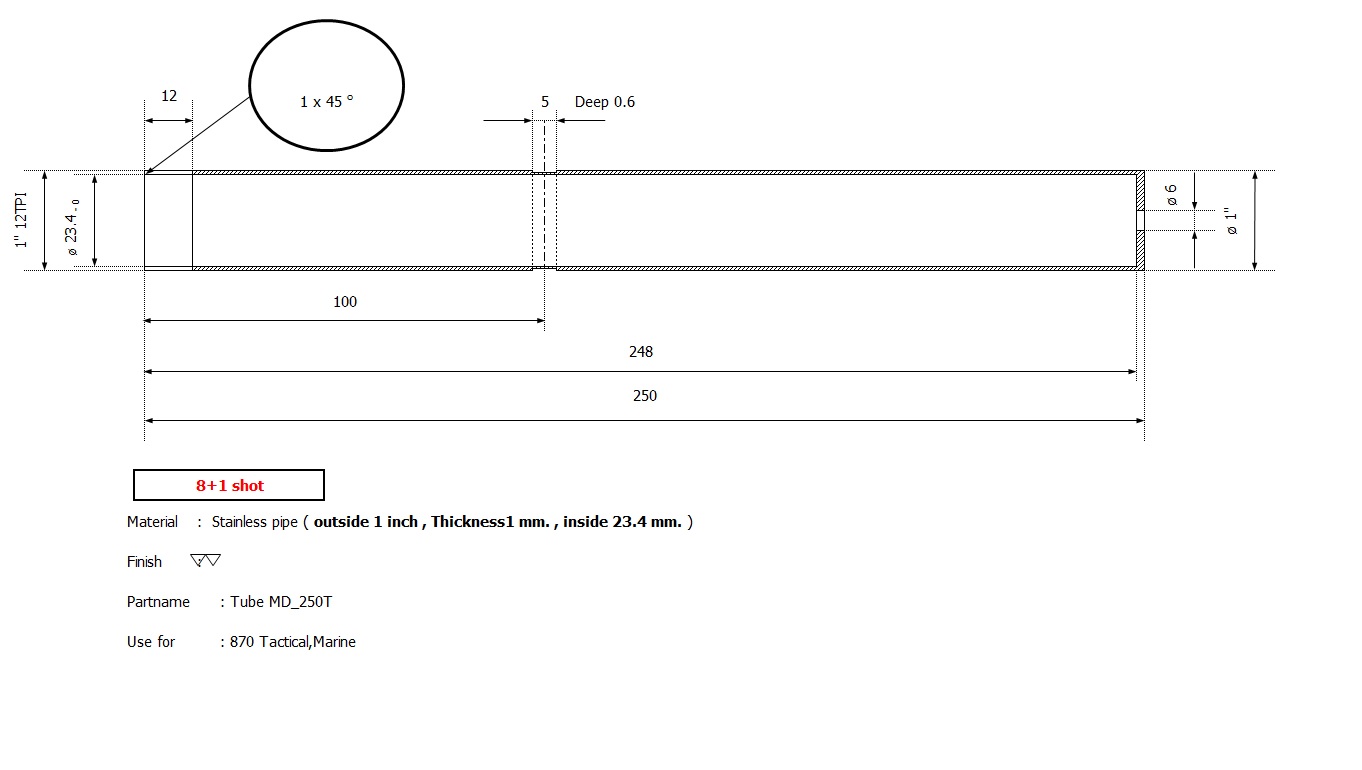

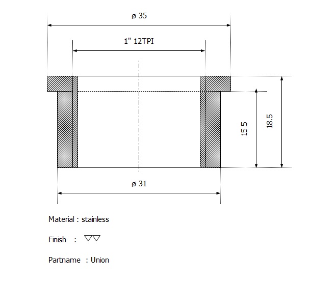

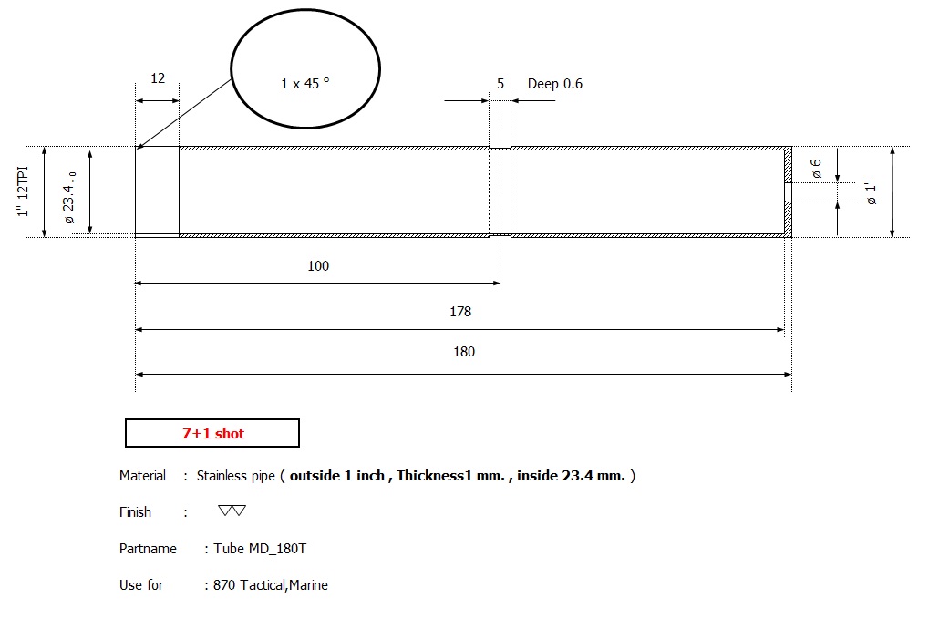

Marine 7+1
Tactical 6+1,7+1,8+1
Nat_usp
Posts: 17
Joined: Tue Oct 01, 2013 2:03 am
Re: Looking for Input for a +2 Magazine Extensions Review
Post by Nat_usp »
Drawing
870 tactical.Marine magazine tube 7+1.jpg (74.59 KiB) Viewed 8235 times
870 magazine tube 8+1.jpg (83.74 KiB) Viewed 8235 times
