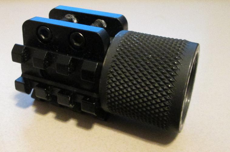

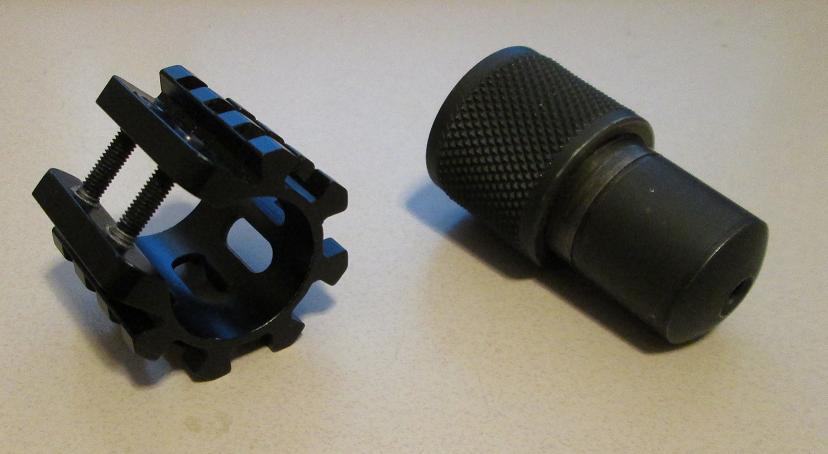

Yeah, you do need a magazine extension or an extended magazine tube with a 1" outer diameter to mount one of those. I suppose you could clamp it to a heavy-wall barrel with a 1" outer diameter, but I'm guessing that's not what you're running on your 870.
If you want to keep things simple with a standard 870 & fore-end, you can install one of these 5-position rail units on a single-piece +1 magazine extension. The result is essentially a pic-rail magazine cap.
